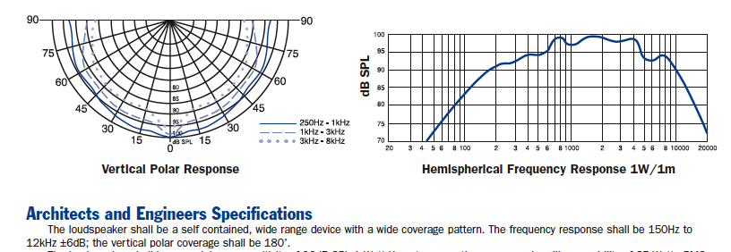

Dispersion is usually specified with -6 dB points, note that the -6 dB point of the Soundsphere Model 110B from 3 kHz to 8 Khz is perhaps 7 degrees, while the Architects and Engineers Specifications states the vertical polar coverage shall be 180°.
They didn’t lie completely, the vertical polar coverage is around 180° at 250 Hz, of course a conventional speaker has nearly that dispersion that low too.

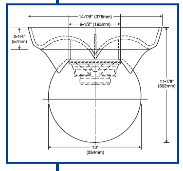

The B&O / Sausalito “lens” basically is a fancy looking version of a similar reflector, which offers very wide horizontal dispersion, but extremely narrow vertical dispersion.
The coverage pattern goes from roughly spherical at low frequencies to a disc shape at high frequencies.
As David Moulton wrote: “The full reasoning regarding why such performance is desirable is well beyond the scope of this paper. “
It is also beyond the scope of my imagination why such performance would be desirable .
As Earl Geddes wrote, “This whole concept was ill-conceived and fell flat in the marketplace. I first saw it at Dave's studio way back before it was even a patent. It didn't interest me then and still doesn't now. We always say "time will tell!" - it did. “

The Soundsphere fails as a speaker but survives as a business venture using PT Barnum’s “a sucker is born every minute” approach since 1976, they are selling to a new generation of suckers now .The Soundsphere looks like something Pedro from Napoleon Dynamite would want. Thats why it failed
The Soundsphere suffers from the same problem that the B&O / Sausalito lens has, wide horizontal dispersion, but extremely narrow vertical dispersion.
Of course, David Moulton seems to think that problem is a virtue .
One man’s meat is another man’s poison .
