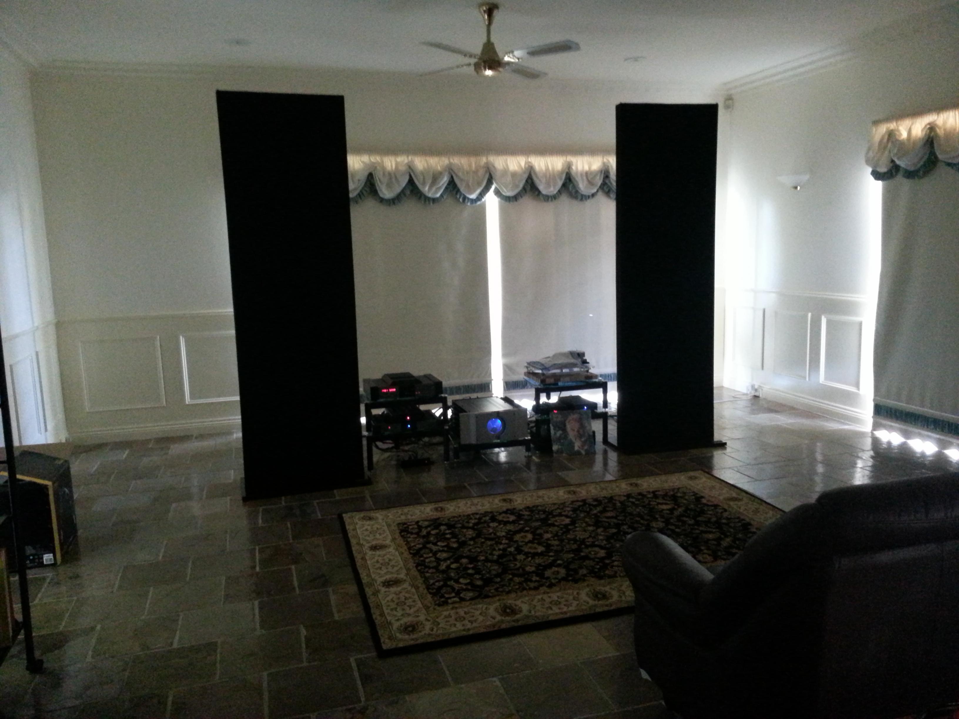

I need some help in regards to the room placement of the speakers. My room is 6 meters x 7.5 meters. I tried a few different placement suggested by number of websites without a complete satisfaction. (They sounded better in my old house - smaller room in L shape)

...I need some help in regards to the room placement of the speakers. My room is 6 meters x 7.5 meters. I tried a few different placement suggested by number of websites without a complete satisfaction. (They sounded better in my old house - smaller room in L shape)

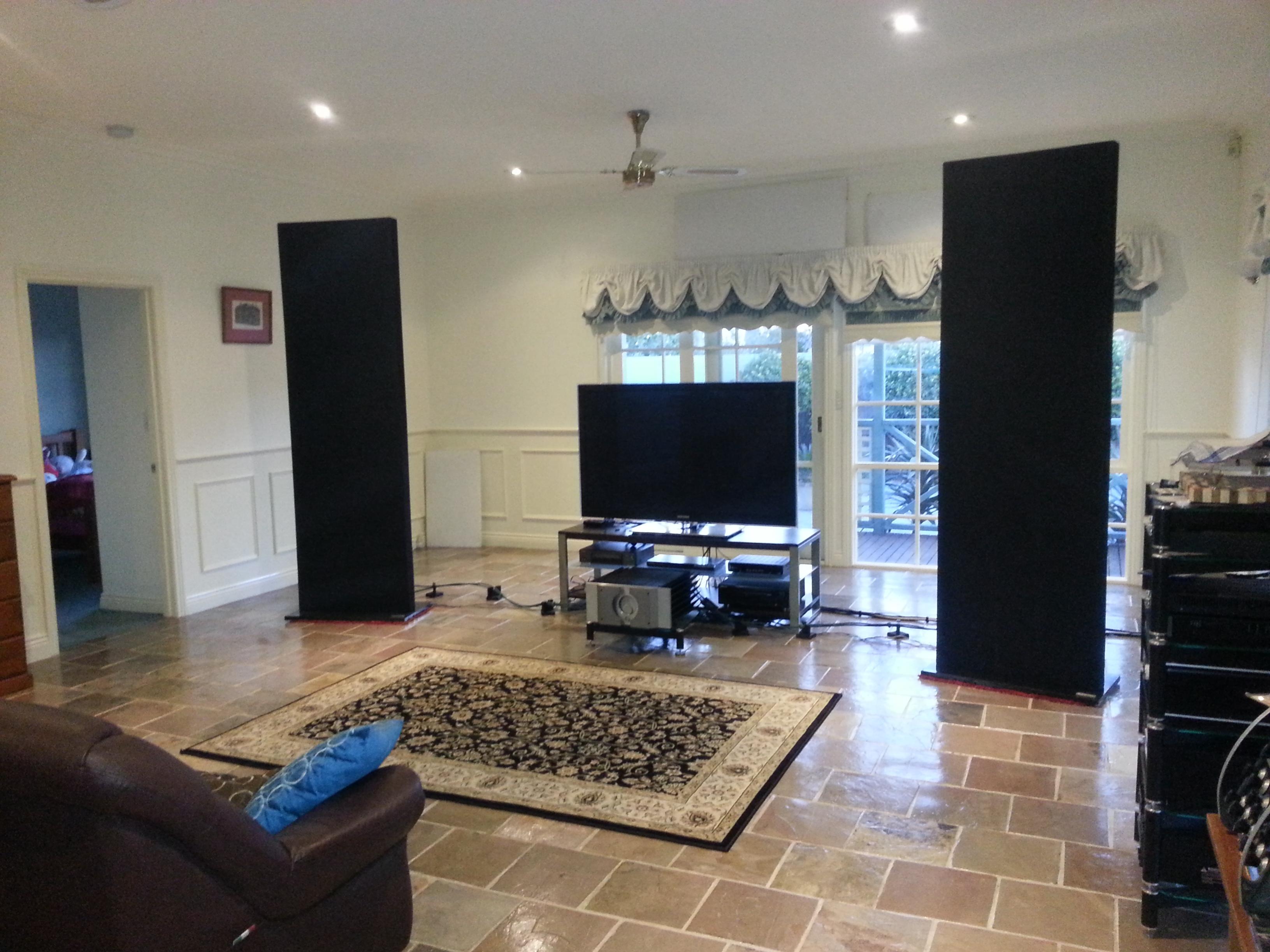

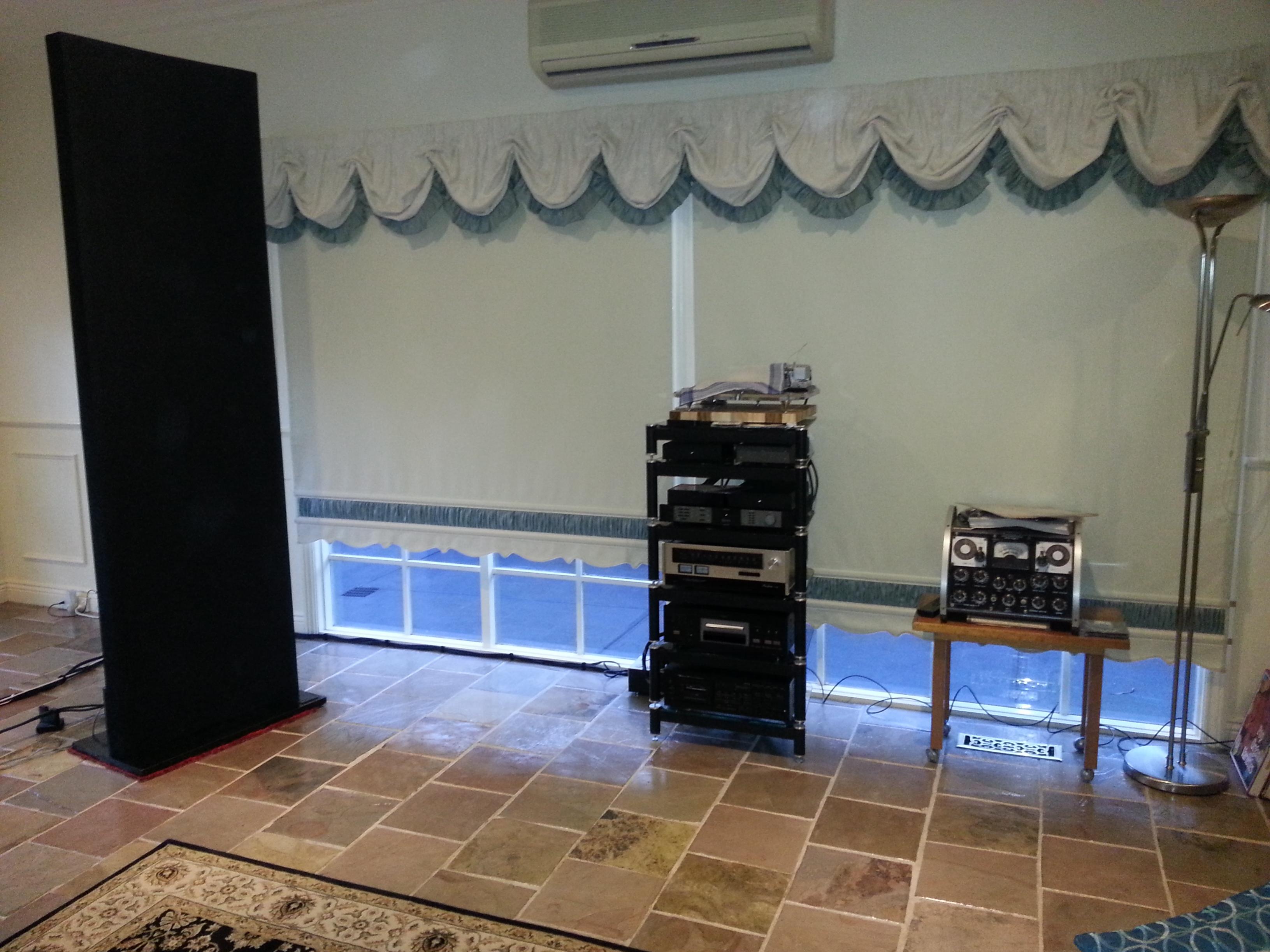

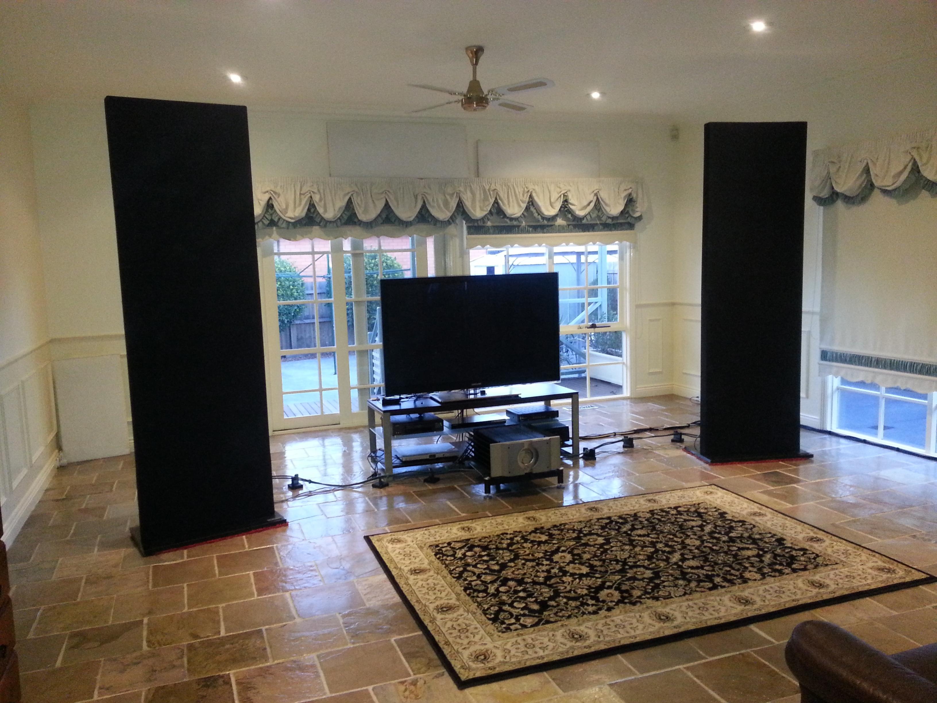

You didn't say what you didn't like about the sound in your current room, so it's a little hard to make specific recommendations. But looking at your photos, I might expect that the bare floors and large expanse of glass behind the speakers could be causing a lot of hard reflections. Generally, the speakers should be placed to form a (more or less) equilateral triangle with the listening position as the third point. The speakers should be aimed (more or less) at the listening position. You might want to try reducing the distance between the speakers and the rear wall.
In my experience, hifi systems always sound less satisfying when moved to a different room. Neither before or after was perfect, and each has its own set of peculiarities. So that 'reference sound' that you became accustomed to in the old room was considered 'right', and now the new room sounds 'wrong'. This is not to say that some optimization of current set-up might not be possible. It's just that it may take some time to grow accustomed to the new room.

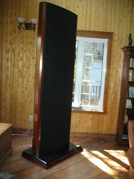

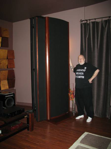

Hi audioboat just to let you know that the difference between the model 6 and the Spectra 66 is in the three dimensional image the model 6 as a bigger sound and the Spectra 66 as a better image but both are very good speakers my friend Jocelyn as rebuilt and owned many Acoustats here are a few, 1+1s - 6s - Spectra 66s - Spectra 88s DIY - AND a few other pairs.

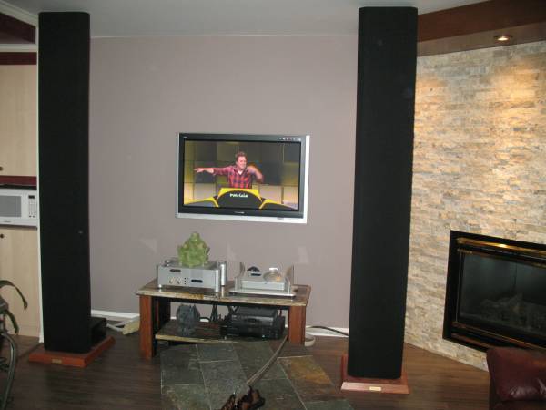

My old listening room is L shape and much smaller (3.8Meters x 5meters) than the current setup. The speakers offered more bass than the new room. (in the current listening position) If I walk around the room, I can hear more bass near the back. It seems that the bass has been cancelled off right in the middle of the room where chair is. I tried to move the speakers or the chair without much luck.
I have not started the room treatment as yet. (I didn't do any room treatment at my old house either)
Any suggestions?
Any suggestions?

audioboat toe the speakers in more and move the speakers back some, it will take some experimentation , but you will find a sweet spot.
You also have your TV right on the same plane as your speakers, keep the TV back from the speakers and maybe put a wool blanket over when listening as an experiment.
When you having them sounding good, you can play around with toe in a little more. paying attention to imaging + wideness of the soundstage.
Being that your last room was much smaller, your speakers loaded the room more than the bigger room. But Placement can make a big difference.
Good luck.

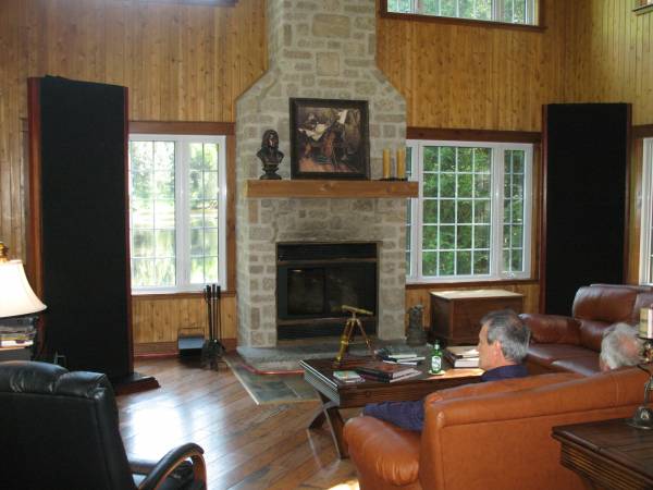

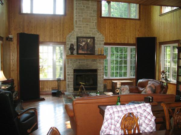

Audioboat, I'm using 2+2's in a 33ft wide by 90ft long room with ceiling 12'3", the speakers are 15ft off the rear wall and approx 18' between them, I sit 70' from them. I have never heard these acoustats sound better, I was never really fond of them till I got them in this room, and the wow factor set in. The volume knob is lower and the output is greater and fullest sound, ex knob at 12 now at 9, they use the room to expand
Delta Star, with a room like that not taking anything away from you're 2+2s because i know what they can do when they have ROOM to breathe I would be looking for a pair of Spectra 66 or 6600s and maybe if you have DIY experience why not build yourself 8800s you have the room for any of those and dollar for dollar you will be laughing all the way to the bank .

If only I had a room that size, I would be in heaven, what a challenge with all my builds. I would have a field day, what a challenge, it would be heaven.Audioboat, I'm using 2+2's in a 33ft wide by 90ft long room with ceiling 12'3", the speakers are 15ft off the rear wall and approx 18' between them, I sit 70' from them. I have never heard these acoustats sound better, I was never really fond of them till I got them in this room, and the wow factor set in. The volume knob is lower and the output is greater and fullest sound, ex knob at 12 now at 9, they use the room to expand
Yes JAMESBOS , with a room like that i would have these in the room same as my friend Jocelyn Acoustat DIY Spectra 8800s all steel frame 800 pounds of pure joy ( once in place )
Is that a Model 6 pushed up against a 2+2 (Model 10? 5+5?) in that one photo? Holy cow!
