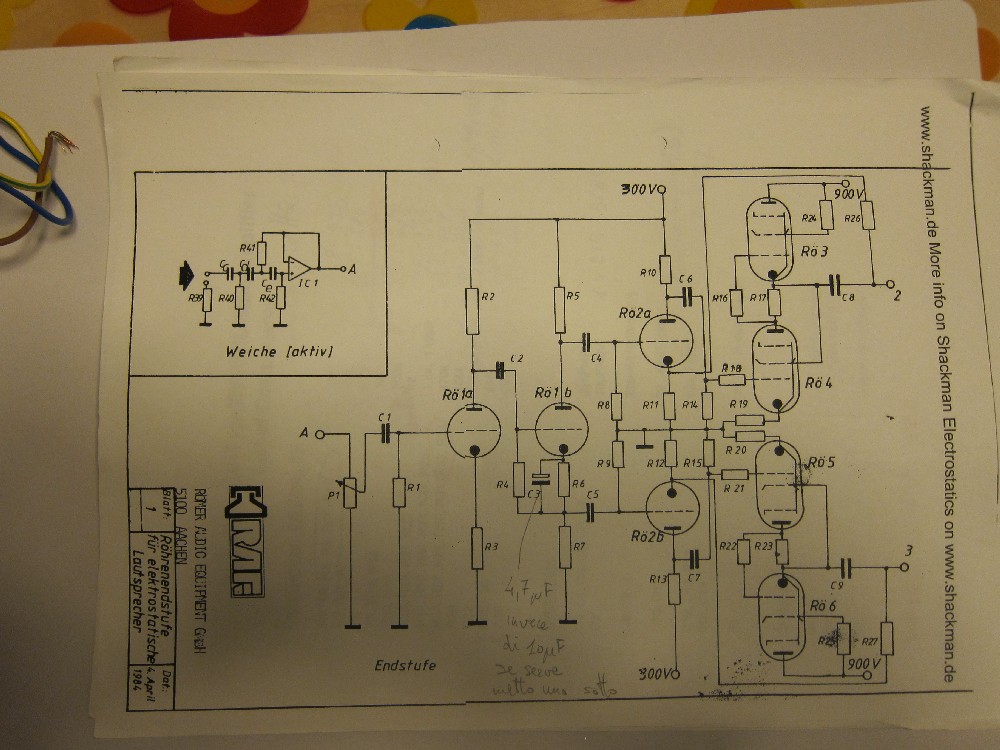

This is one of the few "Acoustat Servo Amps are worst than Step Up Transformer Interface" opinions I have heard. I now feel better that I did not spring $1500 for a pair of good condition servo amps!!
I did buy a Shackman Tube amp specifically designed for ESLs, with stacked EL84s, (for quite a bit less $$ than the Servo amps) that I will eventually finish and decide for myself which (tube vs interface) is better on my three Acoustat 9" panels and ML CLS panels...but the Shackman is only good for 300hz and up, while original Acoustat Servo Amp is full range - not exactly a fair comparison....
All I can say is don't obsess over "tubes". A competent engineer can create an excellent amplifier with any technology. Similarly, an incompetent engineer (and believe me, there are plenty of those around) can make a mess out of any technology. Simply because something has "tubes" in it, doesn't make it good, much less great. I think a lot of the issues with semiconductors v. tubes came up a long time ago when people didn't understand the ramifications of certain design topologies. Early transistor amps were designed with the philosophy that high open-loop gain with loads of feedback was a good thing. Easy to do with solid state amps, but a rotten idea. With tube amps, that was never an issue because they have inherently lower gain and require (and can't tolerate) a lot of distortion-reducing feedback. From that point onward, this became a cultural norm and "tribal knowledge" among those who really didn't understand the underlying principles. And it persists to this day.
BTW, the EL84 is only a 500V tube. When you say "stacked", you'd have to stack a LOT of them in order to achieve 5KV p-p direct drive like the two 6HB5s did. And the reliability of that..... you don't even want to think about it. OTOH, if they're only driving a transformer with those, you'd be just as well off with a good solid state amp.
The bias if I remember correctly, is around 1800v, not 5kv on the shackman. They are four tubes per channel, with them PP and stacked, B+ is 900V. When you run them at 300hz and higher, the high bias is not needed.
They're not really "stacked". If you re-draw it, that's basically the same topology as the SC amps, only at 900VDC instead of 5KVDC. So you'll give up a few dB of SPL. Even so, at swings to the rails, the tubes will have more plate voltage than they're rated for. As long as they're biased into class AB2, they'll probably be okay, but there's no getting around the fact that they are specified at a lower plate voltage.
