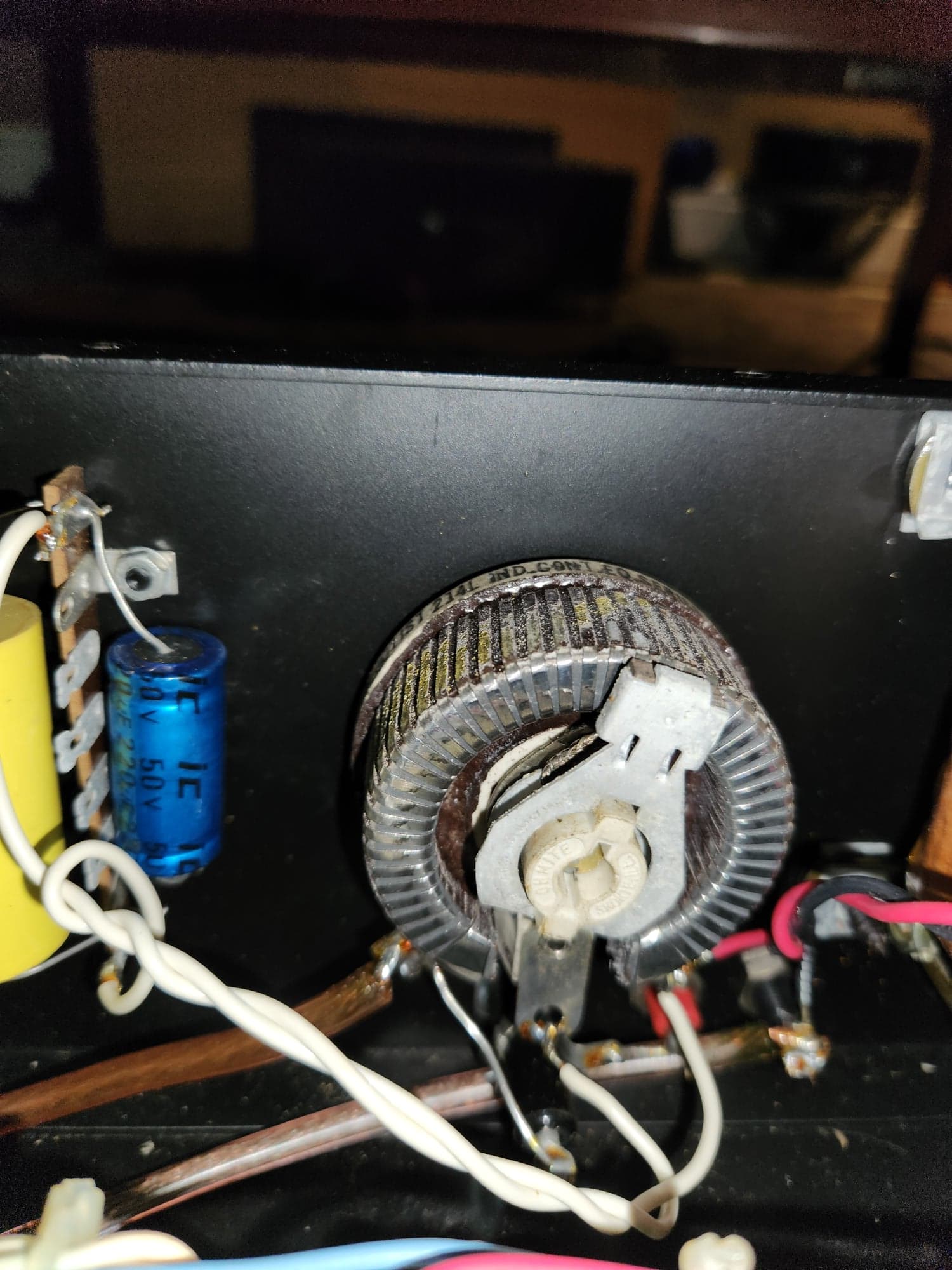

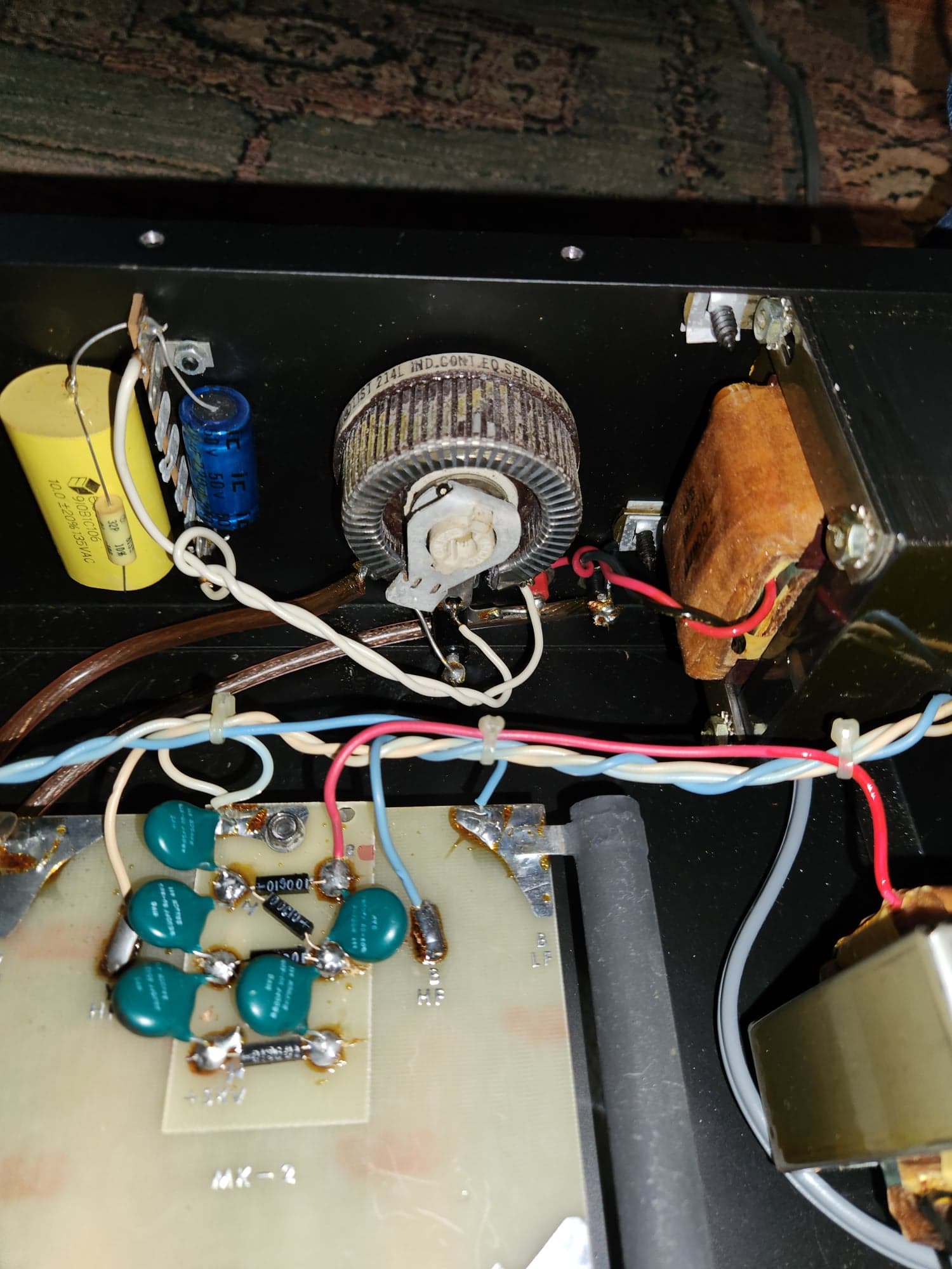

Greetings, I picked up a pair of Model 3's recently and am happy with them . I opened the interfaces (MK-121-2) up to see if the c mod had been done, I still don't know! What I noticed was that even the though the serial numbers were withing half a dozen of each other, their builds were not identical . the differences lie with th the boards with the caps and diodes, The caps are different but same value , the diodes were 25G10 on one interface and 100G10 on the other. The 100G10 one also had the caps and diodes installed on a sister board that matches the original board. Whether or not they left the factory like this I can't tell. I am not savvy enough to know if this is acceptable or not They sound fine both are very close in volume. I am still sorting out their placement.
So advice would be appreciated if this is ok to ru,n with or should I keep the extinguisher close by ! see pics Thanks in advance Dan

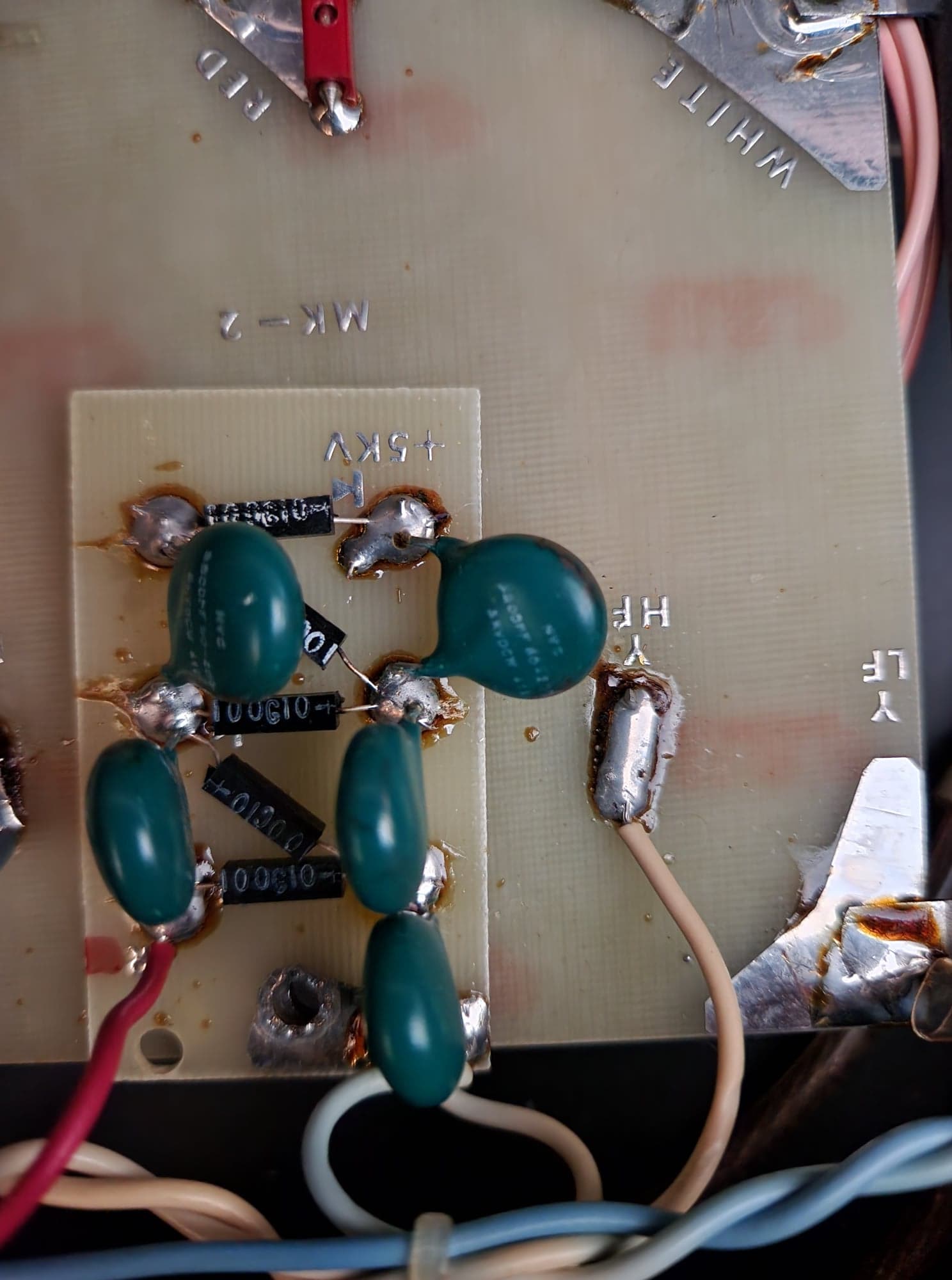

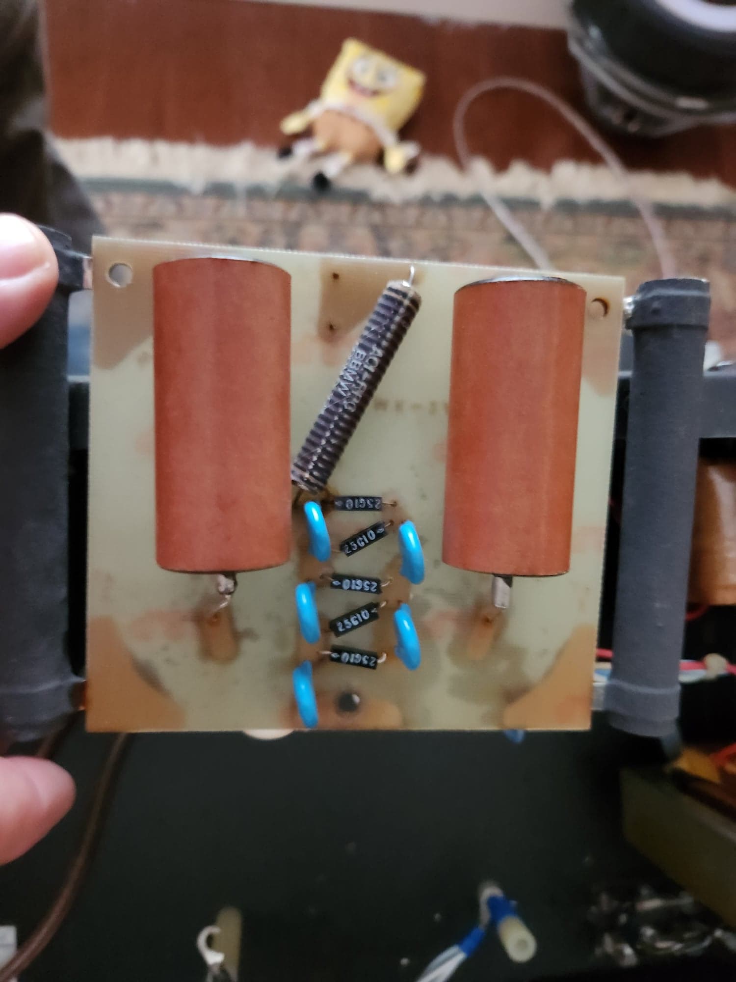

Hey Folks, 'Im looking to change the Bias Ladder on a pair of model 3's with the MK-121-2 interface. All schematics steer me to a 25G10 diode. Only problem no matter where I search 25G10 doesn't show up and might be discontinued, I don't know their values . My previous post (above) shows what I have .
Does anyone know the correct diode I should use for this application? Thanks so much.
You definitely have two different vintage interfaces. The one with the small PC board holding the bias multiplier is an older version, where the original design had only a 3-stage multiplier, and a higher voltage transformer. These were troublesome, and were upgraded to a 5-stage multiplier and a lower voltage transformer. So it's a good thing you have this upgrade (which was probably done at time of manufacture). If the speakers are playing properly, and at matched volume levels, your bias supply is probably okay. However, these components do age, and replacing them is not a bad idea, especially for older interfaces like yours.
The 25G10 diodes are no longer available. Here's suggestions for suitable replacements for both diodes and capacitors.

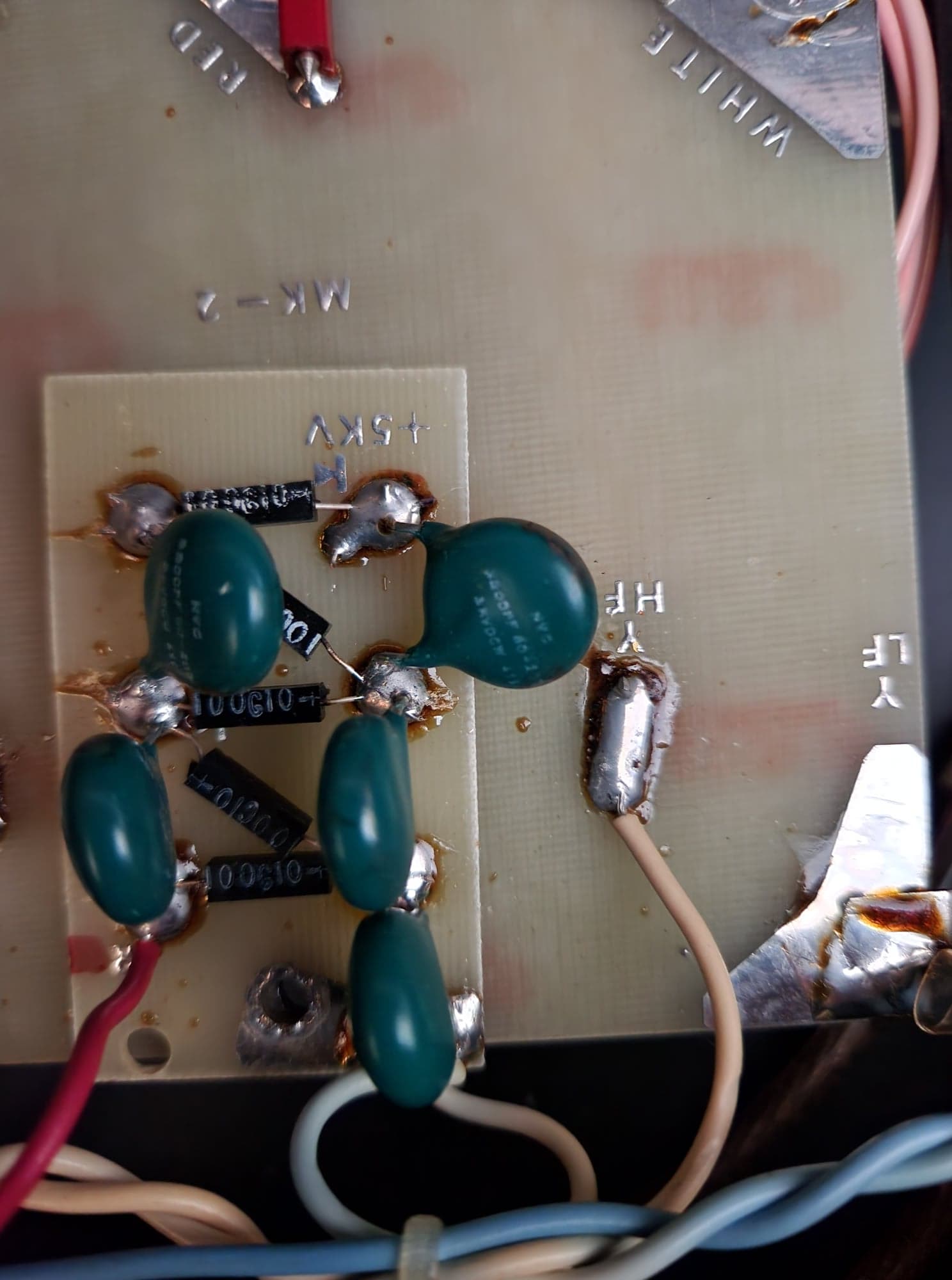

To determine if you have the C-Mod, or not, I would need to see a close up photo of the area around the high frequency balance control, and its associated components.
Thanks so much Andy ! I spent a couple hours spinning wheels trying to get the info you just passed on. The interfaces are 6 apart in serial numbers but I just want everything to be identical . I added pics of the HF balance control area in regards to the C-mod which has not been done.You definitely have two different vintage interfaces. The one with the small PC board holding the bias multiplier is an older version, where the original design had only a 3-stage multiplier, and a higher voltage transformer. These were troublesome, and were upgraded to a 5-stage multiplier and a lower voltage transformer. So it's a good thing you have this upgrade (which was probably done at time of manufacture). If the speakers are playing properly, and at matched volume levels, your bias supply is probably okay. However, these components do age, and replacing them is not a bad idea, especially for older interfaces like yours.

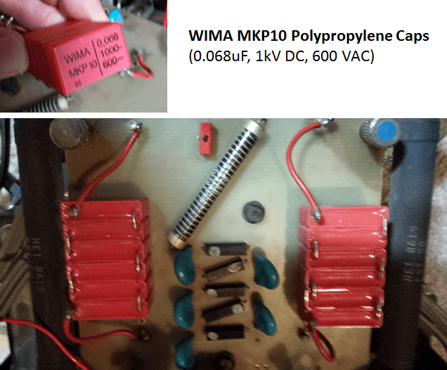

Those .01-uF, 6kV capacitors will be very hard to find. Unless you can find ones with a polypropylene dielectric (used by Acoustat in later production), anything you find will likely be of a lesser audio quality. Also beware of capacitors that will be too large to fit the space available. In this case, if they're not broken, I would leave them alone.
pm sent. I may have what you're looking for.Thanks again Andy, I will do the C mod along with the diodes and caps. Some of the components are temporarily Unobtainium. Those diodes had to come from Germany on Ebay. That .01uf 6Kv cap will be an adventure...cheers
Either Disco-Pete might help you or User Bolserst idea. I did this and so far everything is alright. See attached pic and Post 1579.Thanks again Andy, I will do the C mod along with the diodes and caps. Some of the components are temporarily Unobtainium. Those diodes had to come from Germany on Ebay. That .01uf 6Kv cap will be an adventure...cheers
|Thanks Folks, just what I was looking to do if a single cap couldn't be found. Looks perty yoo!Either Disco-Pete might help you or User Bolserst idea. I did this and so far everything is alright. See attached pic and Post 1579.
Pm me your info.|Thanks Folks, just what I was looking to do if a single cap couldn't be found. Looks perty yoo!
As AcoustatAnswerMan said, if they work, leave them alone. They are probably Polypropylene, I have been told by an expert, and which type do not decay.|Thanks Folks, just what I was looking to do if a single cap couldn't be found. Looks perty yoo!
