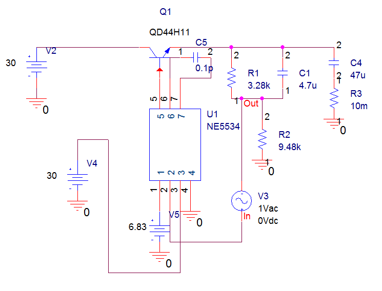

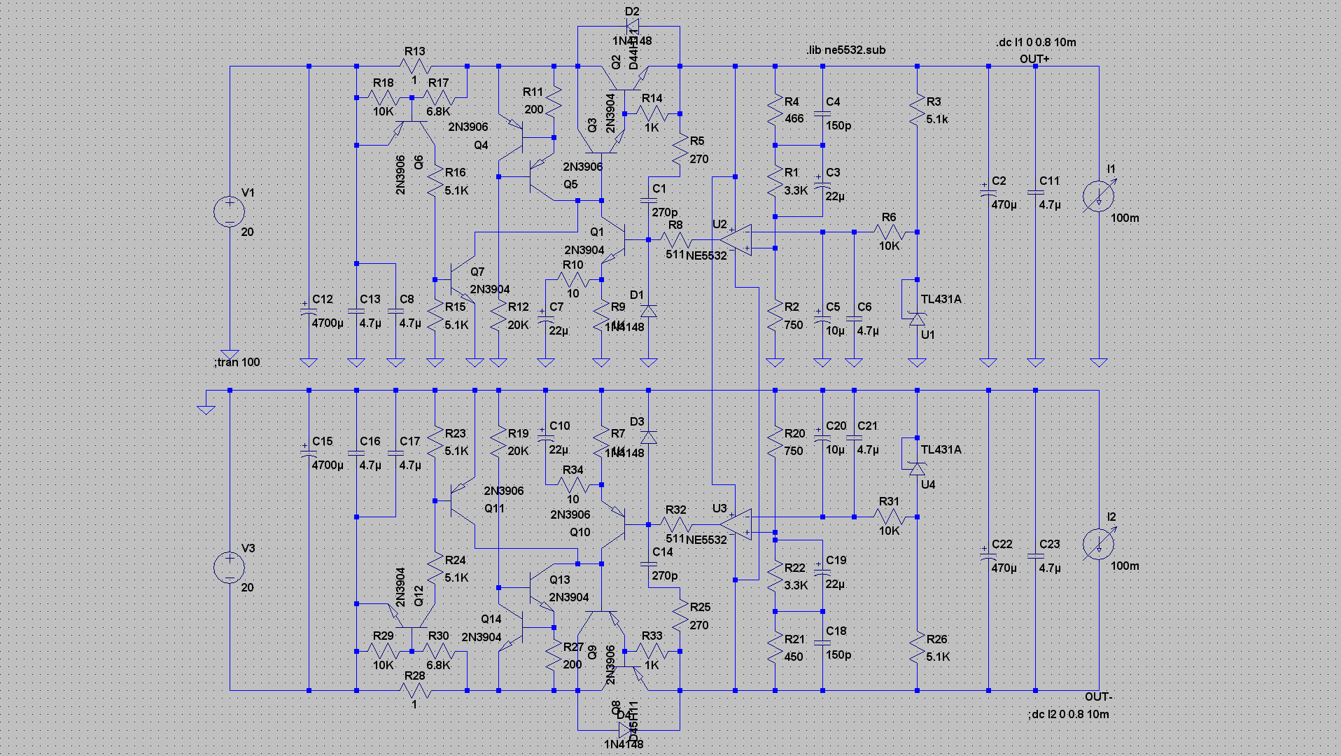

So I started my try to perform this AC analysis for stability.
(1) I assume that the load has to be a constant current source, not a single resistor.
(2) Is it mandatory to include esr et for all caps of the regulator, or just for the output one?
EDIT: Also, what are the results of phase I have to expect that ensure stability?

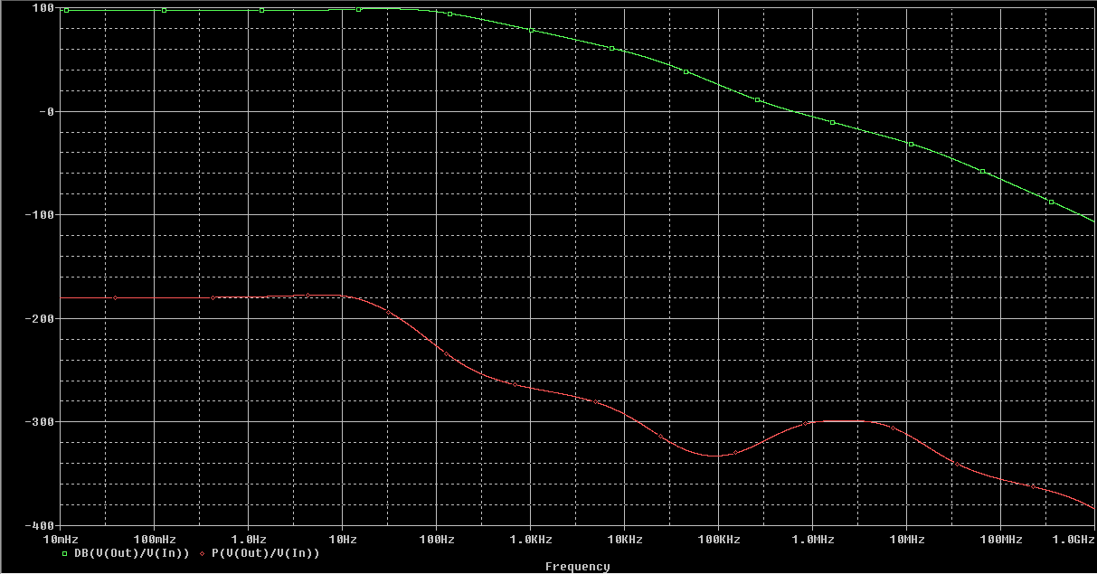

So, some first results. But I don't know if they are of any use at all.
Schematic in Pspice:
I didn't know what to do with the compensation pins of the NE5534 (I leave them unconnected in reality), so I added a 0.1pF parasitic capacitance between them. I don't know if this value is reasonable at all.
To begin with, I only used DC voltages for all nodes that are DC at theory - raw DC supply at the collector of Q1, power supply for the opamp and the reference zener (LM329) is replaced by a 6.83V DC source.
I attached no load at the output. Will do it later.
When suggesting a 10m esr for the 47uF output capacitor, results are the following (P() is the phase plot):
For 1R of output cap esr (have read this as specification for Kemet tantalums ), results are the following:
Sadly, I can't comment on the results with my experience. Do they seem rational at all?

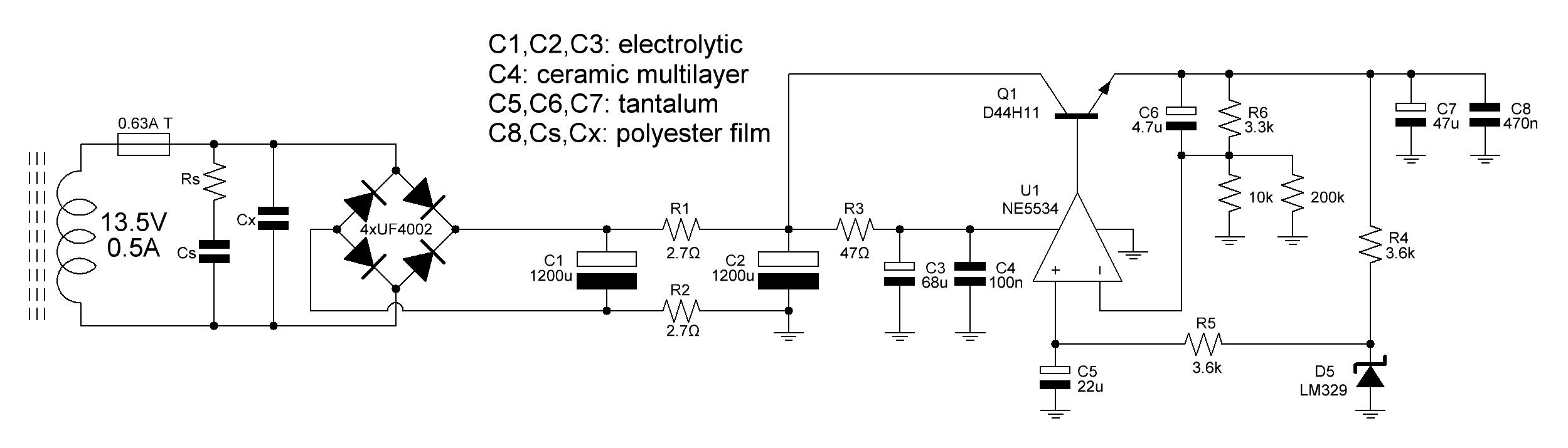

Today, I did a short-circuit test for my Sulzer circuit.
The output voltage was tested as 9.20V both for no load and 150mA DC load.
Then, I performed an artificial output short circuit. Luckily, nothing smelt, got hot or vapourised before the fuse blew! A 0.63T one.
So, afterwards, I replaced the fuse and powered it up again see whether it could go on. The result was a bit weird: I now got 9.42V DC output no load voltage, which fell to 9.10V for a full, 150mA DC load.
I checked the LM329 during no load, and its voltage was correctly 6.83V, as it was initial. But the voltage seen at the + input of the NE5534 was 6.96V (after the RC filter)! The voltage at the inverting input was 6.96V too, indicating that the opamp did its job.
But at full load, voltage at + input went down to 6.78V.

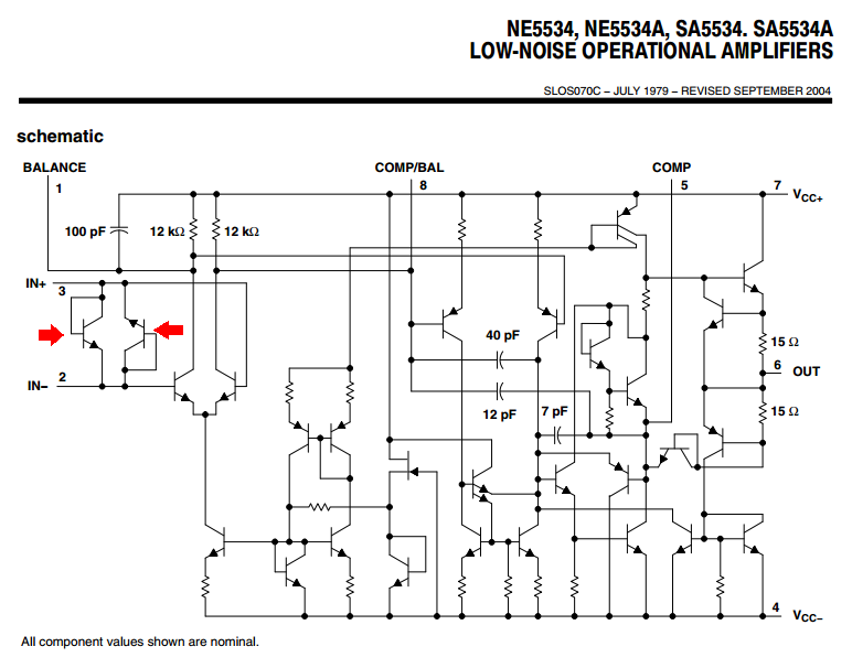

From this, I seem to understand that NE5534 got damaged, and was sourcing and drawing current at its + input during no load and full load respectively. So I went on and replaced it with an LF351N. The result was stable 9.20V DC output for both no load and full load.
So it seems the opamp gets damaged! What is a way of preventing this from happening? Maybe a series resistor with the opamp's output?
What could be the cause of this damage?
EDIT: I attach the schematic of the tested circuit for convenience.

When the output got shorted to ground, capacitor C6 immediately yanked the opamp's VIN- pin to ground. Meanwhile, capacitor C5 kept the opamp's VIN+ pin at ~6.8 volts. The right hand red diode in the attached schematic, thus had 6.8 volts of forward bias. Since it's an exponential device, it conducted Infinity amperes with VBE = +6.8V, and it blew up.
What's a fix? You could consider installing back-to-back diodes across the 5534's input pins, IF you pick diodes whose forward voltage is significantly smaller than the red diodes inside the 5534. What rhymes with Bottkie? (these diodes) might be a good choice: 0.53V forward voltage, 10uA leakage, 16pF capacitance.
Or you could switch to a JFET-input opamp; they can tolerate enormous delta-V across their VIN+ and VIN- terminals. Burr Brown / TI has lots of them in their OPA series. Analog Devices has quite a few as well.

I have found some decent diodes to use, in my opinion. 1N4151, SD101C or BAT81S seem to be cheap and good enough for the purpose.
So I was thinking that maybe only one diode in needed for the opamp to survive the output short-circuit test, connecting its anode to the + input and the cathode to the - input. Since as you mentioned, a large differential voltage of more than 7V should appear at the input terminals, but should have its positive end on the + input. Not trying to save costs here actually, rather than space - I have already made a tight layout, and I am a bit lazy of rearranging everything all together.
Considering that the original circuit used no diodes, it should be an improvement anyway. I will try and see how it goes.

Referring to post 192, does C3 value affect at all stability of the regulator?
If making it bigger doesn't harm, then it would be beneficial to make it bigger, to provide more filtering of the incoming voltage, improving the opamp's PSRR at high frequencies. Maybe this could also ensure that more voltage headroom is present, since R3 could perhaps get smaller too.
Another concern could be that the value of C3 could be critical, as not to form a tuned LC filter with C4. But in my implementation, C4 is attached directly to the pins of the opamp, rather than in parallel with C3.

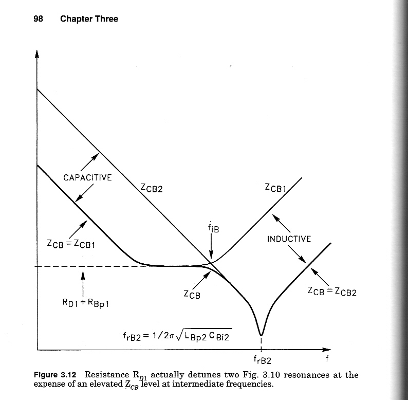

Jerald Graeme's book recommends C3 > (50/(pi*GBW)) where GBW is the Gain Bandwidth Product of the opamp: 10MHz for the NE5534. Plugging in the numbers, C3 > 1.6uF. Beyond that, you're just attenuating lower and lower frequencies, which the opamp's PSRR would have attenuated anyway.
Graeme suggests you install a series resistor between C3's bottom plate and ground. He recommends this series resistor's value should be (1.0 ohms, minus the ESR of C4). Graeme emphasizes that this 3 element network (C3, C4, series resistor) gives a broad plateau in the graph of impedance vs. frequency, and eliminates unwanted resonant interactions between C3 and C4. A figure from that book is attached below.

I am able to use up to 560uF of capacitance in my layout. Or maybe something more mediocre, say 220uF-330uF.
A 560uF, 35V Panasonic FM has a quoted impedance of 18mΩ at 100kHz. Shouldn't this be taken into account when calculating the C3-C4-resistor network? (if the 1Ω-ESR resistor is in series with C3)
