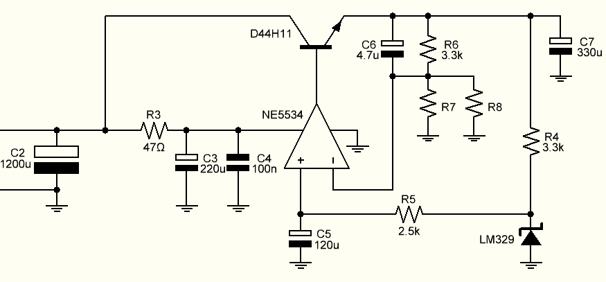

True, but here I am building a Sulzer regulator! As you might remember, this design uses a filtered version of the collector voltage into the opamp - Mike Sulzer used 47R-47uF+100nF.
I am also planning to use a 0.1uF decoupling right on the IC pins, and my RC stage should be 47R-220uF. The discussion started out as to whether a resistor should be used to damp possible resonances caused by paralleling the caps. I initially suggested using an RCRC configuration not to spoil the 220uF's rejection, the second R being 1R, and Mark suggested that second R could be made bigger. According to my reasoning and AndrewT's posts, it seems like such a second resistor should degrade performance. What is your take on that?
OK so its the opamp in the regulator. The goal is to have a supply that is very much like a (almost) perfect DC, so I don't see any advantage of supplying the opamp through a resistor, with or without cap.
I understand the concern about oscillation, but that should not be a problem unless you have very high Q caps at the output with no ESR.

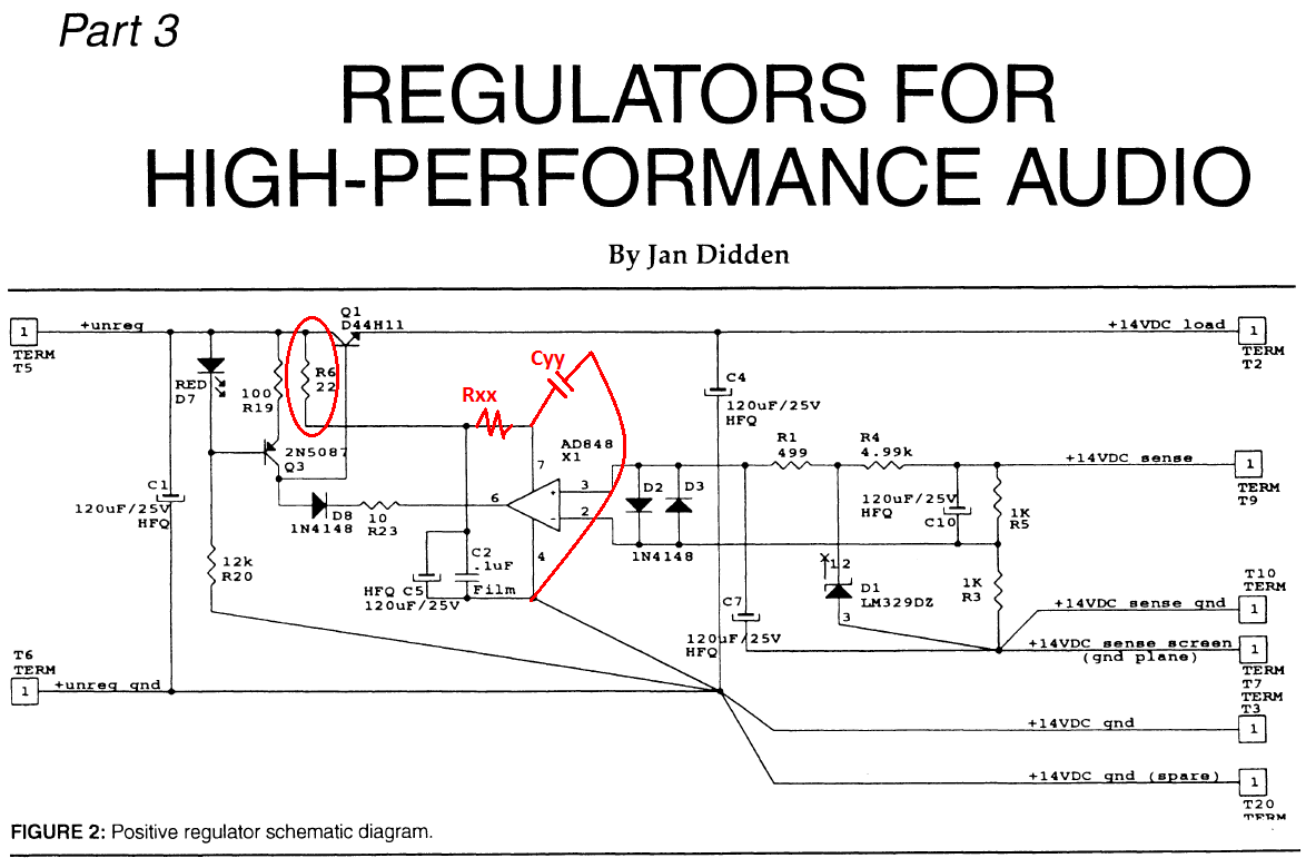

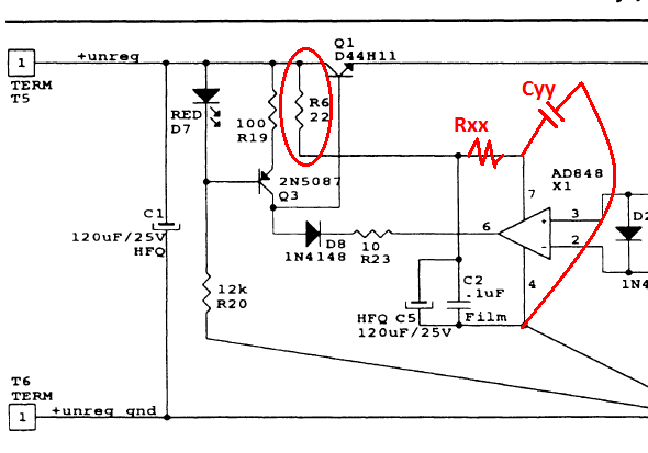

Jan, he is talking about your resistor "R6" from your 1995 article, schematic below.
He wonders whether it is a good idea to split R6 into two series components, R6 and Rxx. Then whether or not to add a new capacitor Cyy. And if the answer is yes, if doing this is an improvement, he wonders what are the optimum values of (a) the sum (R6 + Rxx); (b) the ratio (R6 / Rxx).
Ahhh! I see.
Well, in the new regulator, updated per Walts' 2000 article, that R6 is gone, together with the cap. The opamp is now supplied direcly from Vout. See the article.
Problem solved.

You could lay out the PCB including R6 and Rxx and C2 and C5 and Cyy. Then you could experiment: what happens if Rxx is a zero-ohm jumper? What happens if R6 = Rxx = 11 ohms? etc. You could even lay out the PCB so that R6 and Rxx are each laid out as a fixed resistor in parallel with a multi-turn trimmer potentiometer. Now you can populate R6 / Rxx either with a fixed resistor, or a trimmer, or a jumper, for additional fine-grained experimentation.

I want to build 12 good quality regs, better than LM317, but I don't need super regulator performance. Mainly to gain knowledge.
I have space limitations that I have set and want to follow, so a Sulzer regulator was the easiest tiny-fit I could implement. I would really like to power the opamp from the output (as you say, move one wire) but I am asking you (due to your expertise in this): Do I need to fit a start-up zener too?
The way I see it, I could just power the existing Sulzer's IC reg from the output, so I would save some filtering parts. But do I need to insert that zener too? I could go up to that and remain within my room specs, can't afford the space it takes for an additional current source etc.

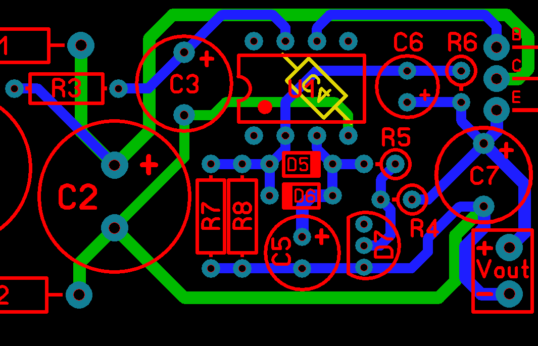

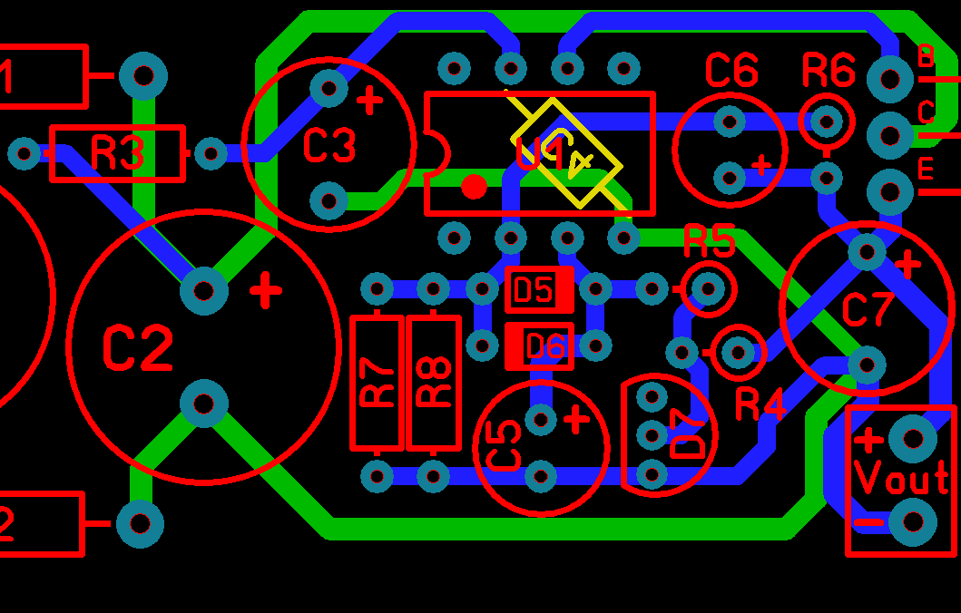

Ok. Now it's time for a delicate choice in layout for my Sulzer regulator.
I will present you two different versions of the layout I have designed. The only difference is the connection of the ground point for the opamp. I would like to hear your opinions on my final choice - I have one preference and I will explain it. The schematic used (with protection diodes omitted for clarity):
My references for the output voltage are directly on the pins of C7. This means that my common point for the circuit is taken as the negative pin of C7. Filtering capacitor C3 will be placed close to NE5534 for obvious decoupling reasons. So what remains to be done is to connect NE5534's pin 4 to a suitable reference.
I have found there are two ways, and I name them ground 1 and ground 2. From what I have understood, ground 2 version was used in 1995 Jung regulators, when filtering into the IC was still used. The different implementations follow.
Ground 1:
Ground 2:
My preference is ground 1. My choice depends on the DC stability of the common reference that is presented to the opamp, and that largely depends on the trace resistance that connects pin 4 to output ground + the current that flows through that trace:
(1) For ground 1 option, that trace is shorter and carries only the charging current of C3. This corresponds to roughly 10mΩ of trace resistance and a "ripple" current of no more than 10-15mA. So voltage modulation should be subtle.
(2) For ground 2 option though, the trace resistance is higher since the route is larger, and the voltage seen at pin 4 is modulated by the following currents: the current that the IC demands, the charging current of C3 and, most importantly, the load current. Given the fact that load current could be 60-200 times bigger than ground 1 option (since D44H11 specifies for a minimum of 60 hfe) I consider ground 2 a poor choice.
What are your thoughts on my take?

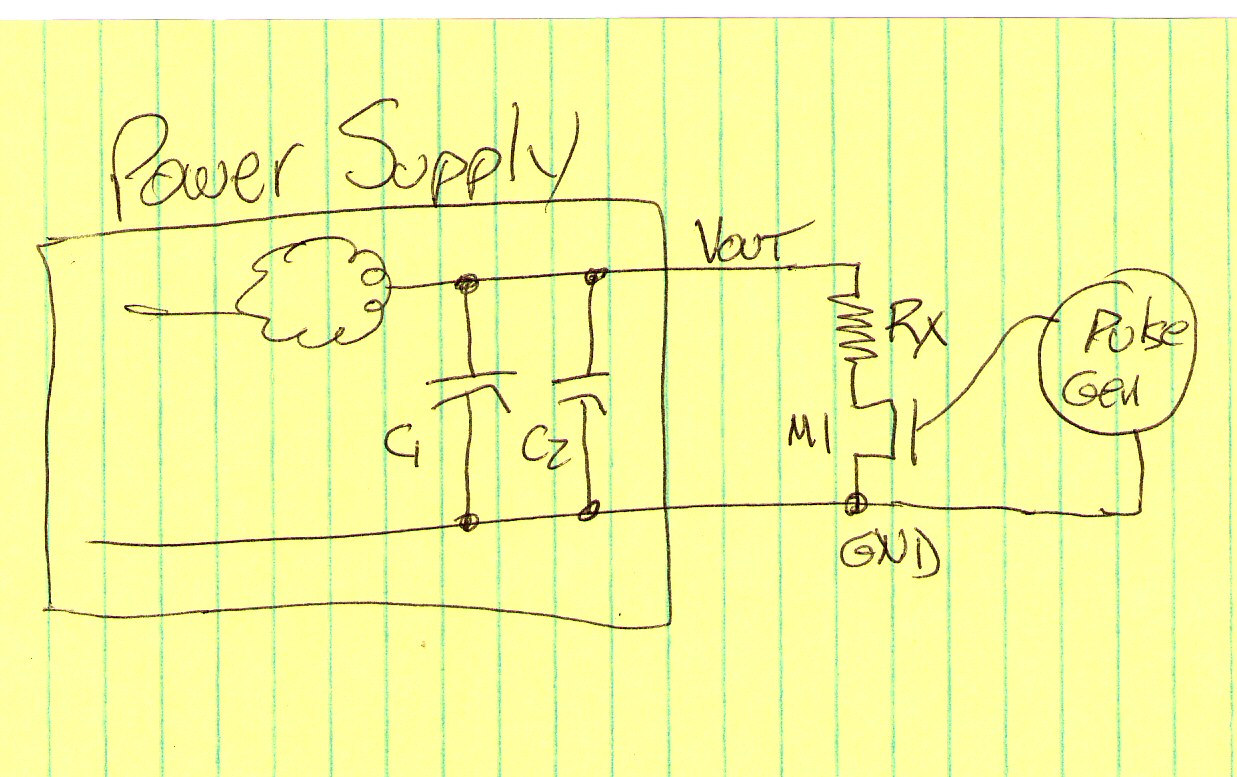

I hope you remembered to include resistor Rx in your testing circuit. The purpose of pulse testing is to create an ideal square wave current waveform. Resistor Rx determines the magnitude of this current: I = Vout/Rx. If Rx=zero then the current becomes extremely large and poorly controlled.
The goal is to find out whether the power supply's negative feedback control loop becomes unstable when loaded by an ideal square wave current waveform. Adding capacitors just for the test, distorts the current waveform, which reduces confidence in the results.
Yes, I used Rx=45 ohms. And a 1k ohm resistor parallel to M1 (across D-S).
