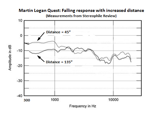

I understand, but no way to cheat the laws of physics…errr…acoustics, that I know of. I ran into this issue with my first ESL hybrid I built which had only a 3ft tall panel. Got it measuring and sounding great at 2m, moved it into the main room where listening distance was 4m and it sounded thin and anemic.I am just concerned about that wicked roll off shown on the graph at my listening distance (-6dB from 1kHz to 250hz).
I recall that years ago Stereophile had measured several of the Martin Logan products at various distances and commented on the issue. Attached is an overlay I had made of the measurements they published for the Quest which used a 45” tall panel. Martin Logan provided a response which at the time I didn’t completely understand, but reading it now I think it provided a good explanation without getting too technical. At the end they basically say that they EQ the speaker for the average listening distance range recommended in the owner’s manual. Interestingly enough, more recent reviews of Martin Logan products have not included measurements at various distances.
Oh, I suspect they don't exist anymore due to this comment
"Again, thank you for your revealing work. We look forward to being sliced, diced, and dissected by Stereophile again in the future. "

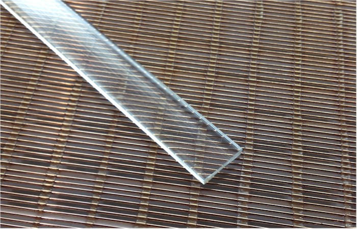

Are you talking about a thin layer of glue encapsulating the wire as shown in pic from Ken Seibert's website: KenSeibert.Com Audio Projects
If so, this is not a problem electrically or response-wise, but does reduce the available excursion by a small amount.
Yes, in some places on my build, the glue is kinda sitting on top. Not a huge amount but just worried the diaphragm will be banging into it.

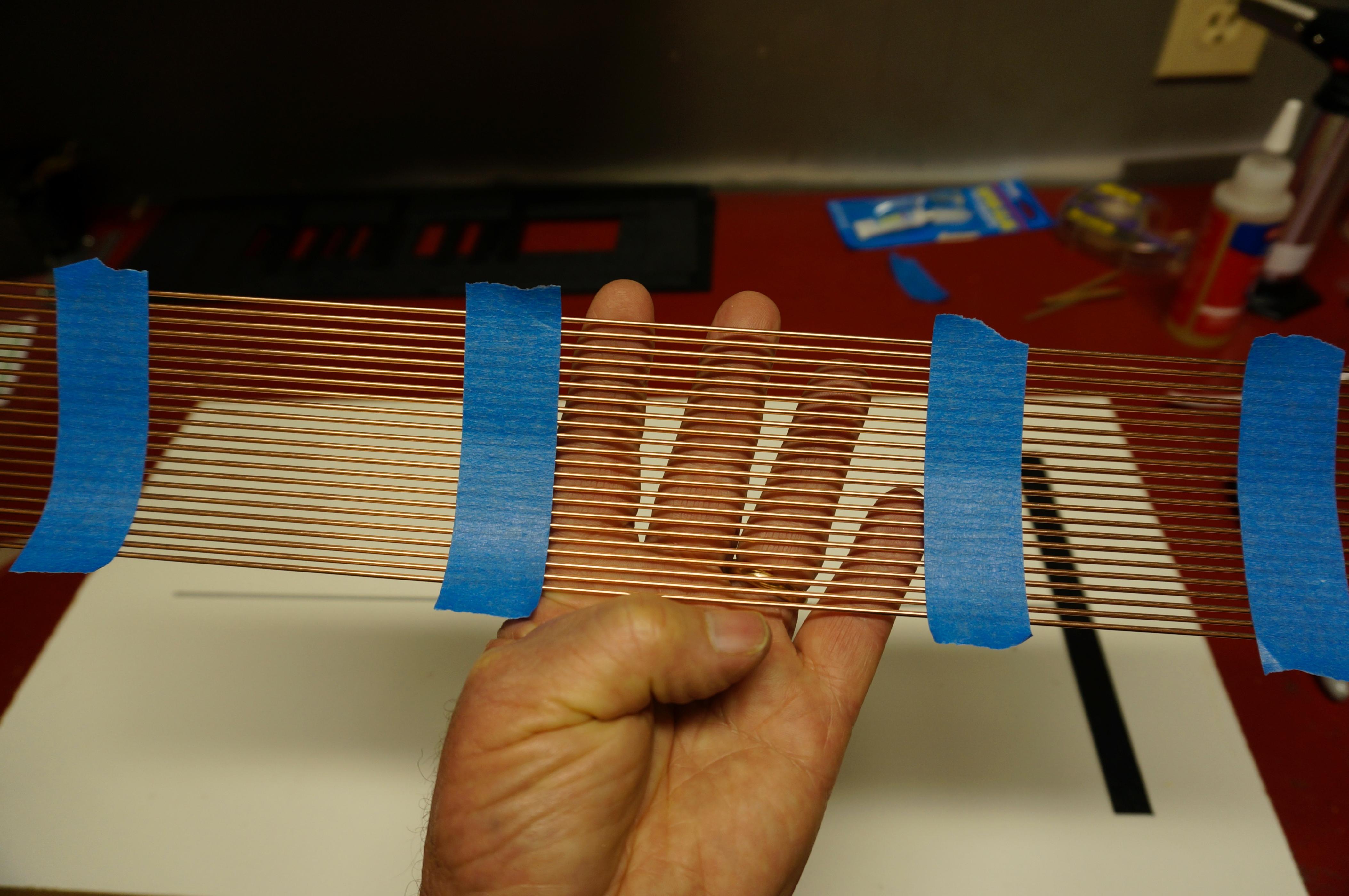

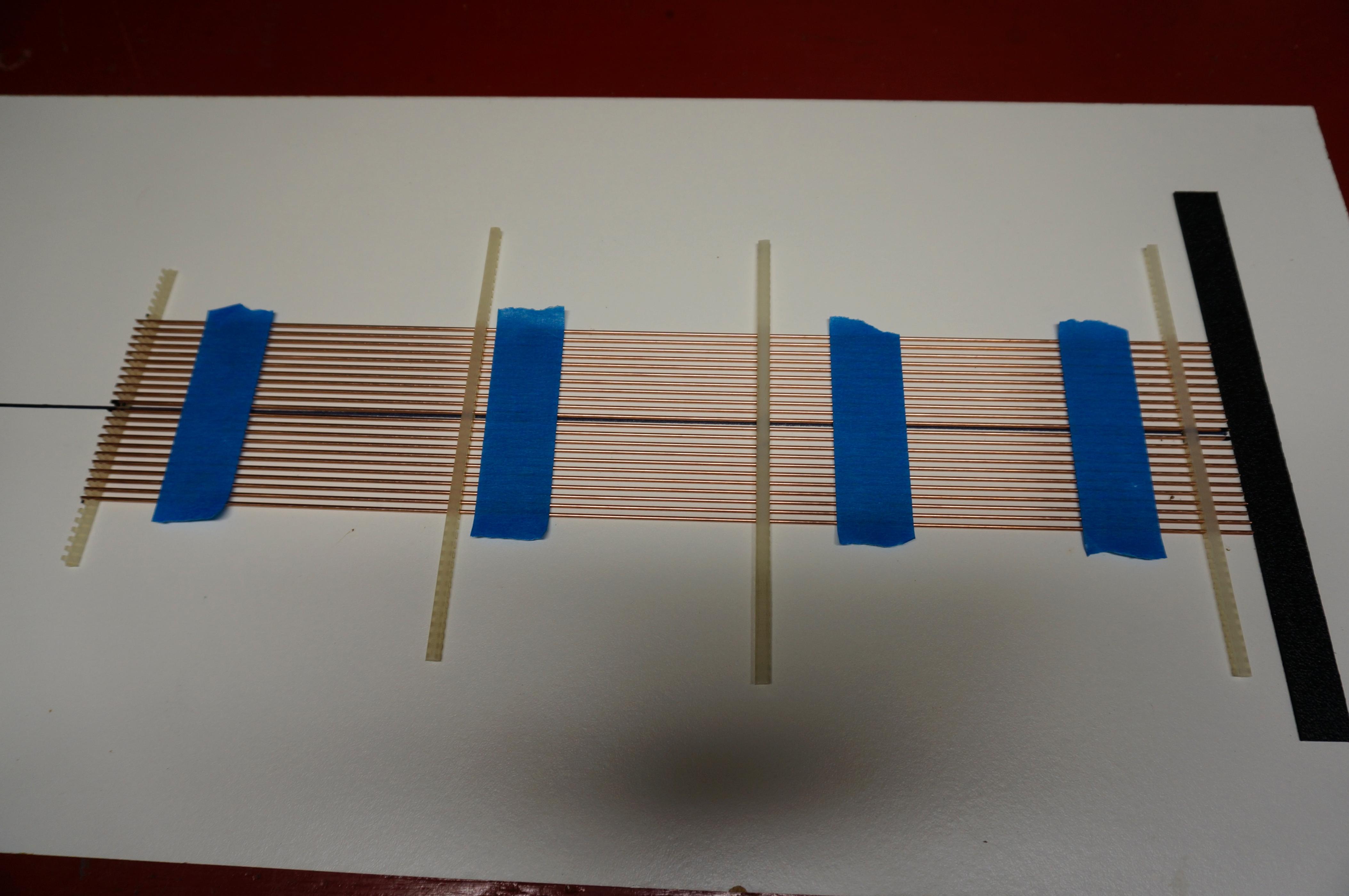

Hi Bengel,
I'm not familiar with the type of ESL you are building or the gluing process(glue on after the rods are placed, or before on the plastic panel). If putting the glue on before would be easier with less mess, you might want to consider pre making stator assemblies and glue them a section at a time. Below is a picture of a small assembly taped together with masking tape. It is just 22 rods across but you can add or decrease the amount. In your case you would substitute the nylon grommets with the bolts you have for separation. It's easier if you have a very flat and smooth board like melamine. Mask the rods about every 7 to 10 inches, making sure the tape does not touch the melamine or it won't slide. Once it's all masked, lift your bolts off and carefully lift or slide the assembly to your panel. If you are careful the masking tape actually keeps the rods very well separated. The other picture is wire assembly in my hand. Don't know whether this is at all helpful for your situation but thought just in case.

I've actually considered this approach. I thought of just clamping the threaded rods to the table and placing the wires "on top" of the rods in the threads/spacers... and build one segment at a time......though I have yet to try it.
In your case I think it is a bit easier as your wires are thicker and you have nice spacer (nice and deep for the wires to sit in).
In my case the wires are "hair like" and you have to be careful with them so they don't get bends in them.
There has to be a better way to do than I am doing it. It is taking forever to get through even 1 panel build.
