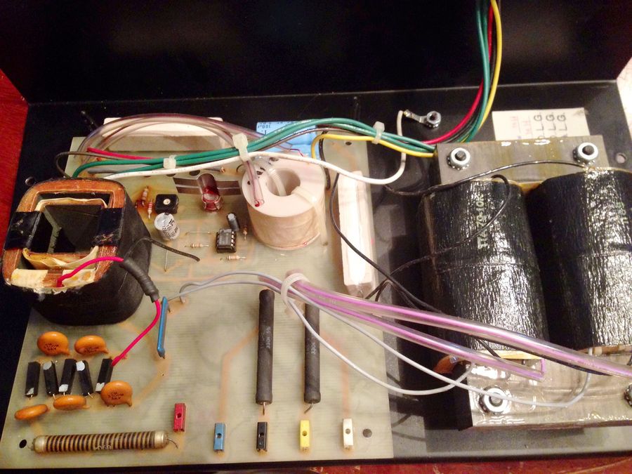

Just trying to put together a spec to have a professional transformer shop build it for me (just getting a quote). Attached is what I got so far... (appreciate any feedback).
I know that suitable step-up arrangements for hybrids can be put together using small toroids. However, if you are going to be getting something custom wound anyways, you might consider a design that would require only one transformer per speaker. In my experience, suitable step-up transformers for segmented designs with capacitance < 200pF is most easily attained using a dual bobbin UI core transformer. See attached pic of Acoustat Spectra 11 transformer, and coil layout arrangement to get an idea what I am talking about. If the winder you are talking with can wind a UI core (5 in x 3 in) and 1 in^2 core area with M6 grain oriented steel, it is pretty easy to get 120:1 ratio with core handling capability of 40Vrms (200W/8ohm) @ 150Hz without any fancy winding geometry. Unless costs are significantly different in your area of the country, you should be able to get it wound for ~$100 which is likely not much different from what you would pay for the number of toroids you are considering. I can help provide winding directions if you decide this is something you want to pursue.

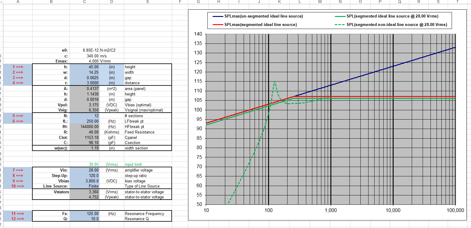

Here is what I have for my panels (from Bolserst's spreadsheet)...
h: 45.00 in height
w: 14.25 in width
d: 0.0625 in gap
r: 5.0000 m distance
A: 0.4137 m^2 area (panel)
h: 1.1430 m height
d: 0.0016 m gap
Vpol: 3,175 volts Vbias (optimal)
Vsig: 6,350 volts Vsignal (max)
N: 12 # sections
fL: 250.00 Hz LFbreak pt
fH: 144000.00 Hz HFbreak pt
R: 46.00 Kohms Feed Resistance
Ctot: 1153.18 pF Cpanel
C: 96.10 pF Csection
w(sec): 1.19 in width section

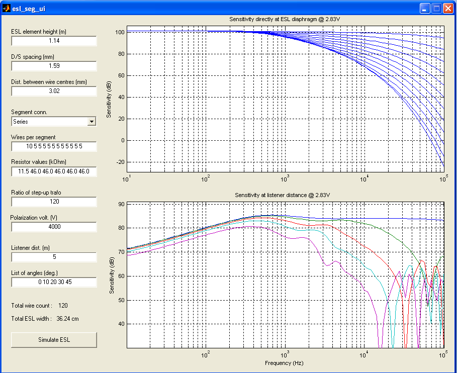

I finally got around to updated the spreadsheet calculator:
ESL_line_sectioned_DIY_v3

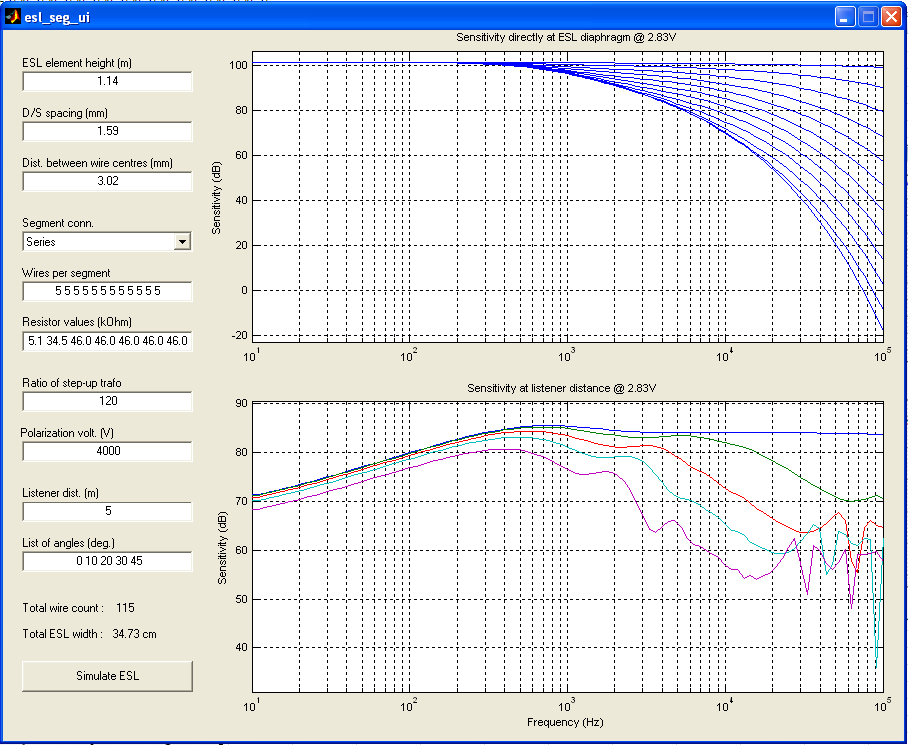

I used you design values as a test case for the newly added esl_seg_ui parameter outputs in the spreadsheet for Configuration 1 and 2. The results are shown in attached pics. As you can see, differences in dispersion are only in the top octave. With the larger middle section of Configuration 1, you can see nulls in the top octave. This is what golfnut’s 17mm maximum width rule is meant to avoid.

So I tinkered around with your revised spreadsheet (which, again, is awesome) and this is what I come up with (see attached).

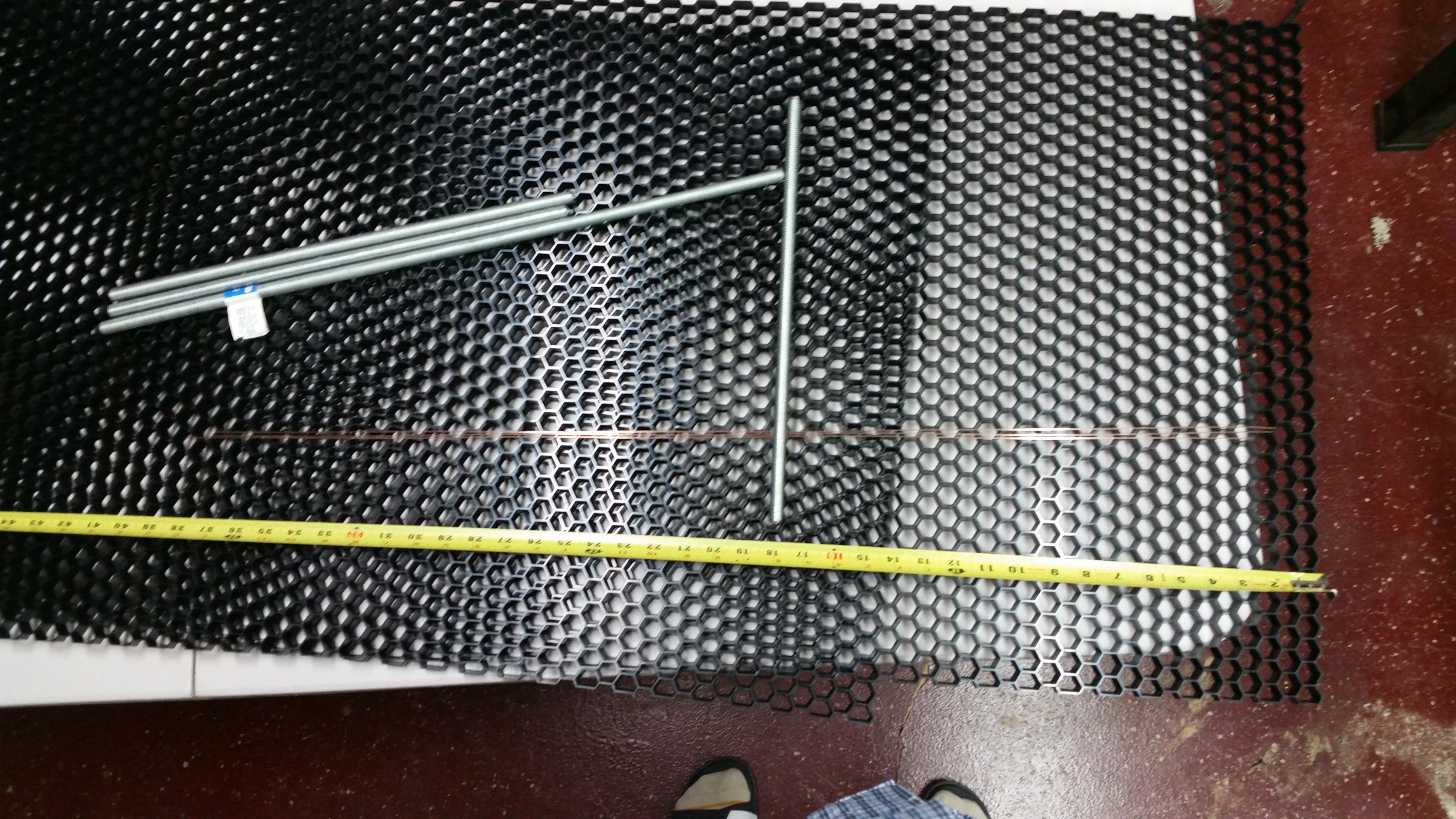

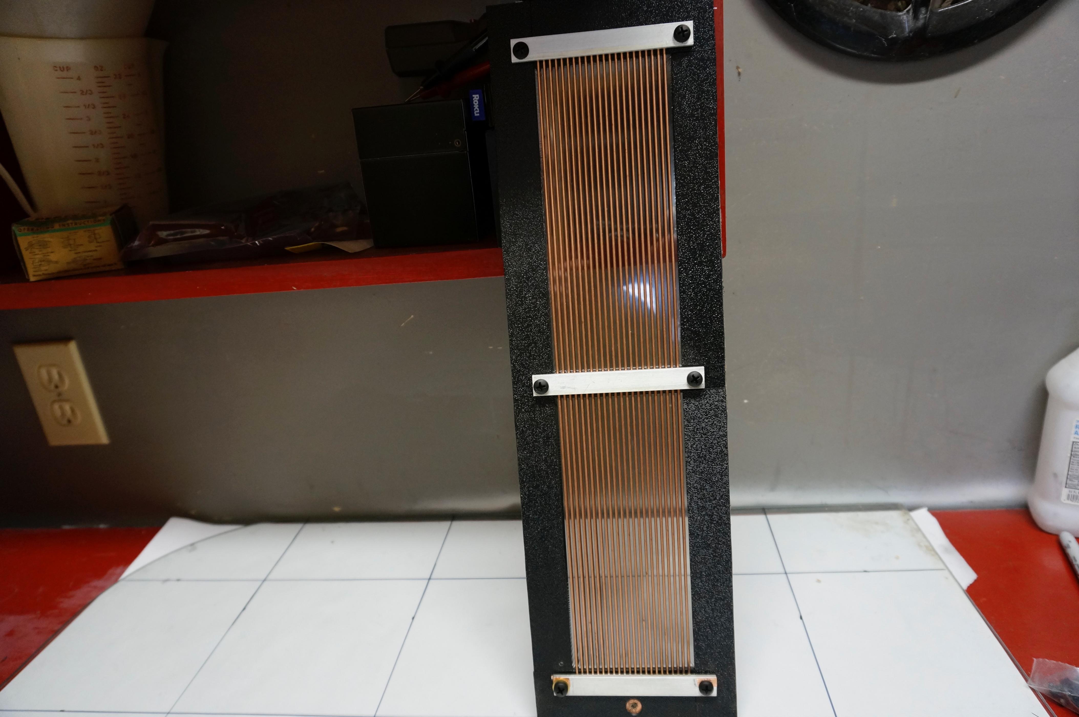

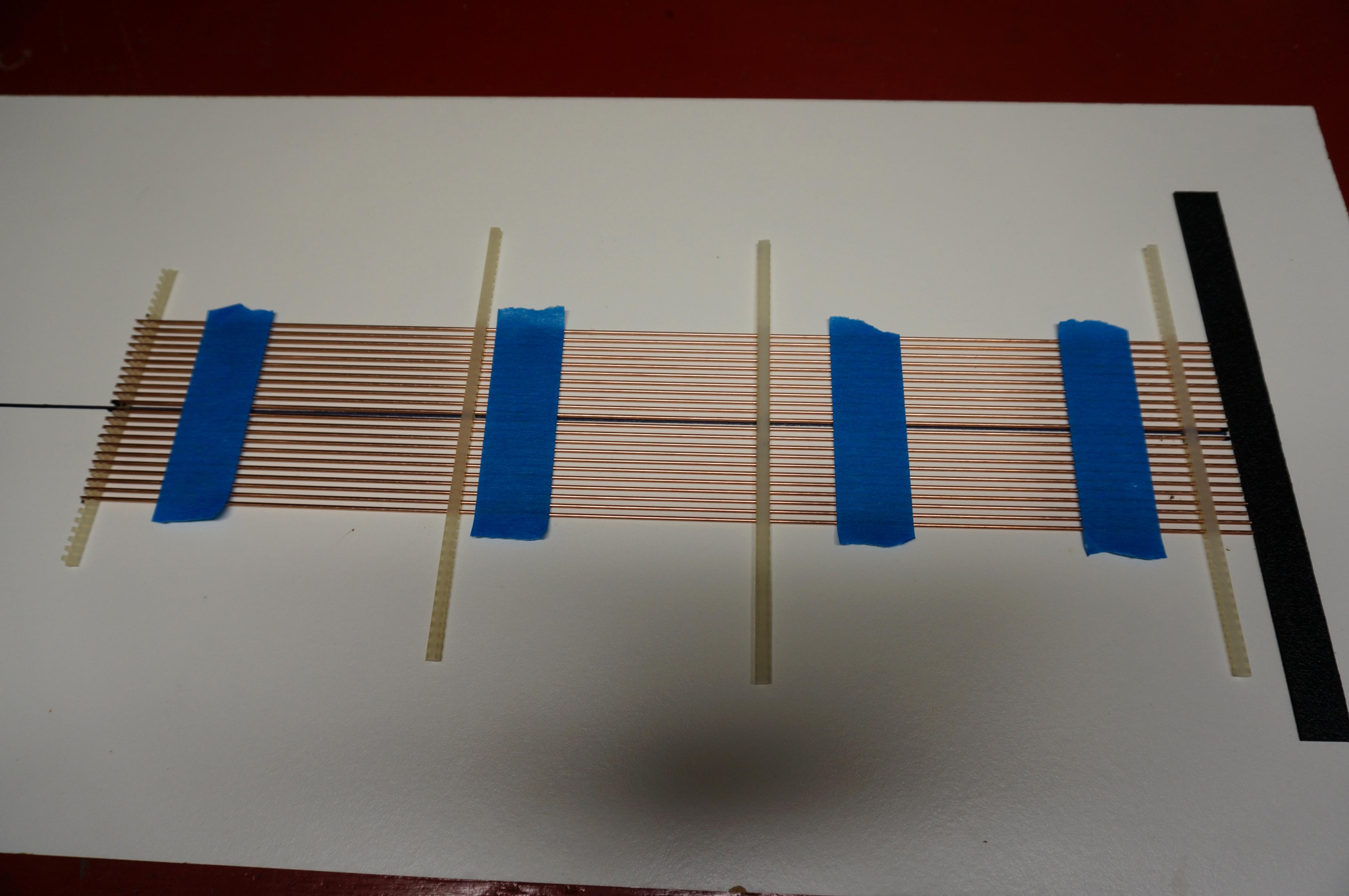

Hi bengel,
If you are using 1/16" rods, nylon edging grommets are an alternative to bolts. They work very well for keeping them aligned and straight. They are made by Panduit, are about 12 3/4" long, and can be purchased through Mouser and other vendors. They look like mini dental teeth. I am building ESL's using multiple small panels using the grommets, but have also used them for larger single panels.
Below is a picture using the grommets and one of a small single panel. You've got quite a project there, but it's a lot of fun.
