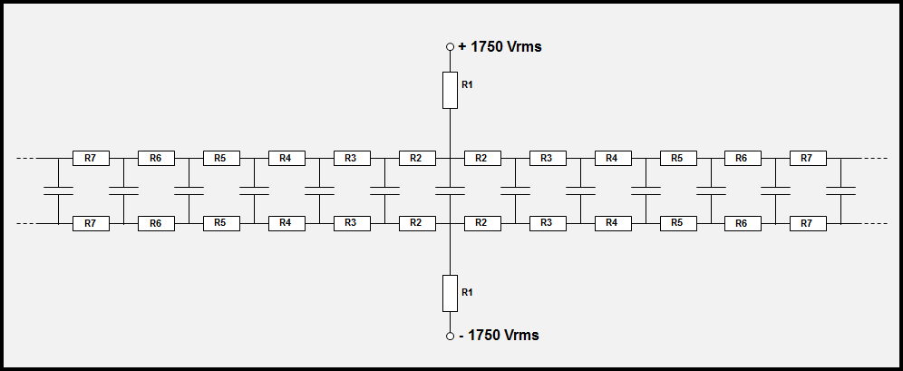

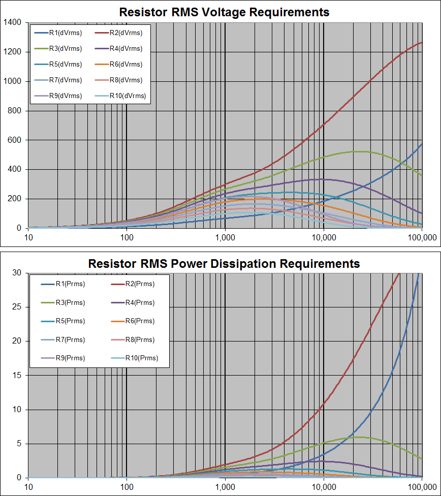

You will be just fine with 6 resistors per bank for voltage and power ratings even with high level sine wave testing.With 6 resistors per bank, I think I should be OK - not completely confident though. If I am doing the math right, the 1st bank will see the full ~3.3kV load (peak).... I must be misunderstanding how ohms law applies here because the power dissipation requirement is pretty amazingly high
For typical music listening they will likely never even get warm.
If I recall correctly, you plan to use 115:1 step-up ratio with an amp that can put out about 30Vrms. So you would be applying about 3.5kVrms to the stators. Attached pic shows voltage and power requirements for the first 10 resistors when sine wave testing at the 3.5kVrms maximum level using the parameters you chose in Post #70.
You can see things aren’t quite as bad as you think they might be. It is not the voltage applied to one end of the resistor that matters, but the voltage difference between the two ends. Usually the voltage and power requirements are only of concern for the first few resistors in the ladder where there is significant voltage differences between the adjacent segments.

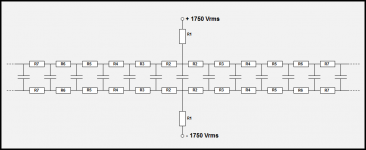

Yes I should of noted that there will be 12 resistors per *electrical* segment. i.e. 6 resistors for each physical segment "side".
BTW this is what I got in your spreadsheet.....
30.05 (Vrms) input limit
Vin: 28.00 (Vrms) amplifier voltage
Step-Up: 120.0 step-up ratio
Vbias 3,800.0 (VDC) bias voltage
Line Source: Finite Type of Line Source
Vstators 3,360 (Vrms) stator-to-stator voltage
4,752 (Vpeak) stator-to-stator voltage

You didn't mention what value resistors you got...Yes I should of noted that there will be 12 resistors per *electrical* segment. i.e. 6 resistors for each physical segment "side".
You probably already know this, but to increase voltage capability you need to put the resistors in series. For increased power capability series and/or parallel combinations can be used.
I got 6x5.6 kOhm for the 1st segment and 5x9.1+1x8.2 kOhm for the other segments (physical).

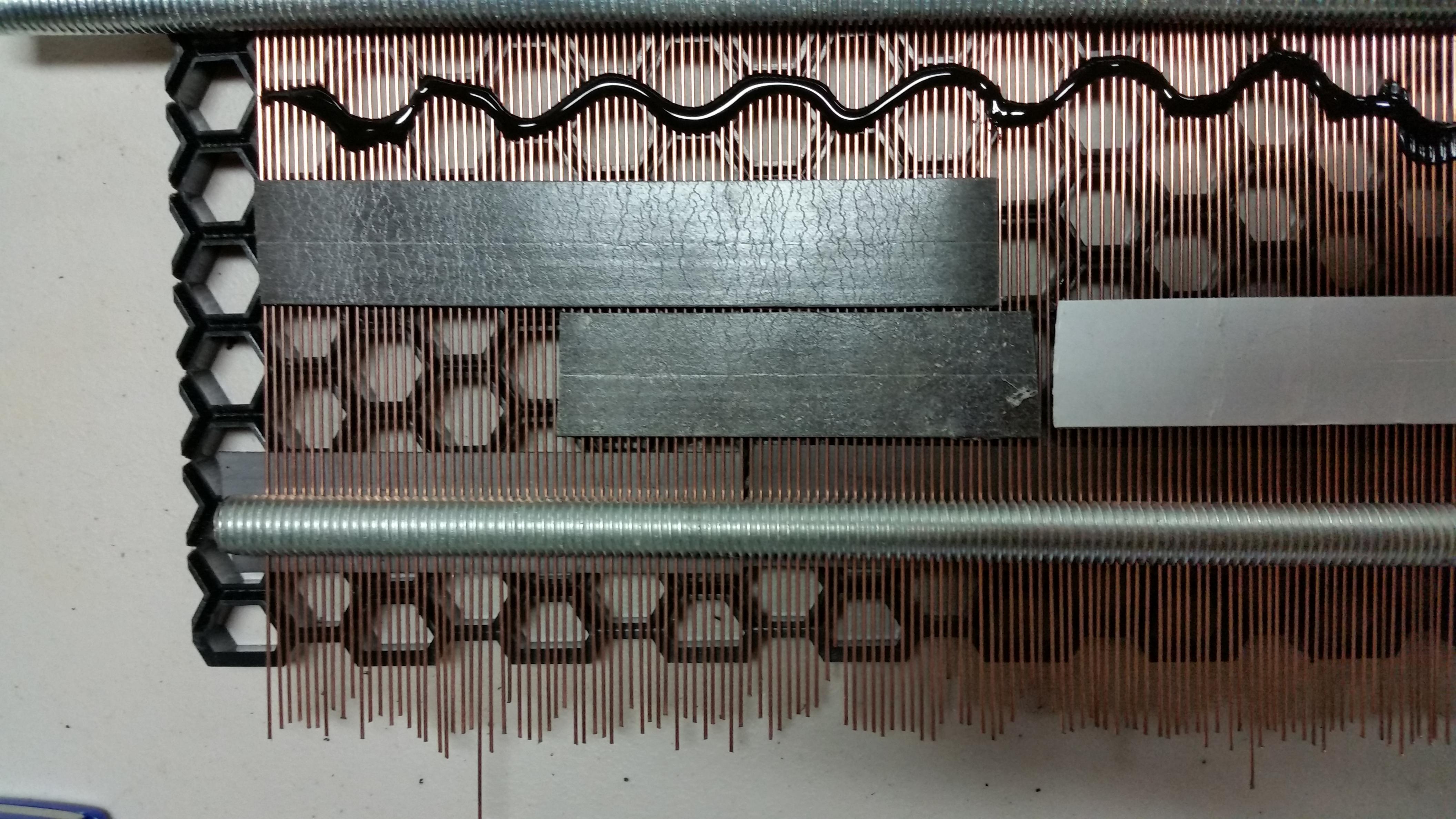

I wanted to post a little tip that is helping save a ton of time and aggravation putting these wire stators together.
Basically, I've found that if you take the threaded rod and put a strip magnet directly under it, you can simply "thread" the wires in between the threaded rod and the magnet strip. This has the advantage of keeping the threaded rod in place and keeping the wires from jumping out of their grooves.
Once you do one end, run a bead of glue across in one or more places, let it dry, then you can "comb out" the rest of the wire lengths to get them spaced right without the wires sliding around on you.
See attached picture, hope it helps someone.
