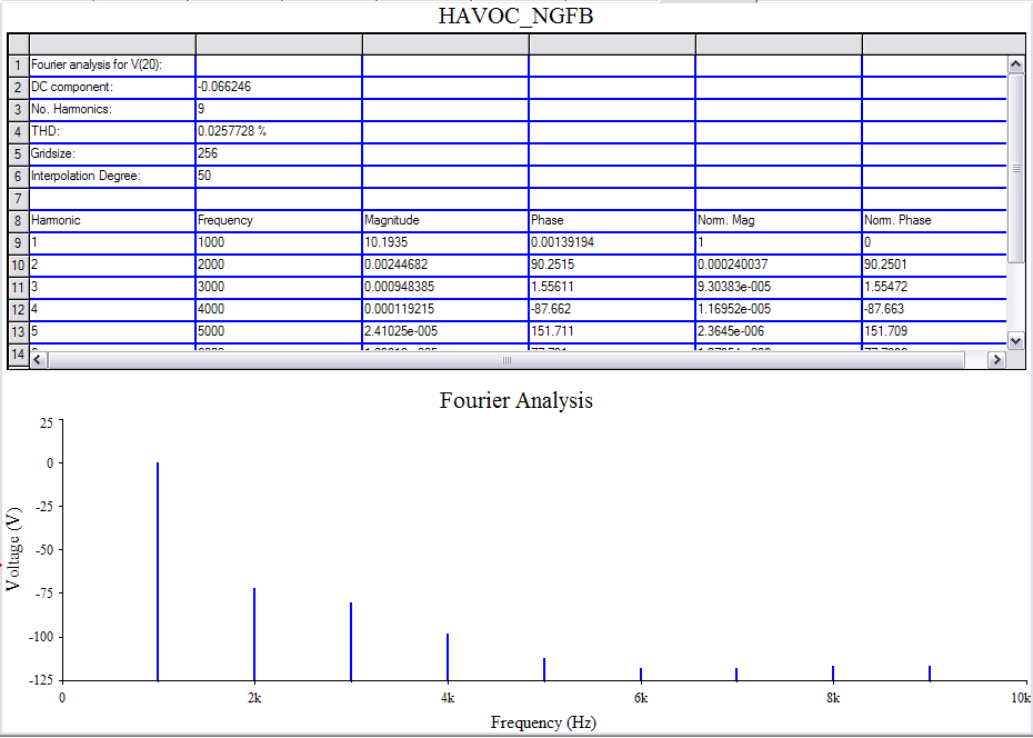

I've been trying different scenarios with the simulation, mostly to see the level of distortion with the changes. Without a doubt, the high bias gives the lowest THD but at the cost of serious heat...
I will build it, test it and listen to it with both high and medium bias on both the drivers and the output stage to see what works best.
I've pretty much made up my mind on the MJW21193/94 for the outputs and I've even downloaded the simulation models for these from OnSemi (GASP!). They are not giving me THD numbers as good as andy_c's MJL4281A/4302A models but the results are still within reason - .025% THD. As good as it needs to be I think.
