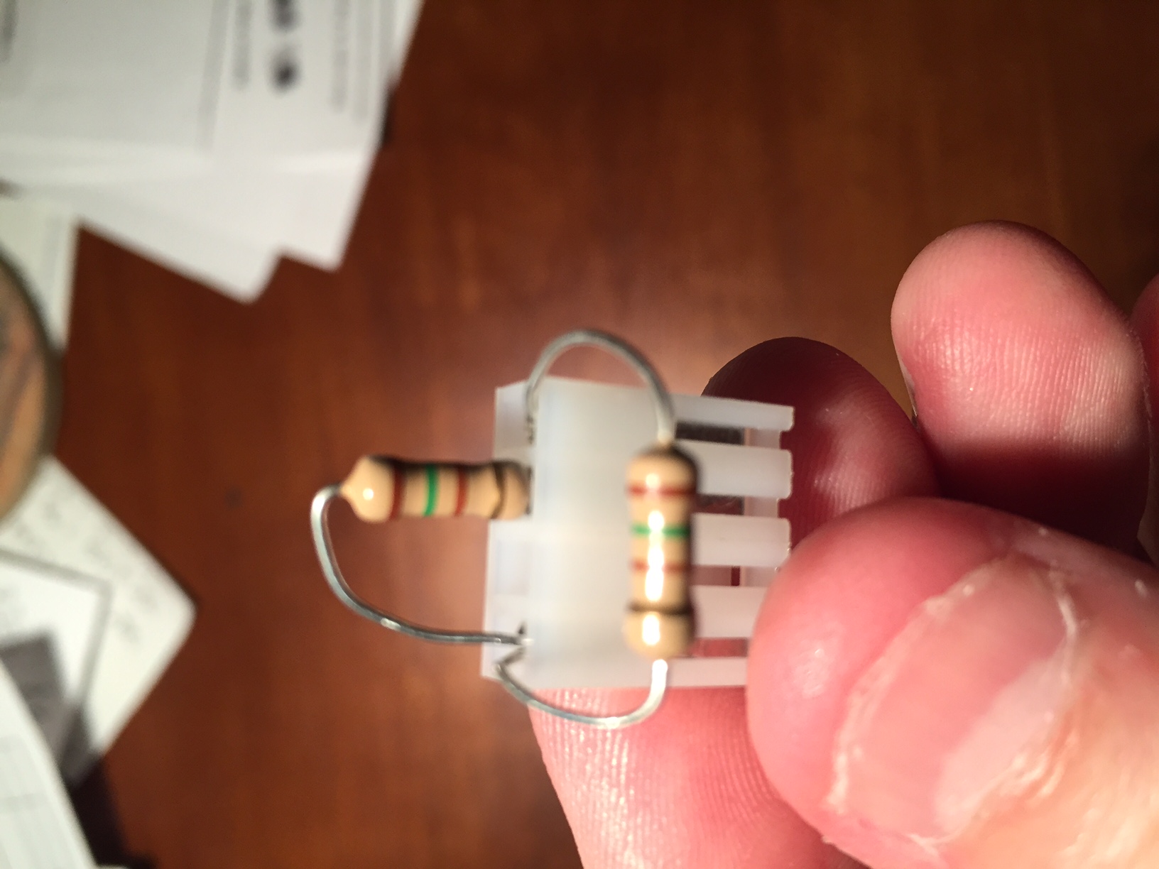

Read post 1 because it also has links for the wiring harness and how to add dummy loads to the secondary voltages which must be done for it to run stable.

I have used the two secondary voltages for a computer fan (7.5Vdc) also used an LED with the 5.6Vdc with a resistor to go down to 2.5V. Both worked well, but neither turns off if you used the standby pins, they only turn off if the power is disconnected to the PSU.
You could use the either (with a resistor) to run a BT board or USB port, but a speaker protection and pre-amp boards typically wants 12-15Vdc
I have not tried, nor have I seen where someone tried to combine the 7.5/5.6 to get 13Vdc. Easier to just buy a small torroidal for 12-15V and play it safe.
No idea about the temp probe sensor, I took it off and threw it away on both of mine.

You can do whatever you would like with the aux supplies. Just keep in mind that you must still draw some minimum amount of current from them in order for the PS to remain quiet and stable. This is the primary purpose of the power resistors - not just to create heat.
Depending on what you connect, eg. a circuit with a couple of op-amps, there may not be enough current draw and you will still need to include some dissipation.

If you would like to adjust the outputvoltage of the Abletec SMPS, you should place a resistor parallel to R442. This specific resistor is a SMD resistor placed on the solderside near the output terminals. I used a small 0.125W resistor of 220kOhm, that lowered the outputvoltage from 52V tot 46V.
