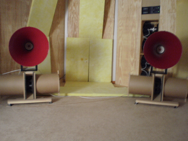

The idea of going to the 500hz horn crossover was just a temp measure anyway till I make space for the midbass front loaded horns (Erik Forker) that I made last year. That horn has a very smooth response from 105hz to 500hz and should sound better handiing those frequencies. So the intent is to end up limiting the PPSL to 40-105hz. I use a HSU original 10" sub for the last two octaves.

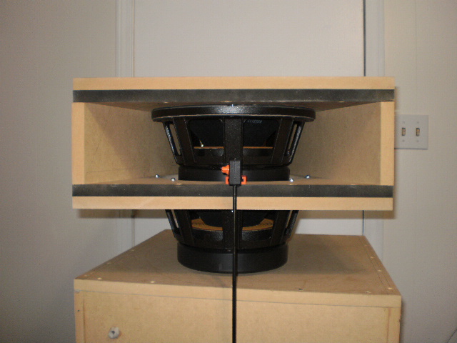

Build used home depot 3/4" plywood, stained and water based poly finish with several sandings after each of maybe 4 coats of poly. I routered most of the edges curved, and will eventually turn the boxes vertical to leave space for the FLH's. It looks good enuf unless you examine too closely, and matches the hardwood floor in the room as does the FLH.
I would probably be better off with a sub that can go from 25hz to 100hz vs using both the HSU and the PPSL for the same purpose, but I had the drivers on hand so figured I'd see how it sounded. I also felt that most sub drivers are too slow to mate well with horns, so thought this might be a better solution. I could try to corner load them and apply some eq, I might not need the HSU's at all. Again, Dennis, thanks for your patience and sharing of knowledge.

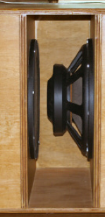

Opening is 1:2 of woofer's SD. These were made strictly for mid-bass. The dynamic impact is incredible! In the first picture you can see how the plenum is angled back. If I ever do another build, it will be that of a classic, shared volume, 6th order for SUB-woofer use only. I've come to the conclusion the ppsl is best utilized in the low bass only. The system in the picture uses them to 250 Hz, but my ears tell me 180 Hz and lower for best sonic quality. OR, it may just be inherint limitations of the drivers I used: Eminence 4012HO.

A plenum, or slot, is the space between the two speakers.
The plenum does not increase efficiency like a large horn would, but does subjectively increase "punch" and "tightness", and allows for a smaller frontal area than if the speakers were front loaded, and is easier to build than a stepped baffle for push pull as is used with speakers requiring a higher crossover point.

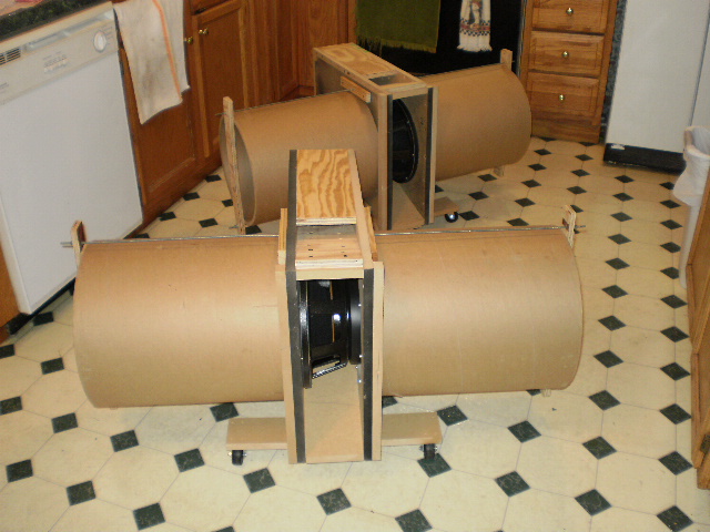

ppsl mid-bass prototypes
Scott: have you tried them with a plenum which is as small physically as possible and no taper as shown in your first picture? Are your sections of sono tube sealed or are they vented? Thanks. Best regards Moray James.
Hi Moray,
The plenum is indeed as small as physically possible. The magnet actually sits slightly inside the cone of the adjacent woofer. The taper goes from front to back, not side to side. It was also built to mimic the beginning of a horn throat. The horns I built for these were prototypes, too small, and not a sturdy enough construction, which is why I removed them. The sono-tubes are sealed, and of differing volumes to compensate for the fact one woofer is inverted. An interesting observation I discovered along the way is, while a single drivers' Fs is 46, when they are loaded in the slot, the fs dropped to 40 Hz. One can throw Thiel/Small calcs out the window in this type of build: the system Fc lies at 57 and the apparent low frequency limit is 36 Hz. Just imagine what a ppsl sub-woofer application can do !

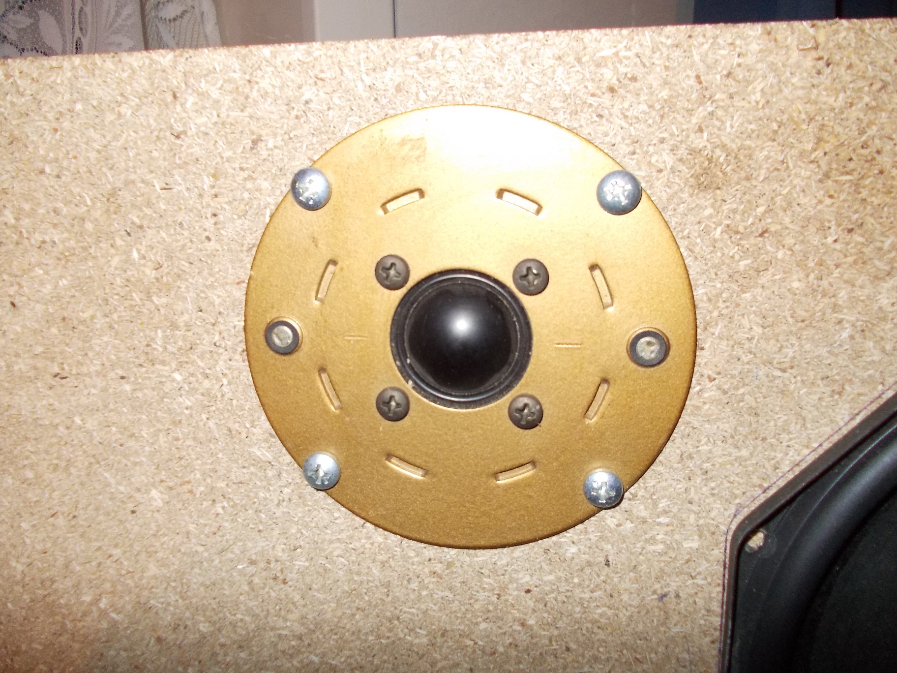

By the way, little offtopic but do someone now what tweeter this is? it sounds better then the magnat metal domes.
