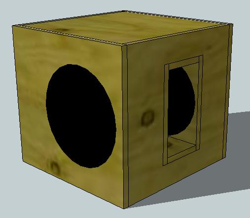

ive made a sketch of what i had in mind.
just a bit worried about the plenum opening being about 2:1
driver 18 sound 18lw1400

Thanks for discussing the slot ratios. I had forgotten about that. 2:1 means the slot is half the area of the total woofer SD? That's the minumum? DJK, what's the smallest slot you have made?

That sounds like a good question. How about the aspect ration of the slot? Have you done any experimentes with that? Especially considering mounting from inside the box it would be quite possible to come up with very slot-like plenum openings.
"...DJK, what's the smallest slot you have made?"
My first prototype was 3.24:1, later I switched to 2:1 for convienence of construction.
I was alarmed at how much pressure I was getting with the first prototype, but in retrospect it was nothing in comparison with a typical compression driver and its 10:1 compression ratio.
NP in his slot-loaded OB speaker measured a 2.78dB gain with a 3:1 ratio. I have not tried to verify this with my PPSL. Art Welter thinks there may be some mass loading from the narrow slot and the wide front baffle. I can tell you that many times people talk to the FOH engineer at a gig about these, and take pictures too.
I have seen Nelson Pass use rounded plenums on the back side of his non PP slot loaded set ups, some have done 45 degree angles with or without a flare going towards opening, and of course old fashioned square box plenums.
Has any testing been done to determine any advantages over the various styles and shapes of plenums and thier openings? And of course, is it necessary to do any major rounding/flaring of opening to reduce port noise as with BR? If I had wood tools and money (measuring equipment) I would experiment :D Some day, maybe...
For now, I plan on trying to keep it as simple as possible (it's just a bass reflex or sealed enclosure with added PP plenum).

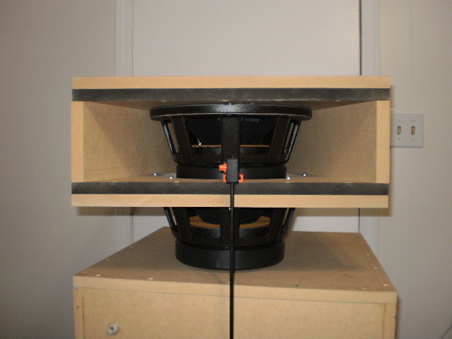

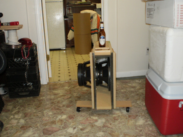

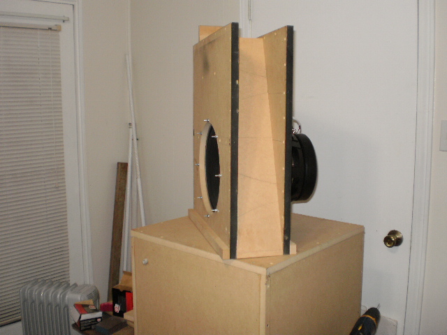

angled plenum
This was my 2nd attempt ppsl. In this case I used a very small plenum with angled walls. Granted, i did not do any case vs case measurements, but the system in the pics has relatively flat response all the way up to 800Hz.
(note the pics only show the partial internal plenum, without any surrounding enclosure... i built in inside first)

Scott, what made you decide on a deeper plenum (hornresp modeling)? Would making it more shallow effect the sound? I would be curious to see various testing on plenums.
I am happy to hear you guys are getting higher flat response than TH's, folded horns and the like. I need a sub that can go reasonably deep (I only care about music at this point so 25-30 is ok), but also cross over higher than 100 if I decide to fool around with crossover points...
I guess I should build something and figure it out on my own, right? :D

Hi Tim,
When you have plenty of time, read the whole thread: beginning to current.
This particular ppsl is the motor to drive a mid-bass horn, and the apex of the ppsl is stuffed with acoustic. IMO the beauty of the ppsl principle is that it is versatile. I have limited experience compared to others, but I think the real virtue of this design is a woofer (sub?)-woofer section of an active system.
I think a decade is the limit, so for an F3 of 25, think 250 Hz tops, and probably better off running only to about 125 Hz.
I really don't understand tapped horns- they don't make a bit of sense to me, but a ppsl is a true gem. I personally audtioned a pair built by Les Hudson
(while I was down at Axpona, in Atlanta, and they were truely remarkable.
... And yes, I would encourage you to build. I place a whole lot more value on creating saw dust than I do running "sims". Happy Listening :)
