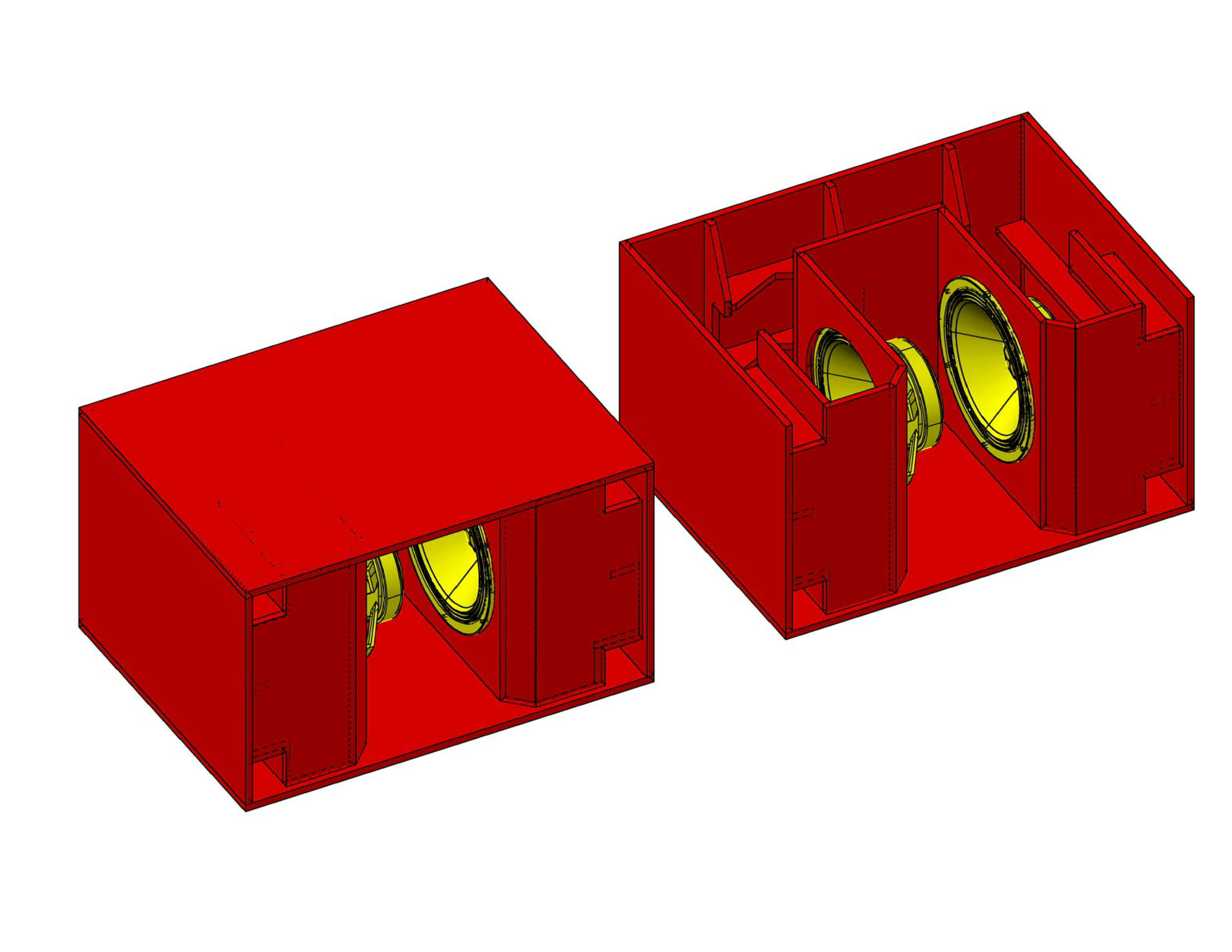

Is there some trick to forcing the software to hold 2 of 3 dimensions and add the 3rd to = the chosen Vb?
You can de-select "lock Vb" by selecting "lock dimensions". Just take note of your desired Vb and adjust dimensions accordingly. I'm going off of memory, so I hope I ....remembered correctly

figured it out
Actually the problem was that I had selected shape = prisim square opt. If you just choose prisim sq. the software lets you chose all the dimensions and only changes the Vb.

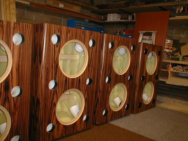

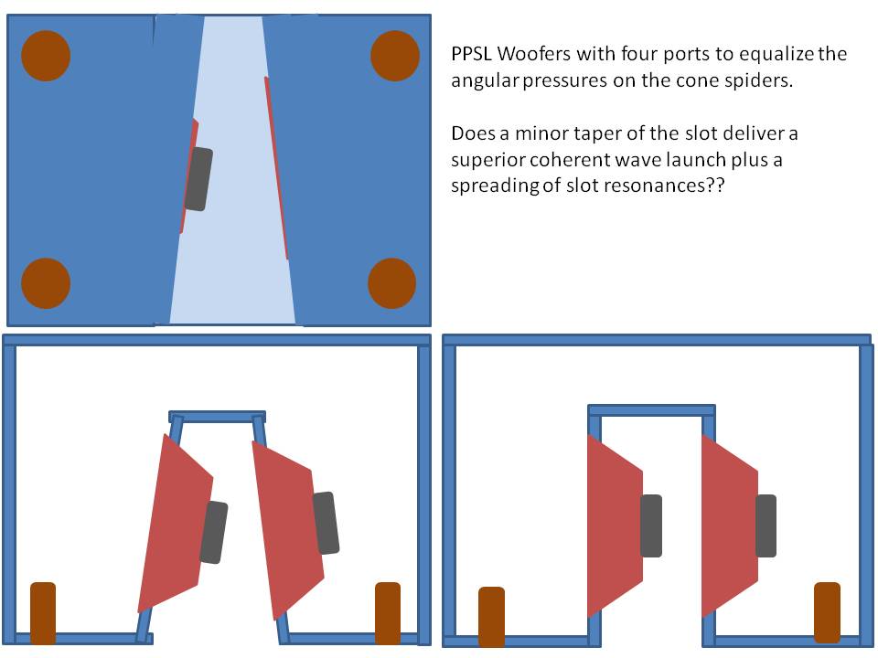

I have never built a PPSL Woofers, but
"My Daddy done told me"
"When I was a schoolboy"
"That multi-woofers need multi-ports to distribute pressure"
"Or uneven angular air pressures can tilt a cone and cause voice coil rub"
My Daddy liked Elvis. My Daddy could not rhyme.
Old school Altec woofers with paper surrounds had much more fragile spiders than modern subwoofers with thick rubber surrounds. A bass cabinet with multiple woofers will generate unequal forces from the different air mass from each speaker bouncing off walls, and this imbalance can cause angular rocking of a voice coil until it rubs on the pole piece. It was not uncommon for old school multi-woofer cabinets to distribute multiple ports in order to equalize air pressure inside the cabinet. Round ports with large radius terminations are proven superor(1-1.5 higher peak SPL before audible huffing) to equal area square ports.
Would a PPSL woofer with four ports help equalize the angular pressures on the cone spiders? The 18Sounds manifold has four corner ports?
Does a minor slant of the slot deliver a superior coherent wave launch plus a spreading of slot resonances??

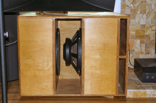

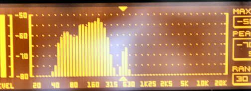

Finished my PPSL
Much thanks to Dennis, I made a pair of PPSL's using his basic design customized for JBL 2226h's. I had been using the 4 drivers in the usual JBL 4508 enclosures meant for PA use. While the sound was ok, they seemed a bit slow/muddy even with EQ and were 97db efficient vs my horns at 112db. The other big factor is their size and weight was didn't work asthetically in my livingroom. As for the PPSL's- My initial impressions of the sound were similar to others in that first impressions were a lack of bass. I have not seen much discussion on how well the bass box pro plot compared to actual. While I don't have rew, I did use pink noise w/the behringer mike 3' from the box and photo'd the deq's display. Both drivers are identical in their frequency output, and there is a significant drop out at 300-500hz, and a much smaller one around 80hz. I'm able to eq these flat, but still, I can't explain the limited high requency result. I'm sure Dennis will have some insight. EQ'd, the sound is good, I'm still working on it, but it adds about 6db's more efficiency, 1/2 the weight and 1/3 the size of the orig. jbl boxes. I do wonder if the reduced harmonic distortion isn't perceived as less full/rich sounding, similar to the perception of tubes vs ss electronics.

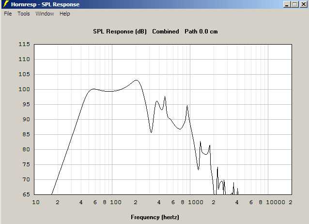

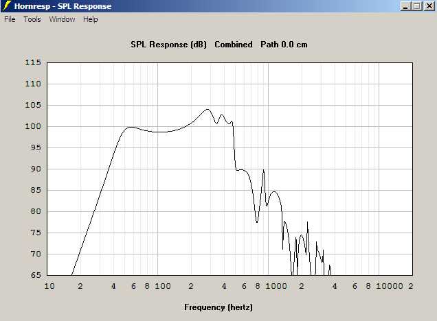

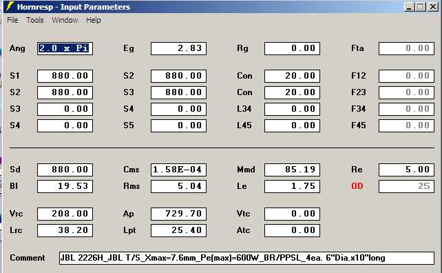

Hi pumpkin1,
I took a quick generic look at the JBL 2226H in a PPSL in Hornresp. It looks like filling the back corners in the front chamber would provide some extension at the upper end.
