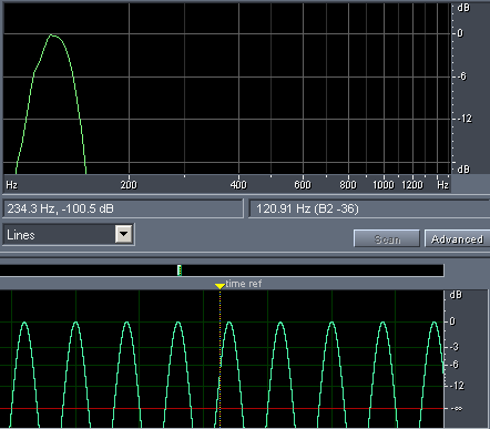

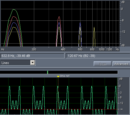

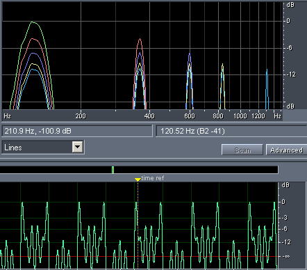

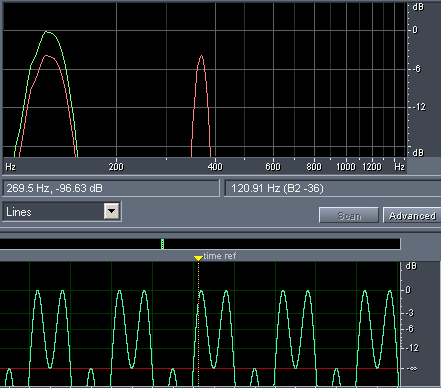

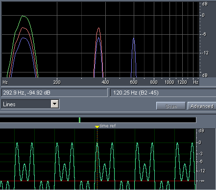

Let's take a closer look at how 0dBFS mixes of multiple equal levels sines behave.
Single sine 0dBFS reference:
Two tones:
Three tones:
Four tones:
Five tones:
As signal complexity grows, each component shares bandwidth.

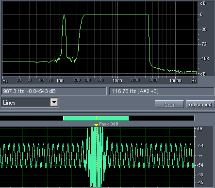

Here is 120Hz sine with broadband transient:

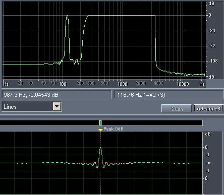

and zoom of above view showing 120Hz sine has signal peak of -52dB relative to full scale:
Applying this to your peak of 3.25 volts means using a single amplifier would require it to produce peak voltage of about 1294 volts to get unclipped output.
I've include an mp3 of 120Hz sine with 10 bursts as above, with extension changed to zip. Just change back to mp3 to explore it.
Two tones:
Three tones:
Four tones:
Five tones:

Thanks for the work on the additive tones, tho. From those we see that peak level never goes above 0dB - as one would expect. As things get louder and louder the RMS value of the signal will go up, but the peaks will never be above 0dB. They can't be, nothing above 0dB exists.
That's the main point of this test and survey. If you measure the voltage of a digital tone with a known value, then all other values will be known to you. Maximum possible voltage will be easy to determine.

I'm not sure why you are lost, when it is easy to determine; with my example test signal you can loop a segment between bursts, and now you are playing a 120Hz sine wave. If volume is turned up until 120Hz sine is 3.25 volts peak, the corresponding peak of burst at 0dBFS is 52dB higher. Doing the math, 52dB works out to about 398x, and thus multiplying out with 3.25 peak volts yields peak voltage of 1294v for peak signal in track.
So reality with broadband test signals is you can do high power testing of amplifiers and drivers in large signal domain without excessive heat build up.

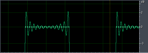

This is true for a simple sine, but Gibbs effect comes into play, and level between two sample may, and often will be higher or lower than either sample.
Here is simple case: With sample rate 48kHz, a 0dBFS 12kHz sine wave may be represented with as repeating sequence of four samples valued at -0dB,-0dB,0dB,0dB.
A connect the dot approach leads to conclusion that a square wave has been specified, and is incorrect.
A perfect sine wave passes through sequence of points and crests 3dB higher.
MLS sequences are constructed with only two sample values too, and reconstructed output has peaks 6dB greater.
