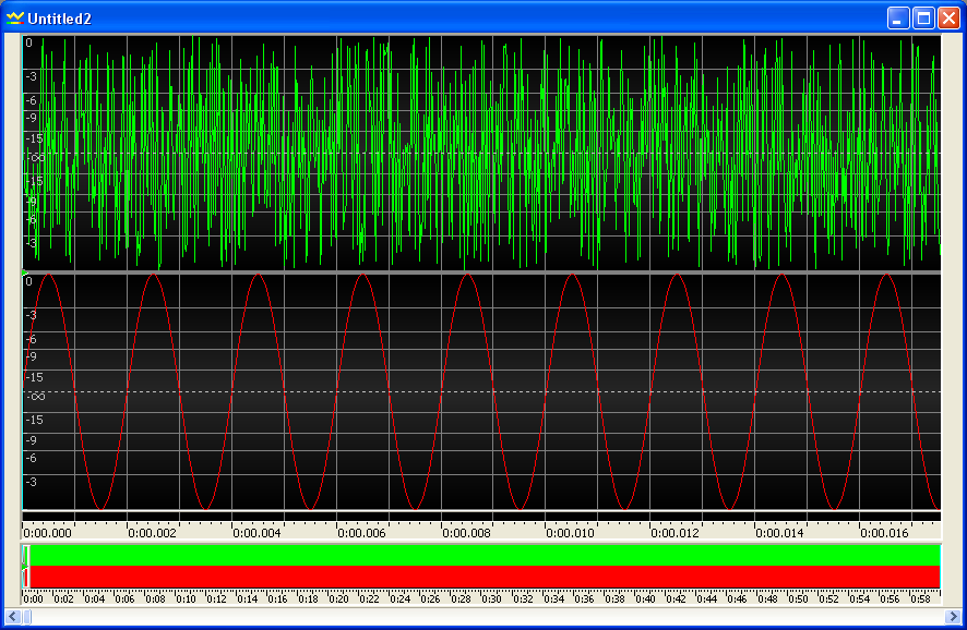

A picture is worth 1000 words, so here's a couple of pictures that should explain digital levels better than I did above.
On the first one we have white noise at the top and a full volume sinewave at the bottom. Both peak at 0dB, that's as high as they can ever go. The sinewave contains just one frequency (here 500Hz). The white noise contains (in theory) an infinite number of random frequencies. The sine has an RMS value of -3dB below peak. The white noise, about 4.5dB below peak.

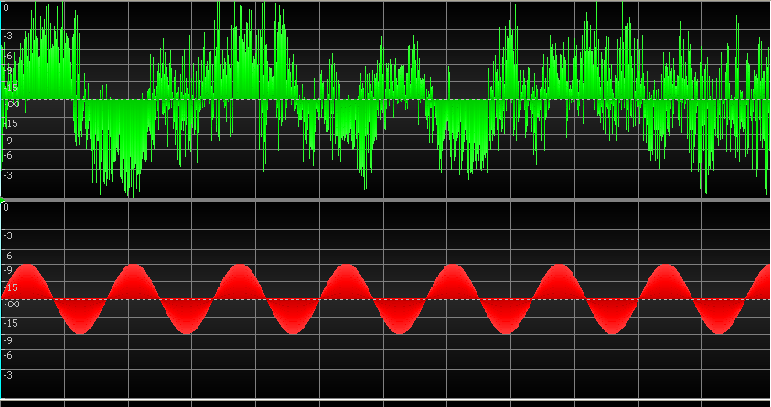

On the second we see a pop song with heavy compression. It's very squashed and has an RMS value 8.5dB below peak. I.E. Loud!! Below it is the 120Hz reference tone. You can see that it's peaks are at -9dBFS, thus its RMS value is -12dBFS. You can also see that there is nowhere for them to go above 0dB. That's as loud as the signal can ever get, no matter what its form.
