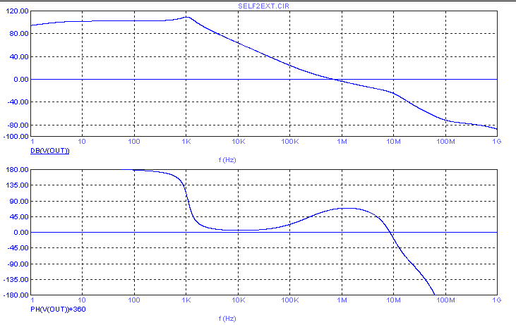

BTW, that graph on your post #47, isn't that the global loop response?
Below you see the global amplitude and phase loop response of an amplifier with TPC. Almost identical.
Only this topology has that ******* phase dip at around 10kHz.
To repeat myself, it is this amp/phase response that explains why, opposed to TMC and NDFL, TPC results in overshoot.
This is not a phase response of NDFL.
That's right, it's the phase response of the global NFB loop of an amplifier to which NDFL is applied. Any objections that I'm using amplifiers to ***** the merits of different amplifier topologies? But if you know better of techniques to characterize these merits, please tell us.

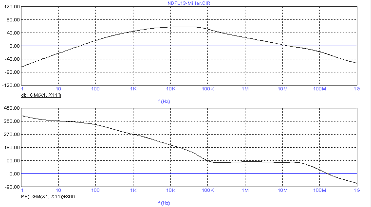

Then tell me, why NDLF and TMC do not cause overshoot? Because there ain't no mid-band phase dip comparable to TPC, talking about 'nonsense'. :D
>TMC can also have similar mid-band phase characteristics within the Miller loop.
:bigeyes: That's not my experience. Perhaps you should switch to another simulator. :rofl:
Below the MIller loop response of MY NDFL amp. Dip?! :tongue:

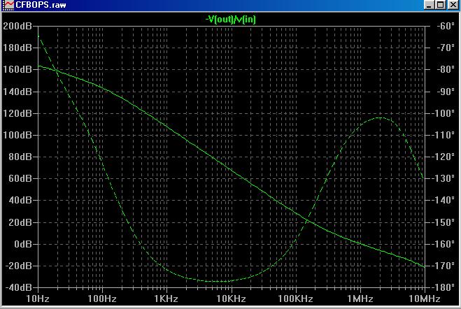

A mid-band phase dip does not necessarily mean overshoot. The reason why Cherry's NDFL amplifier with ~180 degrees mid-band open loop phase doesn't cause any overshoot was discussed in the negative feedback thread (see the discussion between traderbam and andy-c back when the merits of TPC Vs NDFL was being discussed.)
I suspect you know this well, but are just being disingenuous. I’ll attach once again the loop gain and phase response of Cherry’s amplifier. This NDFL amp does not generate any overshoot.
Hint: look! There is no gain peaking at the point at which the open loop gain starts to roll-off.

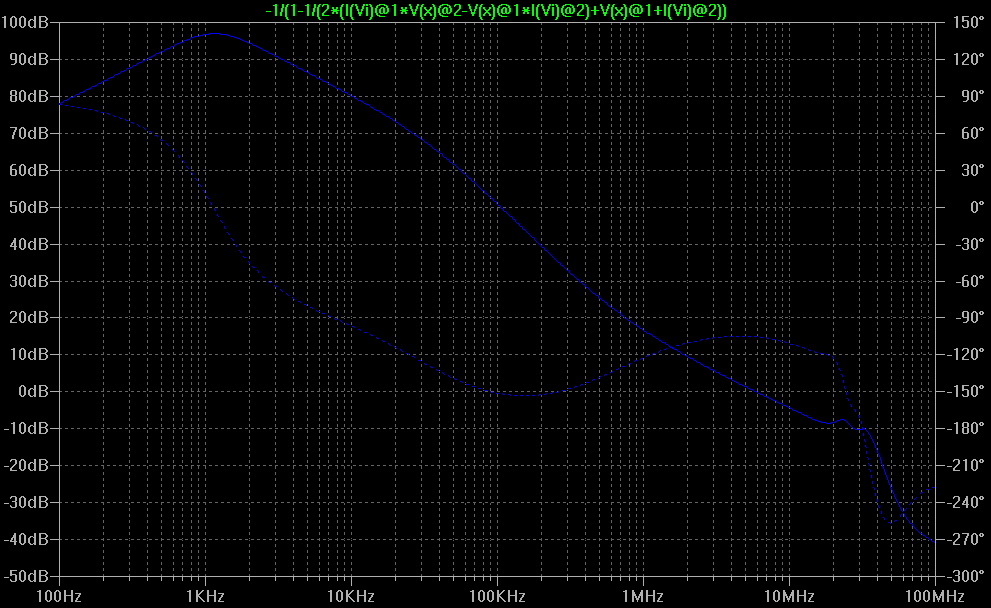

I have seen this also, with the circuit configuration of this post (Blameless with PSRR mod, VAS with inverted EF + Hawksford cascode). In order to stabilize the Miller loop, I needed lots of emitter degen in the CE stage, along with a very low Miller cap. The Miller loop gain is quite large, even down to pretty low frequencies. I'll try to post a before and after TMC plot of the Miller loop gain later today.
Okay, here is a plot of the Miller loop gain of the referenced circuit with no TMC. It's about as expected.

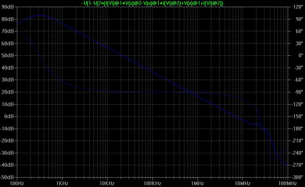

And here is a plot of the Miller loop gain of the same circuit with TMC enabled. You can see there's an effect on the Miller loop gain similar to what happens to the global loop gain with TPC. I don't claim this effect to be universal by any means, but it does seem to happen with some, albeit unusual, configurations.
