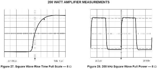

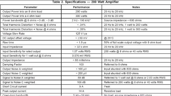

This picture it is the specifications given by Motorola for this 200W amplifier. The voltage slew rate it is given as 125V/ìsec.
Try a calculation and you can find that the slew rate indicated in Motorola curve it is 60V/ìsec as much. Is this method of calculation propper? Or the slew rate given in this table it is fake?
The answeer...
Probably, the method that used for the measurement of slew rate of 125V/ìsec it is seperate from the measurement presented in curves showing the output rise time (under real conditions because you can't measure a full output square under an 8Ù load with the feedback loops open).
Dirty Harry has a bandwidth limitted at 170KHz. This is given by the equation: BW = 0,34 / rise time = (0,34 / 2ìsec) X 10^6.
It is more than enough for its work.
I don't know how much is its real slew rate.

lineup said:Can it be that one value is for full voltage output
and one is for 50% of full voltage?
Hi Lineup
I don't think so, but i am not sure for this. Because in both graphs, i think the vertical scale it is the same, 20V/div.
Fotios
