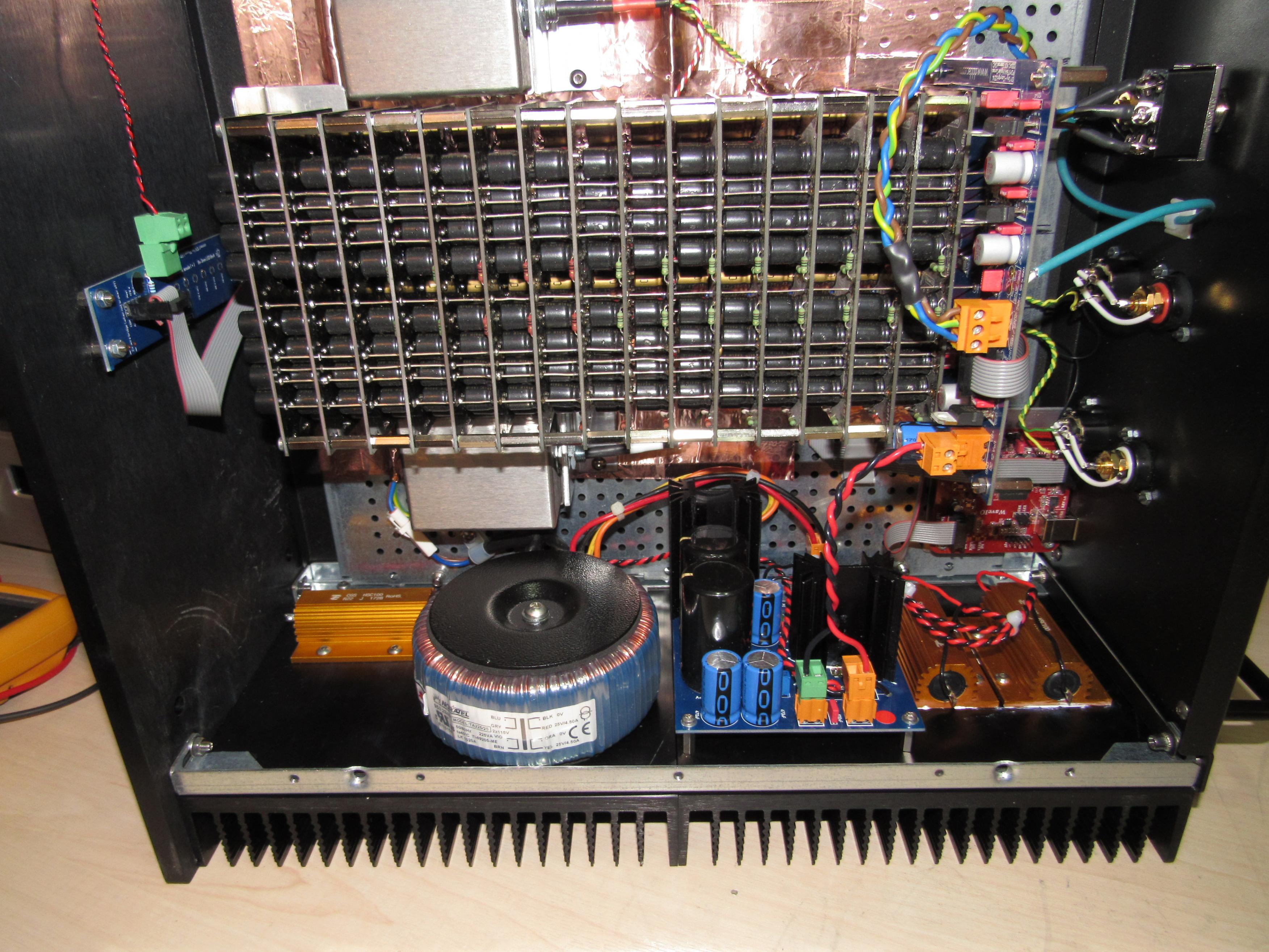

I am getting things together to try to get 16 Tent boards working. In view of Mbrennwa`s comments about the 12 Dacs using 3.5A, I have fitted a 300VA transformer that will give me 6A capability.
Funny thing is, that it has rather unexpectantly made my old board 16 stacks sound even better especially the low level resolution ... a nice bonus

What is the exact set up of this PSU? Just a 50/60Hz AC --> rectifier --> smoothing caps?
Cool! Let us know how it goes!
I am using the DDDAC power supply but modified with: 2 x 25v secondaries, 2R2 100w resistor between the smoothing caps which are Mundorf 10000uF. R22 100w second smoothing resistor.
The transistor changed to TIP142, then the final smoothing resistor is another R22 100w. Now the transformer is 300VA, 2 x 25v secondaries into the original rectifier with the largest heatsink that I could get, 63.5 mm tall.

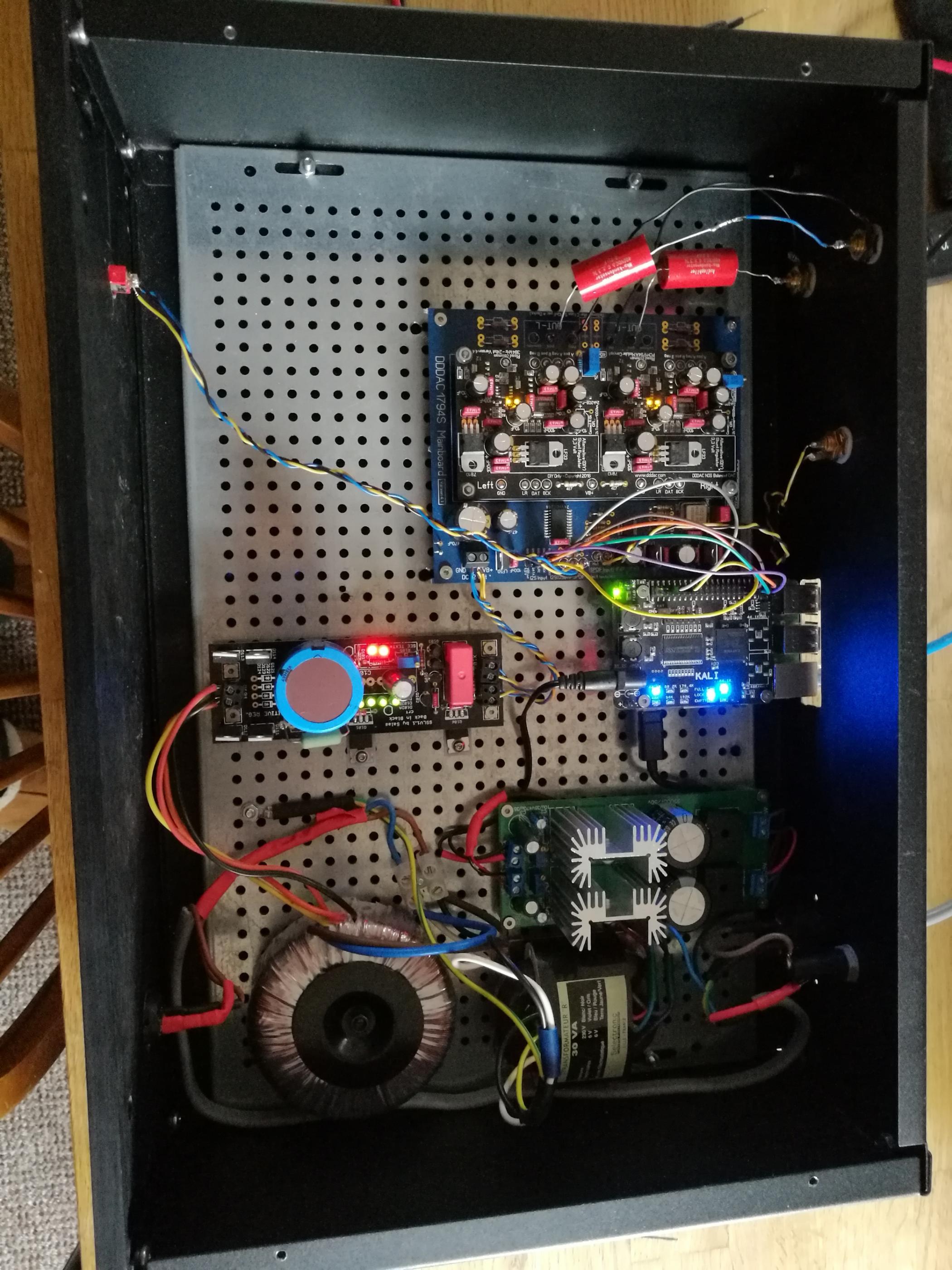

that is a bit short description.... help us help you by being more precise and descriptive what and when the issue is
is it harmonic distortion or "digital" distortion like crackles?
does it start immediately or after warm up ?
is it only at loud passages or also at low volume?
both at spdif and USB,
things like that....
pls download a 1kHz test tone somewhere, play it and use a simple multimeter to measure the AC voltage on all 4 output pins and post the result please
Do I measure them against the "common" pin on each channel?
If so then I'm unsure as to what the answer is. As I put the probe on I get a reading between 0.9v and 0.2v which then decreases rapidly toward zero, it falls to 0.008v after 30 seconds.
Left channel +ve starts at 0.9v and drops to 0.008v after 30 seconds.
Left channel -ve starts at 0.25v and drops to 0.006 after 30 secs.
Right channel +ve starts at 0.2v and falls to 0.006 after 30 secs.
Right channel -ve starts at 0.31v and falls to 0.008 after 30 secs.
Music is distorted at startup and doesn't change, I'd say it's digital crackling and at all volumes, the crackling increases in a linear manner as volume increases and it is the same from both spdif and i2s.

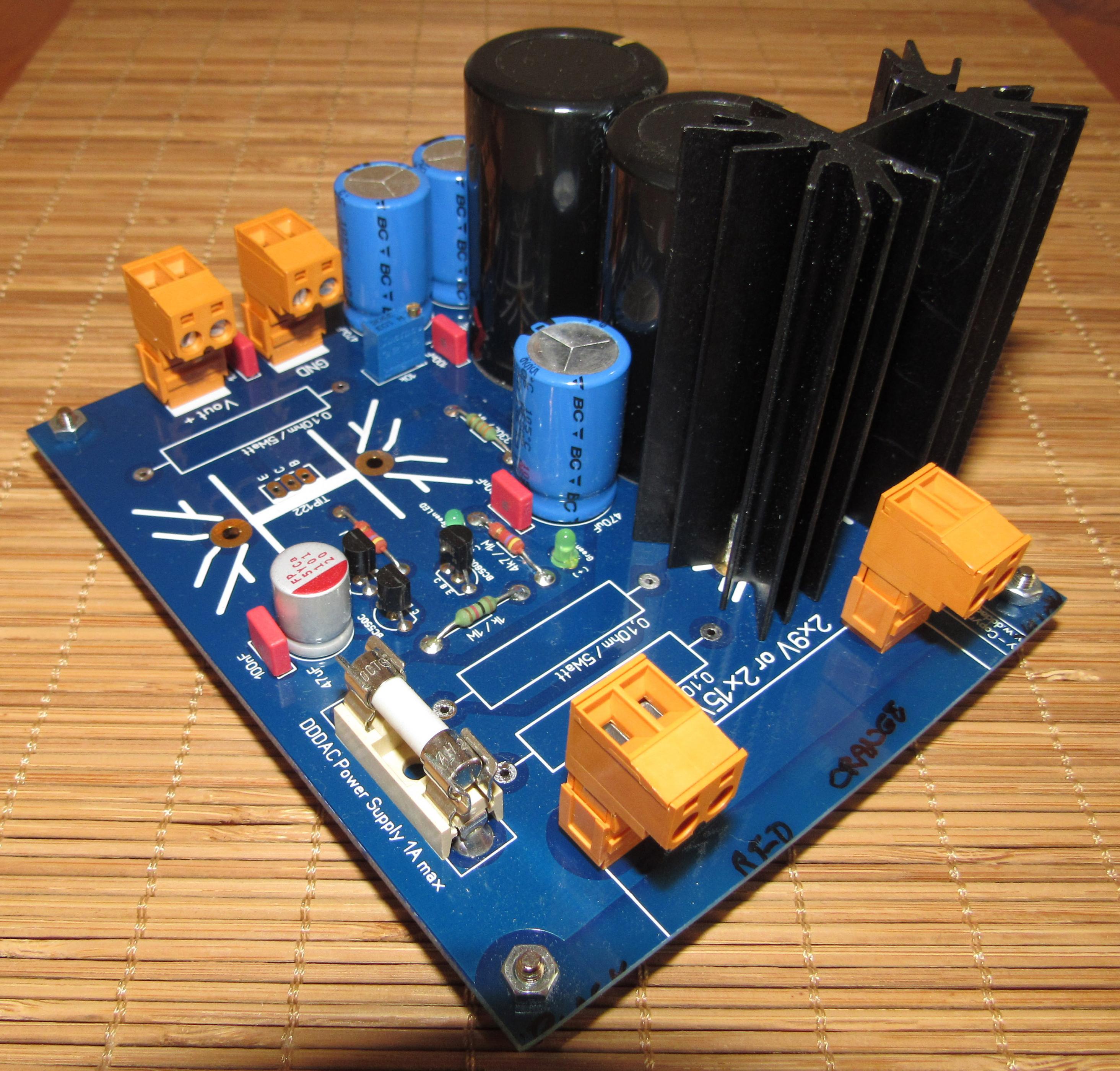

I am using a Salas shunt with a 15v transformer, this outputs 20v (approx) without load and 12.1 with load attached. It has a 500mA capability.

Just remeasured and I found it was giving 20v into the dac mainboard and 12v into a dummy load that should simulate the load of the dac.
I am not very familiar with the Salas shunt regulator, but I would expect it to be more stable than that. Maybe it's working at its limits, messing up the DC supply to the DAC? Can you try with another power supply (e.g., a lab bench supply) to see if that changes anything?
The Salas shunt 1.1 (a.k.a. "BiB") (judging by the pic that was posted) should be very stable, as long as the current that is demanded of it does not increase past the max CCS current (that is set by a resistor on the BiB). When the load asks for more current than the max set, the output voltage will drop. But testing with a light load (like 50mA) versus a heavy load (say 450mA) should make no change to the output voltage, as long as the CCS is set to a current over ~500mA.
But it appears that in this case the BiB is outputting 20V to the DAC board.. there's something wrong here.
