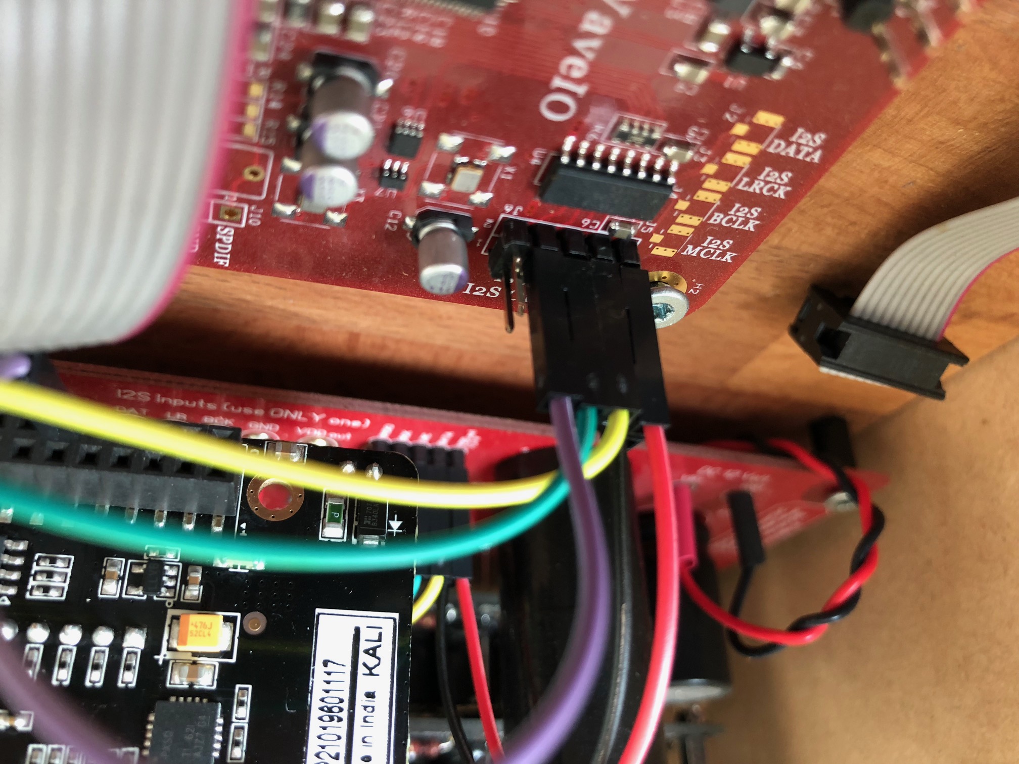

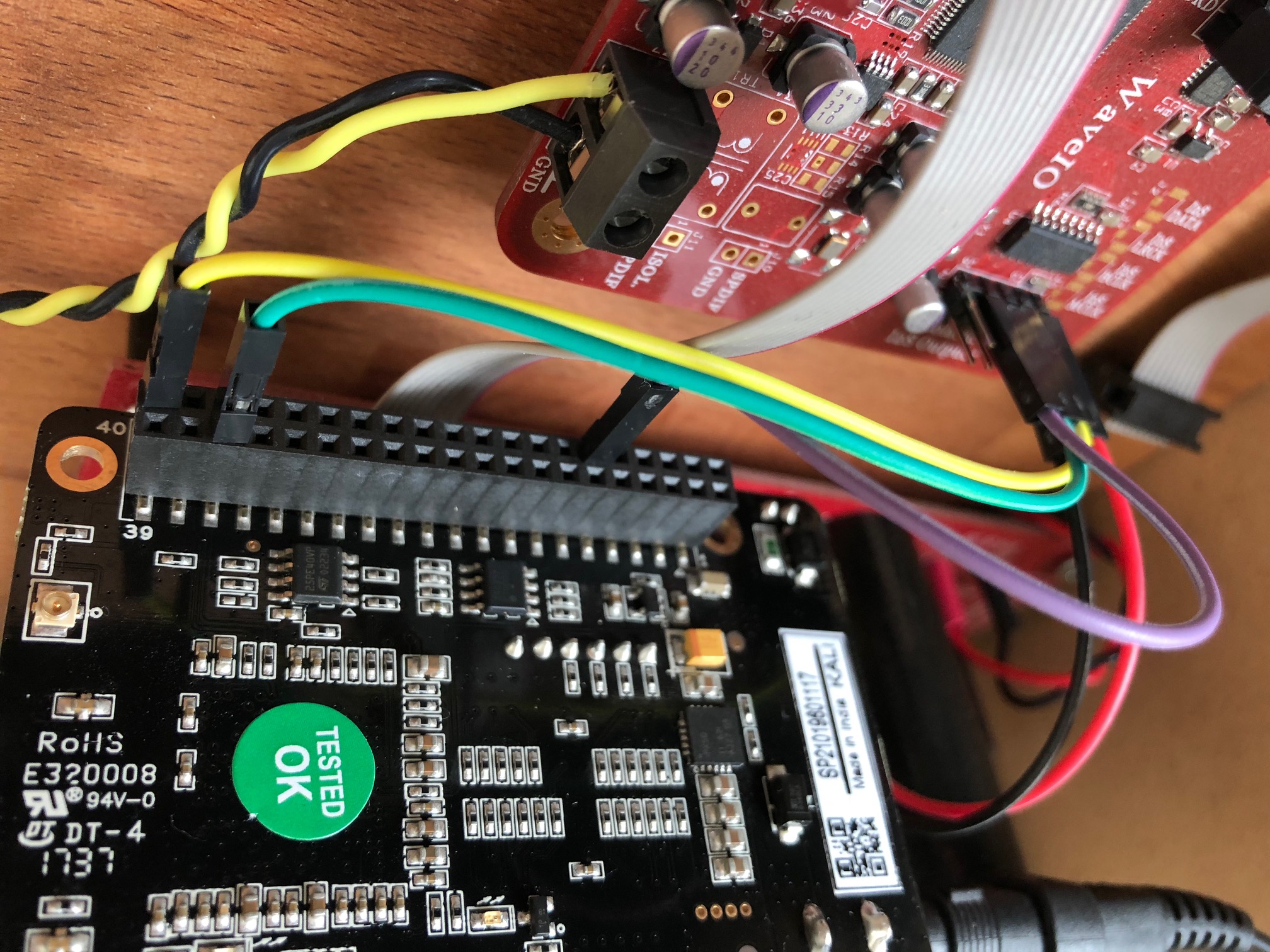

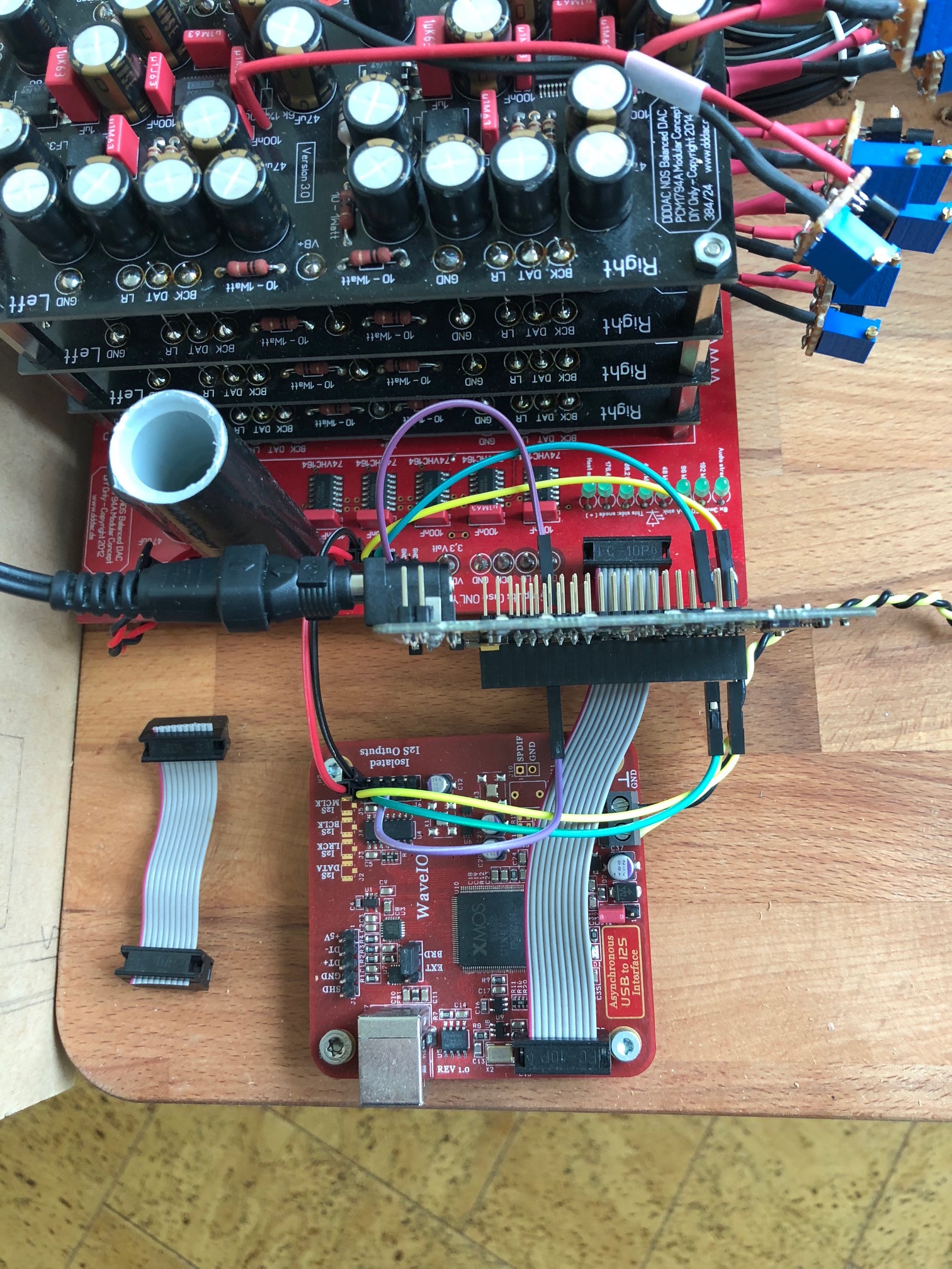

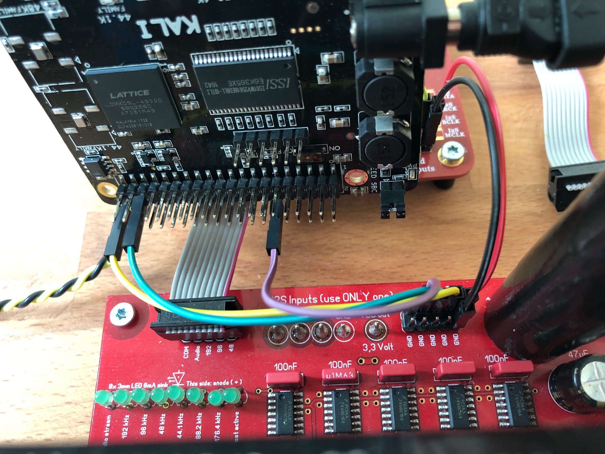

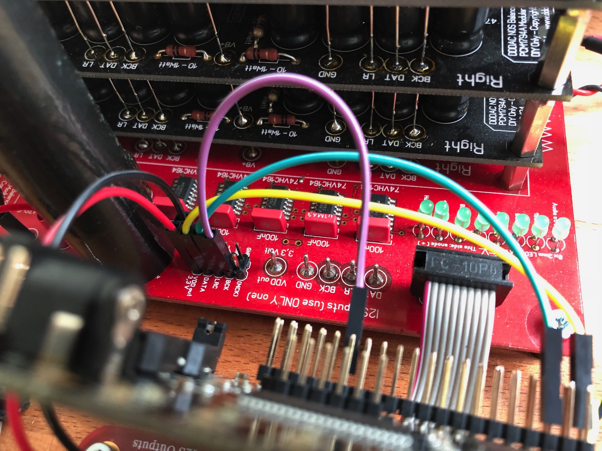

A few pictures. BCLK purple wires, LRCLK green, DATA yellow
Two comments:
  • It looks like the I2S-GND connections are missing. There may be a connection via the power supplies, but that's hard to tell from the photos. I'd think it's best to use direct GND wires for the I2S (both WaveIO/Kali and DDDAC/Kali).
  • It looks like you're using three different power supplies: (1) DDDAC, (2) WaveIO, (3) Kali. Make sure the PSU 0V of the Kali and the DDDAC are connected to each other (which will be the case if you have a GND connection between Kali and DDDAC).
You're right, I only had a ground connection between Wave I2S and DDAC (5V feed from Vdd). I added a ground connection between Wave I2S and Kali's pin 39, and a connection between the spare power neg pin on the Kali (all grounds seem to be interconnected) and the dddac I2S ground.
