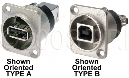

I know i have to use the flatcable to connect the wave io but i still have to make some metal part that will support the wave io so that the usb entrance will positioned just after one of the rectangular holes on the side of my chassis.
Maybe will have to get a new flatcable because thje short one will be to short in my situation.

But if not longer than 10 cm i will probably not be able to have the usb input at a spot where it can be reached from the outside. I will have to take a closer look at that.
Maybe i can diy a connection between the wave io and a neutrik connector similar to the one in the attachment.
Because i will not use the usb cable to deliver 5 volts to the usb only the two data cables have to be connected from the neutrik to the wave IO. If that is a piece of cake no problem to make a 10 cm connection.
The cables provided with the kit do they need a special crimping tool or can they be openened and crimped again to shorten cable length?
Greetings, Eduard
P.s If i am right i should go for the B type usb looks more sturdy

That connector is a passthrough A to B or B to A (you can change it) and so you do not need crimping tools. Just an ekstra short cable on the inside. Its either A on the outside with B on the inside or B on the outside and A on the inside.
Yes, i know i was hoping to use this kind of connector on the side of my dddac chassis and open the connector on the inside and just solder 4 wires between the usb entrance and the neutrik. seems a bit old to me to look for a 20 cm usb cable.

The flat i2s wire from WaveIO to dddac is important to keep as short as possible. Just use the neutrik usb connector you posted, then a short usb cable inside the case. Then you can mount the WaveIO nice and close to the DDDAC mainboard, where you will get the best sound quality.

I allready find the right spot for the wave io. So it would be benificial to reduce the already short cable provided with the kit by 50 %?
There is a lot of writing about the quality of usb cable so i was thinking why not get rid of some connectors and use 4 solid wire to connect the wave io to the inside part of the neutrik connector. I think it will not be that difficult to open it.
My chassis being at great height in my rack and being heavy as well i dont wanna just connect the usb cable with a plug to the wave io and let it just hang out somewhere. I am afraid it will get stuck somewhere if i am taking the chassis out of my rack and make me drop the dddac on my feet which will put me in a wheelchair for sure.

Preforably cut down the ribbon cable so that it is as short as possible (with the boards right next to each other). Just make sure that the cut is even and terminated at equal length. If you dont want to cut down and modify the cable, then make sure that there are no other cables close to it or at least make sure they are crossing and not running along each other. Quite a lot of lock / bad sound is caused by messy wiring looms.
A Neutrik nausb-w-b with a short angled (or normal) USB cable have no negative impact on the sound. This one f.inst is awailable in 4inch, 12inch etc Right Angled USB Cables - Angled A Connector - UP ANGLE
The neutrik connector can be configured for chassis gnd connection or isolated with the plastic shield that come with it.
