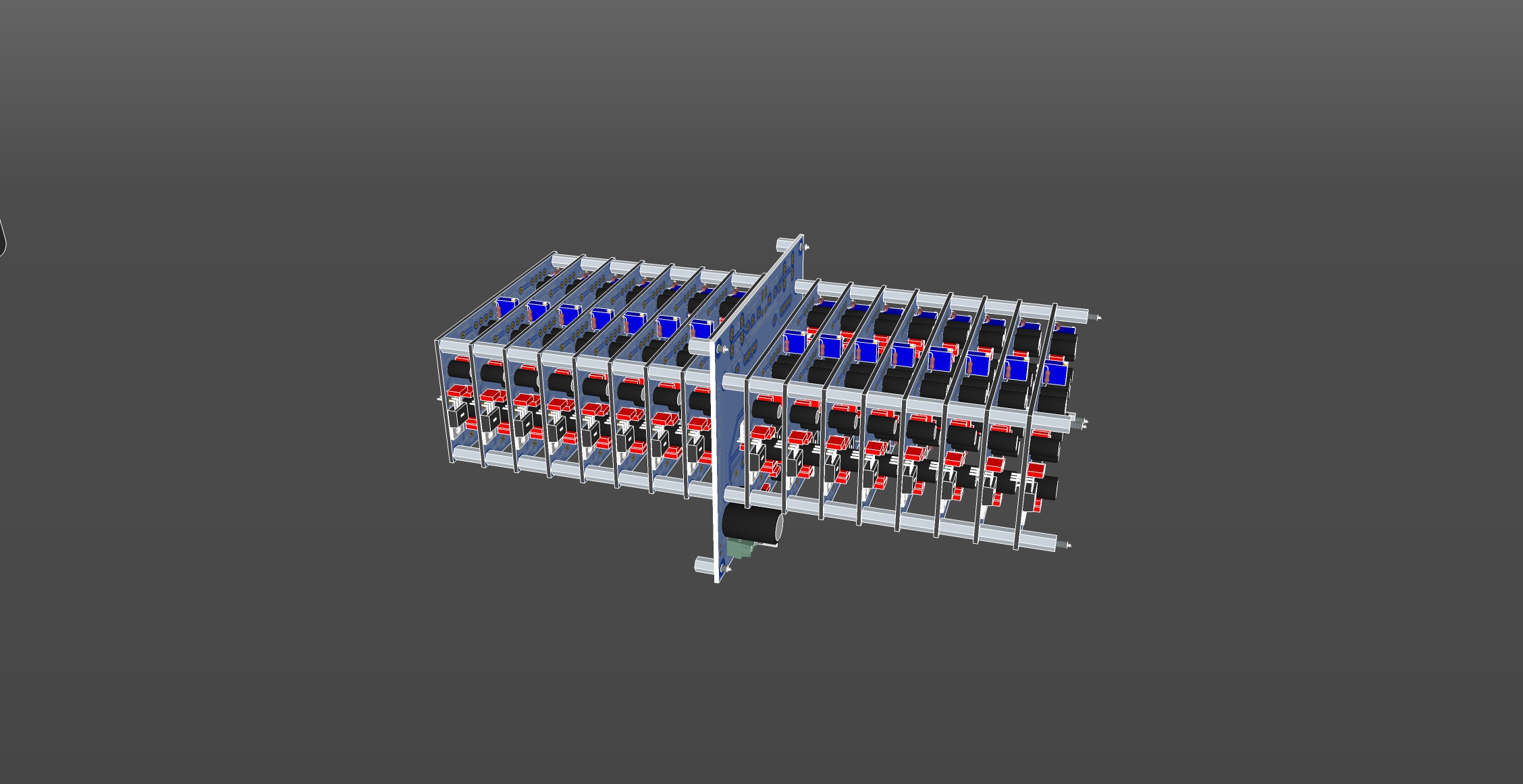

Getting closer to a finished render for the sketchup database. It will have all the correct measurements shown in the finished model (on a shown layer).

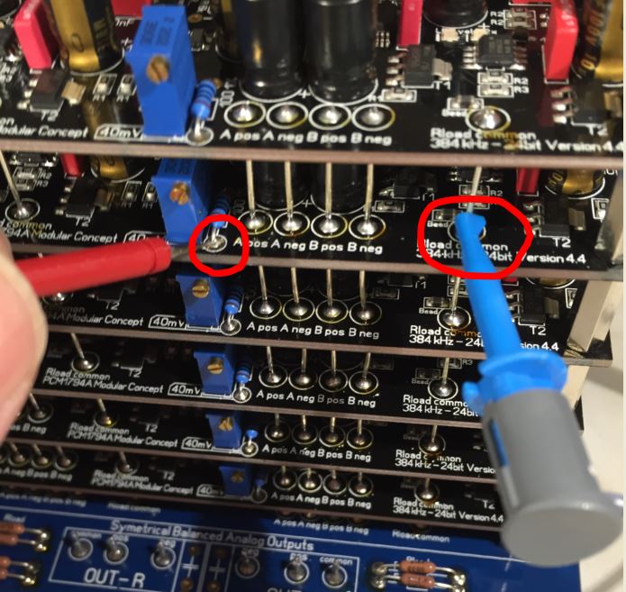

I just want to point out something important when building multiple decks...
If you are adjusting the bias to 40mV: One measuring point is the solder pad at the 100 Ohm resistor at the edge of the PCB. The other one is the common. But which one is the best to use?
For a single deck you can use the common from the analog output. However with multiple decks, the total bias current flowing over the mainboard tracks causes a small drop of some mV DC. No problem for the normal functionality, but it can just mess up your bias adjustment...
So best is to use for the common the actual common at the PCB. You can just clip the test pen on the wire connecting the decks. That will do …
I will have to update the building manuals…
