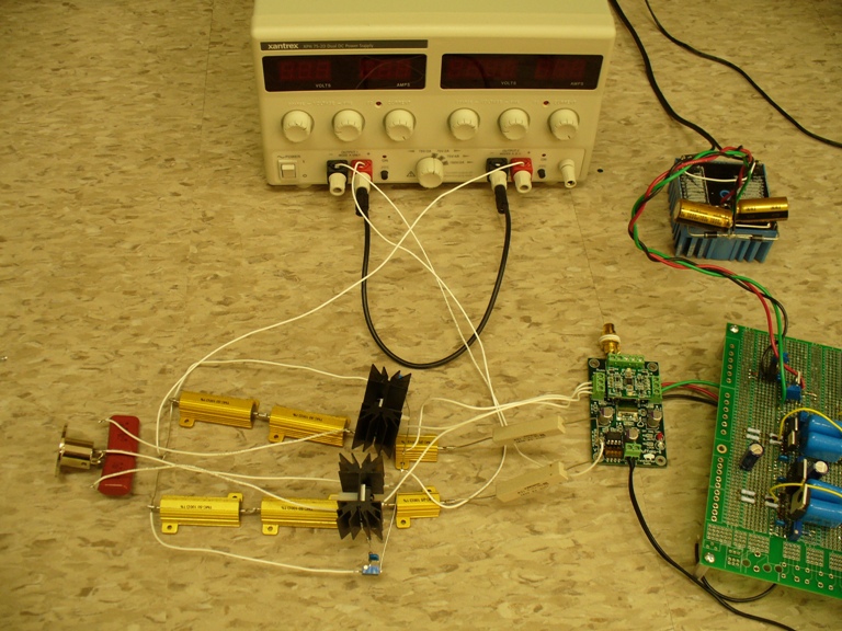

So, I built up one channel using 50W power resistors, and put the mosfets (FQA19N20C) on heatsinks. I used a lab supply for the +/- rails which made adjustments easier.
Sure enough, the higher you go with rail voltage, the better and better performance gets. I'm not talking by a small amount either. I made it up to +/- 75V which gives about 180mA bias current per leg, for a total of 54W dissipation per channel. At this bias level, I was getting -112dB THD+N, and the frequency response was ruler flat out to 80kHz which is as high as I can measure with a 192kHz input.
That kind of performance is phenomenal for a single stage with a pair of mosfets. That's better than most people can do with three $20 op amps and a plethora of supporting circuitry/power supplies. If you have heatsinks, and don't mind owning a DAC that dissipates 100W, then I'd give that setup my full blessing.
I'll post my measurement and some pictures of "The beast" (probably has a record for the world's hottest DAC) later today or tomorrow.

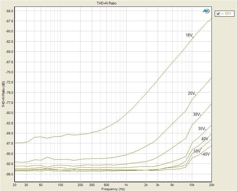

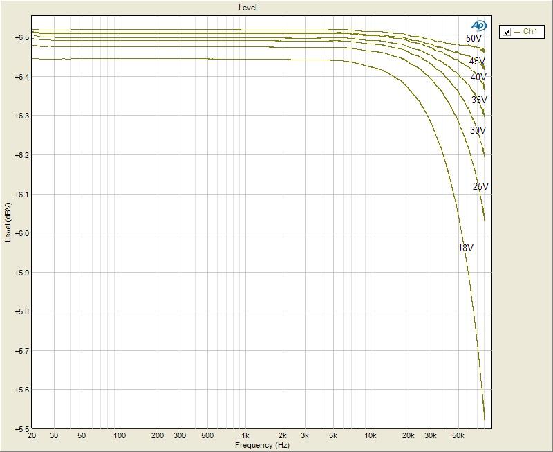

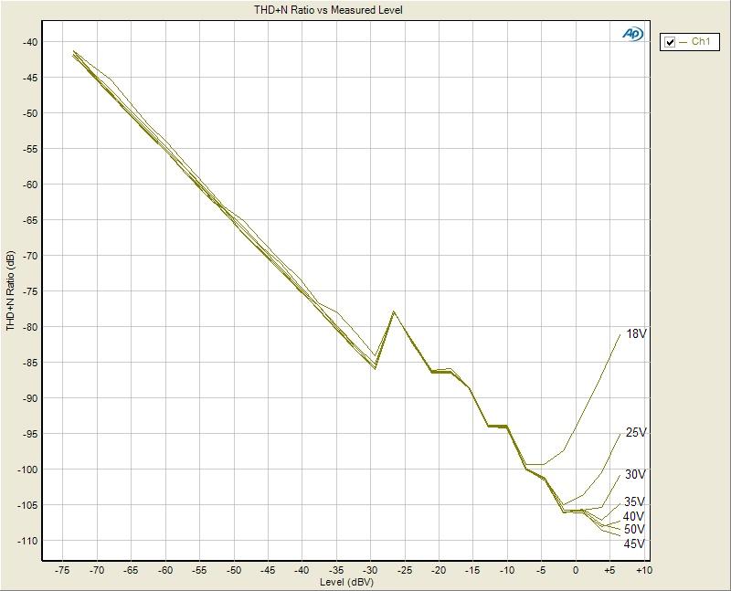

Hi Guys,
Ive got some graphs to post finally, so feel free to take a look below. I also measured several more fets, so here's a re-cap:

What you can take away from this is that you shouldn't use the IRF510, and that you have a plethora of other choices that are good. Looks like the FQA32N20 is the best of this group at 50mA and 10V DS.
As for the graphs, I used the same circuit, and adjusted the rails to various levels, taking measurements at each step. The voltages were 18V, 25V, 30V, 35V, 40V, 45V, and 50V.
As you can see, things just keep getting better the higher the voltage gets.

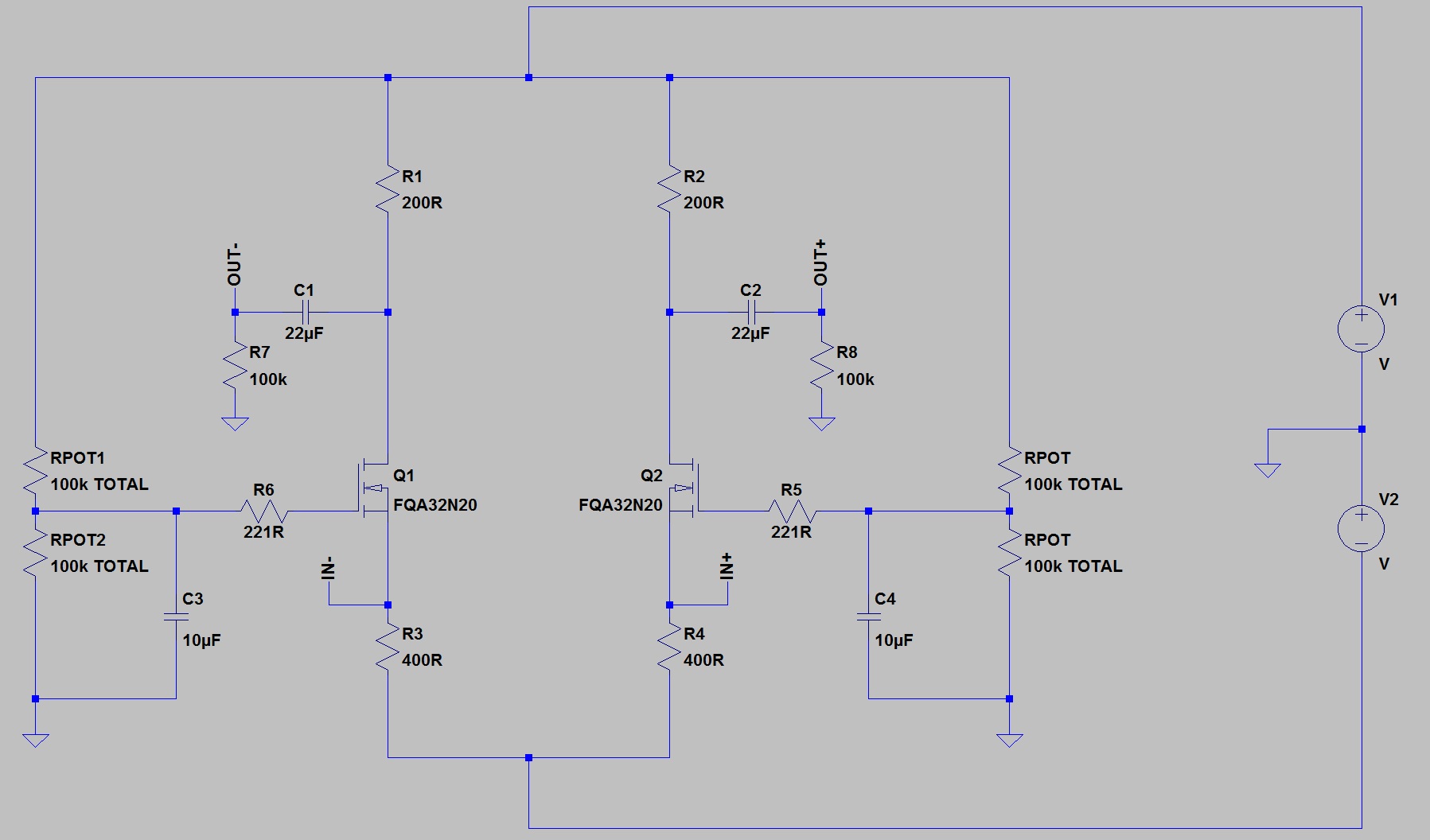

Bob:
The schematic in post #61 is the non-buffered version, and now that I look back, you should omit the 100k resistor across the two outputs before the cap. I thought it would help with start-up transients, but that turned out to not be a problem.
That's the schematic used in the measurements below, minus two filter caps which need to be adjusted.

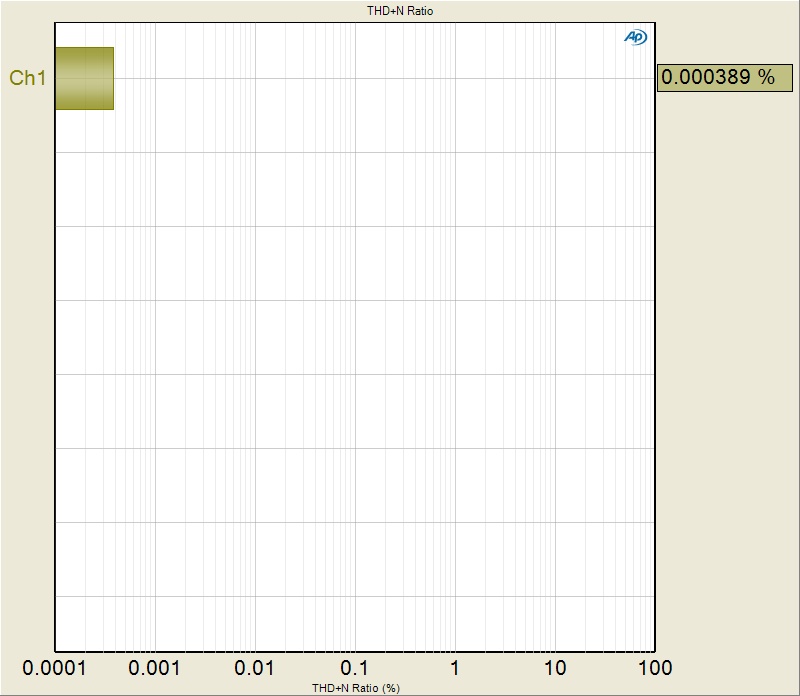

qusp:
Since you already have the 500R and 1k resistors, I would just use those. Note that you'll get twice the gain (4VRMS @0dBFS with the Buffalo II). You'll have half the bias current, half the power dissipation, and as a result performance will suffer by a tiny amount.
The only resistors that need to dissipate power are the 200R and 400R resistors. Everything else can be 1/4 watt or smaller. The trimpots used to set the gate voltage will need to be upped to 100K which is what I used.
The 100K resistors from the output to ground will be needed to prevent the leakage in the caps from building up a voltage on your outputs. Make sure to leave them in.

qusp:
Both the output caps and the 100k resistors that follow them are going to be needed no matter what. Even though the differential between those two points would be 0 volts in the perfect circuit, there's still going to be 25 volts between each node and ground, so unless you use a transformer, you'll need to use caps to get rid of that. I explained the need for the 100k resistors above, so unless you always have the circuit connected to a preamp or amp, I would strongly suggest keeping the 100k resistors.
As for the layout, I'll provide both footprints where it is possible. The mosfets will only be through-hole, and I'm leaning towards PTH Caddock resistors for the 200 and 400 ohm parts mounted on heatsinks, but I'll allow for SMD here too for those who want to build the 18 volt version.
I've attached below what I consider to be the bare minimum anyone would want to go with this circuit. There are no filter caps to induce a rolloff, which means you'll get flat output well past 100kHz. Some find this bad, I personally can't tell the difference with or without the caps. The two 100k resistors are actually just there to represent a 100k pot. This arrangement provides less fine adjustment than the other way, but it omits 2 resistors. It also allows you to crank up the gate voltage, which means you can blow your mosfets if you don't start them at a low value. This circuit is exactly what was used to make "The Beast" and it works very well.
Whatever you do, ALWAYS ADJUST THE CIRCUIT WITH THE DAC DISCONNECTED and then readjust once you've connected it. If you're using higher rail voltage, you could end up with a high or low voltage at the source of the fets before you adjust it.

thx for your hard work
which Is the device measured on graphs
opc
Joined 2004
Hi Samoloko,
The device in the graphs is the FQA32N20. It's readily available, and has the highest transconductance at 50mA.
At some point I'll re-do the TC testing at 130mA and 25V DS, but that will have to wait for another day. I'm sure the results will be different, but I'm not sure by how much.

i'll give it a try, just bought one of those prototyping PCBs like you had in your pic. ELFA has some great ones that have DSUB and IDC connection points at the card edge, so i'll likely make up an umbilical for sensing and power using a HV one I bought, and another that has HV contacts and coaxial mixed in the same DSUB. They are military connectors from amphenol, i'll end up using them in the final build too to keep things neat, if I go with an external power supply and just keep regs local.
the case is quite a decent size, but its getting pretty packed. will get some pics up next week some time. because im testing lots of different things and nothing is permanent as yet, I equipped everything with pin headers and using molex, so the below is no problem, but I will for sure print it out and put it above the bench ;)
