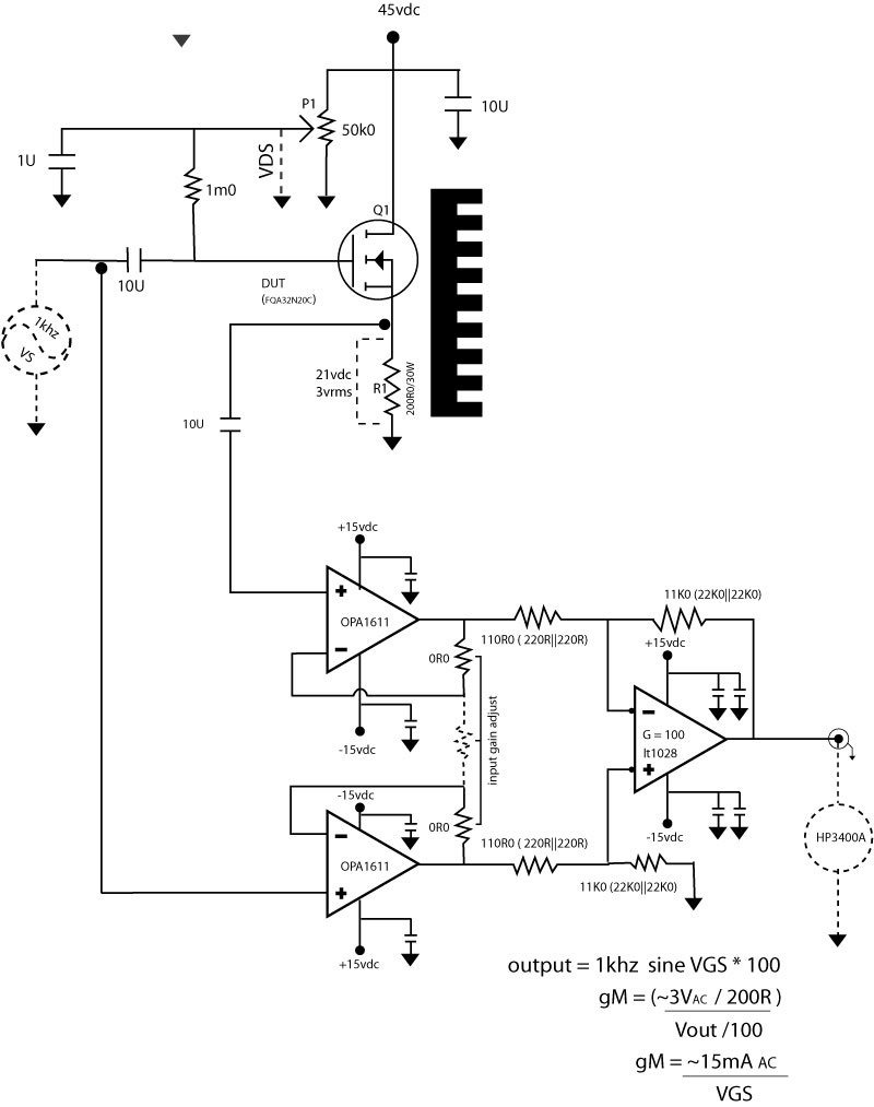

how are you matching them? vds will always be close, but just a reminder they should be matched at the operating point and for transconductance. if you are just doing VDS then i already have plenty matched for VDS, the whole rails were pretty close for VDS.
the sets i sold were matched under the conditions below in a circuit that is basically one arm of the D1, much tighter conditions than what Nelson and some others recommend for power amps

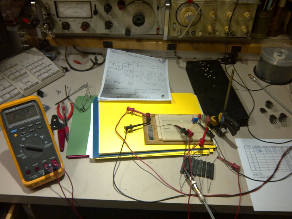

I'm using the transconductance method you posted ealier, and exact the same circuit, as shown on the top portion of your diagram. I'm using 3 DVM (4 and 5 digits resolution, very good Fluke meters), a signal generator and a lab grade power supply. +45V supply, FET mounted on an heatsink using a clamp, Film caps. For the DC measurements, I adjust VR1 to get 24V on the 200R(30W) R1 resistor (exactly Id of 120ma), Let stabilze the FET then I note the VR1 wiper DC voltage. Then I apply a 1Khz, sinusoidal ac voltage at the gate using a 10uF film coupling cap and adjust its amplitude to get 3Vac at R1. Then I measured the Vgs at this point. I calculate the gm using an excel file...I'll post a picture of my setup tonight.
I was surprised to find that the first 5 I tested were very close to each other. Variability is very low, much better than a 2SK170-BL for example.

Hi Algar,
Wow! Great work on the test setup. Both qusp and myself can attest to how much work it is to get it up and running correctly.
It's actually a really great setup for generally testing mosfets, so if you have the option, it's nice to keep it around.
I measured a lot of fets to find the ones I did, but I'm sure there are probably others out there with even better transconductance figures at this operating point. If you have anything laying around, run it through the test setup for fun and see what you get.

I'm using the same heatsink that I'll use for the actual dac, but I'll probably end up cutting it two (one for me and one for my friend). For R1, I'm still waiting after the exact Caddock TO220, hence using a bunch of 8 big WW 25 ohms 30W resistors. They are barely warm after stabilisation. Since we want to measure the FET and not the rest of the circuit, the more stable the circuit, the better are the measurements I guest.
My final testing when matching FET is always to build tha actual circuit, install FET on socket and test them again, insuring that the DC and AC match is indeed correct then I'll choose the pair (if possible the quad) with the lowest THD.

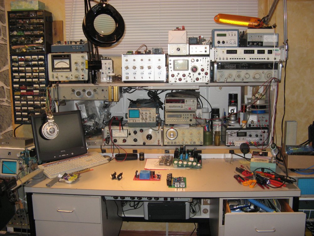

I have an extensive test lab at home that I built over the years, and worked in calibration labs, testing grounds and radar for most of my life.
Testing part for me is just routine and with good test equipment it helps a lot ;) I include a picture of the test bench.
Working for 7 years in a calibration labs, that eventually was closed down (that was the bad part) allowed me at the time to buy used test gears they were getting rid of at ridiculous price. The good part was that I new they were all in great shape. So I lost my jobs but I was able to stock some nice gears. It was hard to buy at the time but worth it over the long run. I have four scopes for example ;)
Here my FET test setup. Nothing fancy really, a breadboard, a few parts and the test bench.
