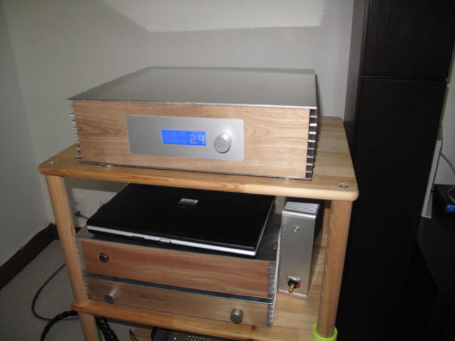

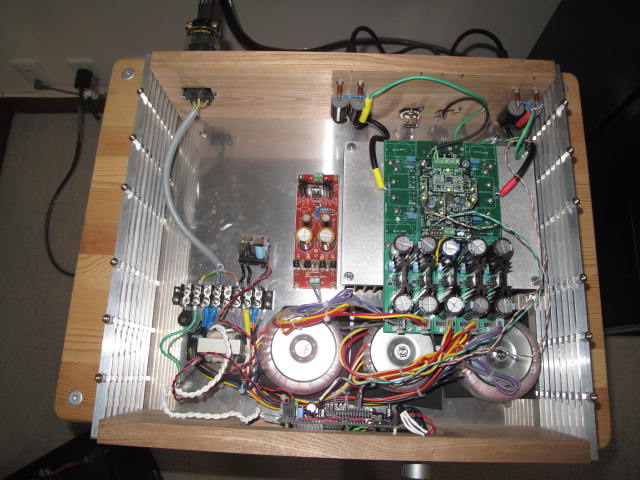

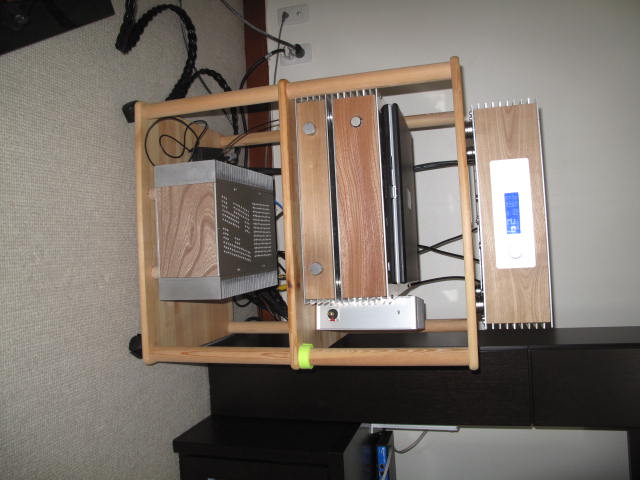

I'm proud of it !!
So this is my almost completed D1. I'll still receive the USB-I2S board and I have to fix better the cabling inside and few other things.
I have a slightly modified version of the hifiduino, that allows me to switch on and off the DAC holding the button for more than two seconds. It also shorts the output for switch on and off transient.
On the same rack there are the AD1865, the B1, and on the bottom the F5.
Thanks to all for making this possible.
