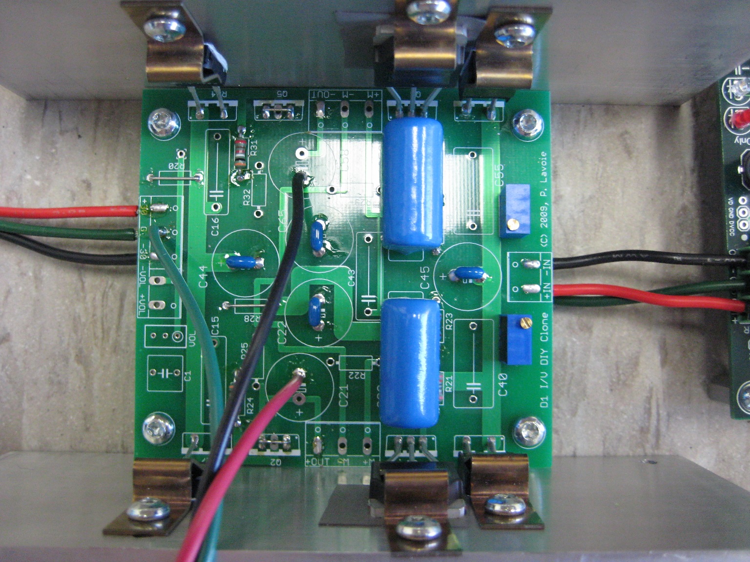

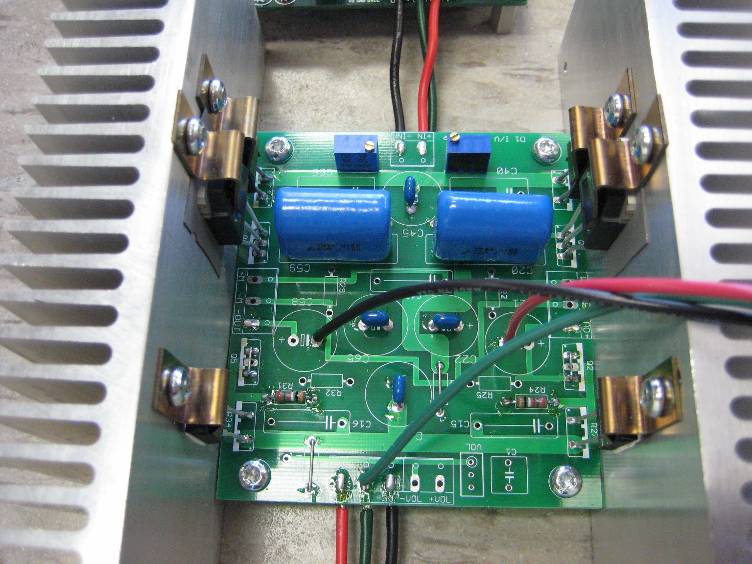

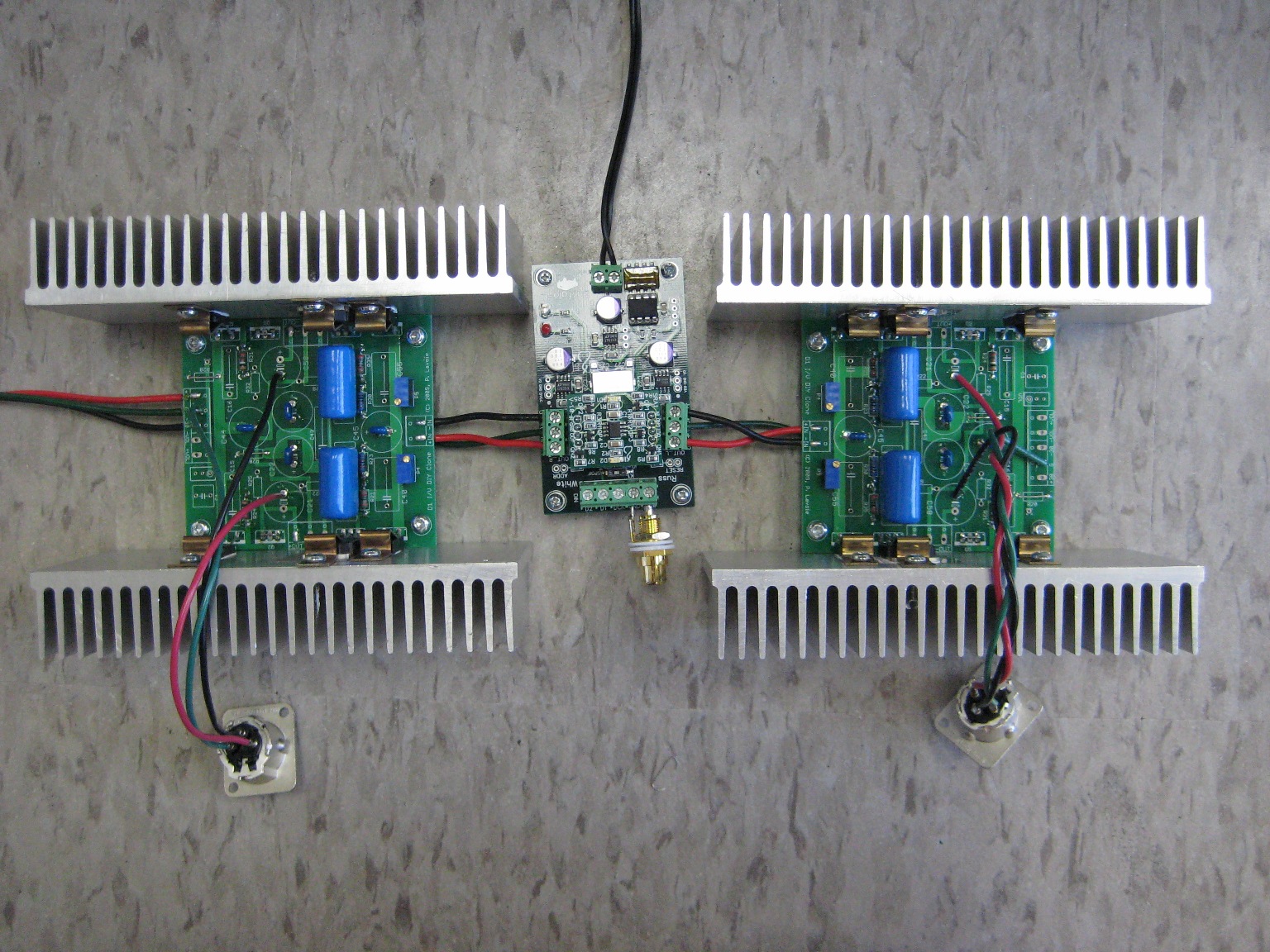

Hi qusp,
As requested I've attached a photo of the DAC as I have it set up on Pierre's PCB's. There are a few jumpers, and the mosfets needed some lead bending to fit in the TO-220 outlines, but it all went together pretty well.
It's not the most portable setup, but it's the closest I've come to a finished design so far.
The final PCB will indeed have the power supplies built right in for the +/- 50V (adjustable if you want lower). I'm also going to toss one in for the DAC itself (5.5V), but using it/populating it will be optional. I kinda want an all-in-one solution that you can just drop the Buffalo II onto, and be finished. I will, however, provide for external power supply tie points for those wishing to use something fancier than an LM317/337.

Hi mate, wow, now thats a mans dac IV :D so no changes to the values? yeah the FQA actually fit quite well with some coercing. pots are 100K yes? so FQR, 100K pots 200/400 and what BOM is the rest following?? the small blue caps are?? the large blue caps are?? and is there any jumpers under the board? oh and where did you get those clips that seem to be for more evenly distributing the heat from the fets and Rs from?

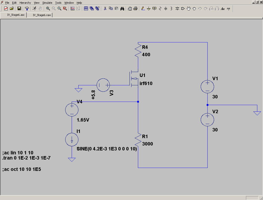

question for simulation in ltspice
Hi.
just playing around with some simulations. I have an buffalo DAC (ES9008)
The data-sheet is not really clear to me. The max differential output-current is 4.2mA and the DC offset is 1.65V correct ? For one channel half of current or ?
thx

it is with 9018/12, I dont have any experience with the 9008, but yes, if you are feeding it 3v3, yep it will have AVCC/2 offset. I take it you are not using balanced output? CMMR should take care of it, still better to sum the outputs in the IV to cancell
