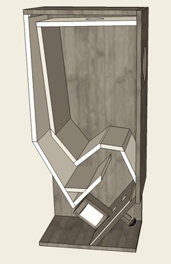

Step 1: take all the dimensions that could be measured in a hornshoppe horn, and then using the same design methodology -- scale the Buschhorm Mk1 to fit a 4" driver -- to fill in the blanks. Martin simmed this and showed that it was substantially the same as the EdHorn. Much later the side of an actual EdHorn was removed. Except for 2 smallish differences we were bang on (in respect of Ed i will not reveal in public, email me if curious). We built 2 pair to confirm functionality.
As early as the drawing phase some changes just made sense. These lead to the original FH1 Level 0 prototypes which debuted 4 yrs ago this summer (VI diyFEST #4). Performance exceeded the expanded Buschhorn. Ron Clarke added more with deflectors, the curved back & the supraBaffle. These enhancements brought bass response from an estimated 75-80 hz to 50-55 Hz.
The actual horn flare (ignoring the Ron Clarke additions), is essentially a refolded expanded BHorn Mk1 (in otherwords much the same as the EdHorn)

This design has a significant air space behind the driver and a clearly defined throat, albeit rather large

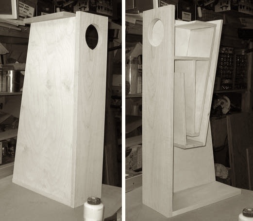

This is gexter's build. One of the features of the FH1 was the ability to have 3 base sizes of air cavity to allow people to easily play with air cavity size, and air cavity treatment. Gex built with the middle size one so that he could do just that. The starting point for the 4" driver is the small cavity of about half the volume.
The opened up picture has the top off. Large throat alludes to the horizontal distance from the baffle to the top, horizontal partition, whereas the actual throat is defined by the vertical distance from this partition to the top.
