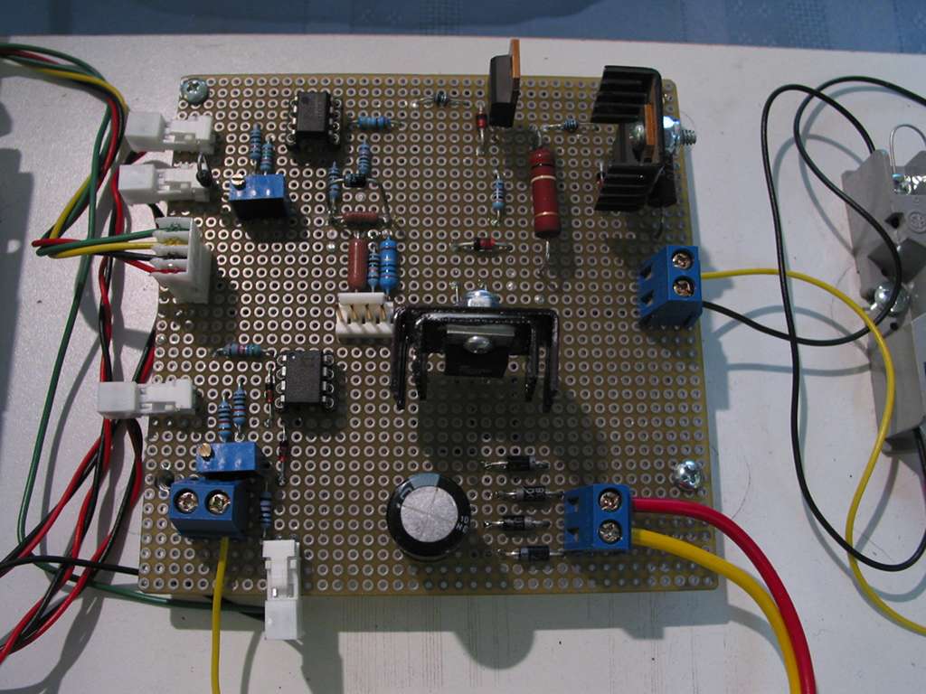

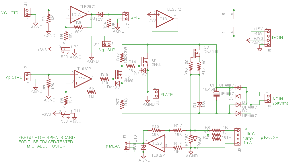

Here is the programmable regulator (pregulator) on my breadboard. It has a 0 => 300V floating plate regulator with return path current sensing, and a simple level-shifted op amp for the -28V => 0 grid supply.
Q3 CCS and 15V zener diode are to generate a negative tail voltage for the common source amplifier Q2. THe ground reference is returned through current sensing resistor R1.
All the operating current for the HV circuit flows between the supply rails and only the tube anode current and the anode voltage divider R9 (1M) current go through the sensing resistor to ground. The cathode of the tube is grounded. The voltage divider current (microamperes) can easily be calculated from the anode voltage and subtracted from the measurement to obtain the tube current only. This is particularly important in the 1mA range.
The floating anode supply consists of a 10VA toroid, FWB, and 10/450 capacitor. The capacitor holds enough charge for the 1-100mA ranges. At 100mA plate current the droop is 10V in one millisecond. For the 1A range a larger cap may be needed, depending on the plate supply voltage margin and the measurement cycle time. The regulator holds the plate voltage constant as the capacitor voltage droops as long as there is some voltage headroom.
I had 200 KHz oscillation until I switched from a TLE2072 (high performance TL072) to a TL062 in the plate regulator. I think some high performance op amps are barely unity-gain stable and if you add an external gain loop of less than one in the feedback path they go unstable with no way to compensate.
I'm putting a project page together for this and will post a link when it's up. I think I'm going to go right to PCB design of a bipolar-capable regulator so I can start some real tube tracing.
Oops D8 is 14V...
Oops D8 is 14V...
