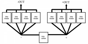

russ this component setup is great. now, how many of your output lm3886 boards do you think can be strung along before the input devices need tweeking. would the control and power units handle 8 lm3886 chips in a mono configuration without overloading the control and power supplies. that would yield about 400 watts to the speaker. ie, 4x4 parallel then bridge for a total of eight. i currently run two line arrays with 20 3.5 inch drivers in each. as i add power, to a limit, the overall sound is improved dramatically. are boards ready to ship currently. anxiously waiting to get this project in high gear.
tryonziess said:russ this component setup is great. now, how many of your output lm3886 boards do you think can be strung along before the input devices need tweeking. would the control and power units handle 8 lm3886 chips in a mono configuration without overloading the control and power supplies. that would yield about 400 watts to the speaker. ie, 4x4 parallel then bridge for a total of eight. i currently run two line arrays with 20 3.5 inch drivers in each. as i add power, to a limit, the overall sound is improved dramatically. are boards ready to ship currently. anxiously waiting to get this project in high gear.
The TXD could easily drive 8 LM3886s at 100K input impedance each. The TXD should be good down to a load of around 600ohms easy. So you could theoretically drive something like 50-60 of them Not that you ever would...
You actually should be able to do more than 400W with just three in parallel for each half channel. So 6 LM3886(TPM modules) per channel. Assuming your PS is capable of supply the current. The TXSPS would work just fine(one per channel) but you would need to calculate the trafo accordingly.
