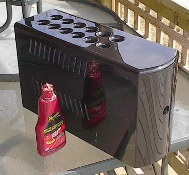

jbateman said:Has anyone found a waterborn gloss black paint that they like?
I used this waterbased urethane paint from Sherwin Williams.
Very amazing stuff. Tough and ultra fast drying (5 minutes on a warm day in the sunlight).
Very thick in the can, so you need to reduce (with water) about 40%. It sprays smooth at higher pressure (65-80psi). Sanding is easy and doesn't clog the paper.
Tintable in a wide range of colours.
Results, colour sanded and polished, no clear coat:
Wow holy cow that looks incredible! forget all that lacquer crap!
Low VOC and looks like its tough as hell as well!
"Formulated specifically for industrial and commercial flooring applications"
nice!! thanks for posting that!!!

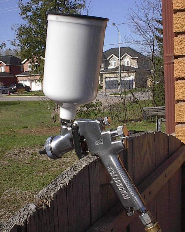

I use a $120.00 Campbell Hausfeld gravity feed sprayer. Before I bought that, I had a siphon feed like the Husky. All I can say is there was a world of difference between these, and I wouldn't bother with a siphon feed again.
My compressor is a tad undersized for spraying (2hp Dewalt twin tank portable). Really, with fast drying paint, you need more air to avoid dry overspray.
The case in the picture above is made from MDF and HDF, not metal. I have used it on the baffles of a pair of speakers also.
The spec sheet for this doesn't even recommend spraying, but it sprays very well. The reduction is needed - it's just too thick in the can. Besides, the thinning doesn't seem to affect it.
The clear I have not used, but I would think it has the same performance as the mixed colour.

At last Summer's Vashon Island meet John brought his "Purple Puppies", which had a beautiful bright purple finish that was universally praised for the quality of the finish. I don't have any decent photos of those unfortunately.
The moral is, at least with sold colors, you don't need to have an expensive spray rig to produce an outstanding finish. I might add, that the Classic Cars (Packard, Cadillac, Dusenberg, etc.) of the 30's seen at the auto shows, all had their original paint jobs done with a brush and a "lot" of polishing.
Try it out on an old junk speaker and see for yourself
