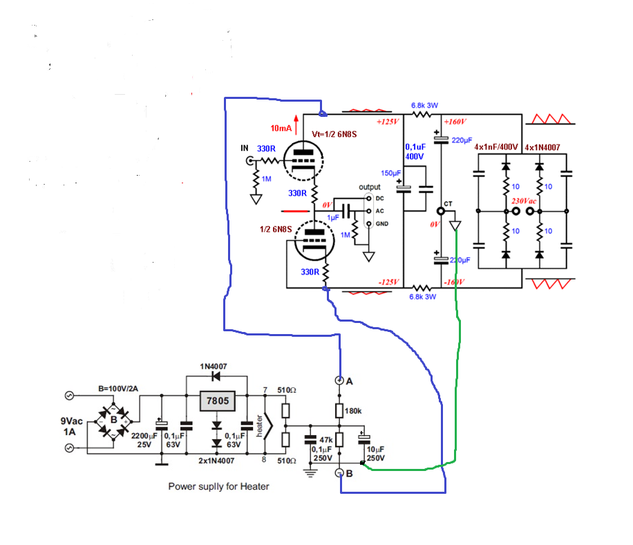

Hi Sy and all!
For this schemetics to connect the power supply to the heater and power supply catode tube follower on her well done differently or should that be done?
Thank you for your cooperation and assistance!

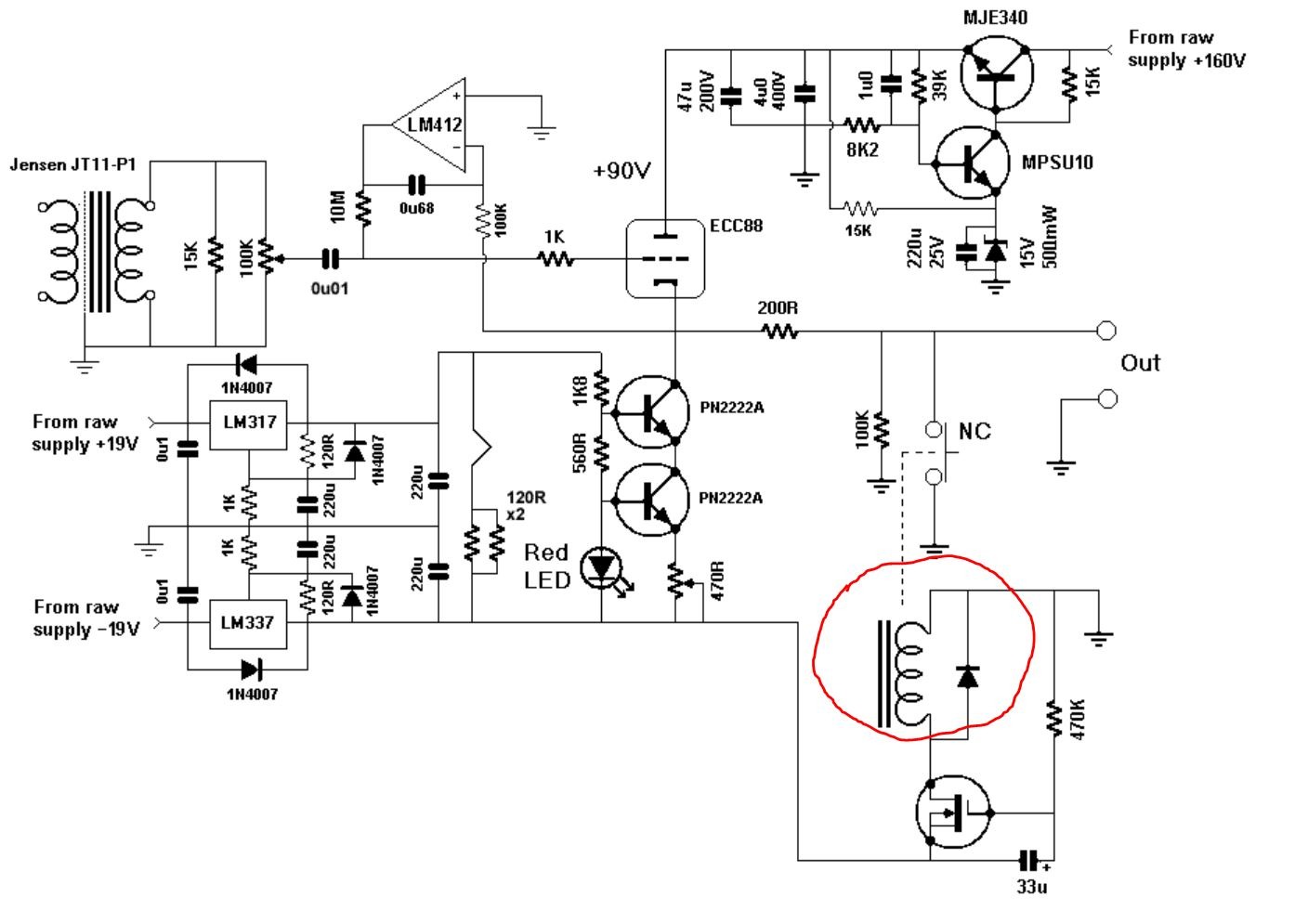

Apologies for raising this ancient thread from its long sleep. I am interested in building this preamp because I too have messed up grounds, that I also can't control, and that result in super quiet amps when shorting plugs are inserted, but always some sort of hum or buzz with any source. I have the required input transformers and all the tube stuff needed (and then some), but not the solid state stuff in the schematic. Would anyone like to help an old fashioned tube head by suggesting available replacement parts for the no longer available solid state elements included in this preamp? I read SY's article on his website, and he said that some of the choices he made were non critical, but I don't know much at all about transistors, and am feeling anxious about what to replace the discontinued parts with. I promise to build this preamp and post my progress here if I can get appropriate replacement parts for the solid state stuff. The parts I can't get are MJE340, MPSU10, and LM412. I suppose I could skip the power supply portion and go with more RCs or LCs. I have lots of both on hand, but I may as well do it all. Also, there is an inductor that is not labelled in the schematic (circled in red)...

The part you asked about is a 12 volt relay.
However as the schematic would receive a failing grade from my friend who teaches drafting, I suspect that although the design would work, there may be significant issues following it properly.
As to the relay you would need, not shown on the drawing is that it should have gold over silver crossbar contacts intended for audio use.

However if you do not or cannot fix it, then the only part you require is the audio isolation transformer. The circuit as shown is probably not doing what you seem to expect.
If you want a bit of gain or impedance matching just use a different transformer.
