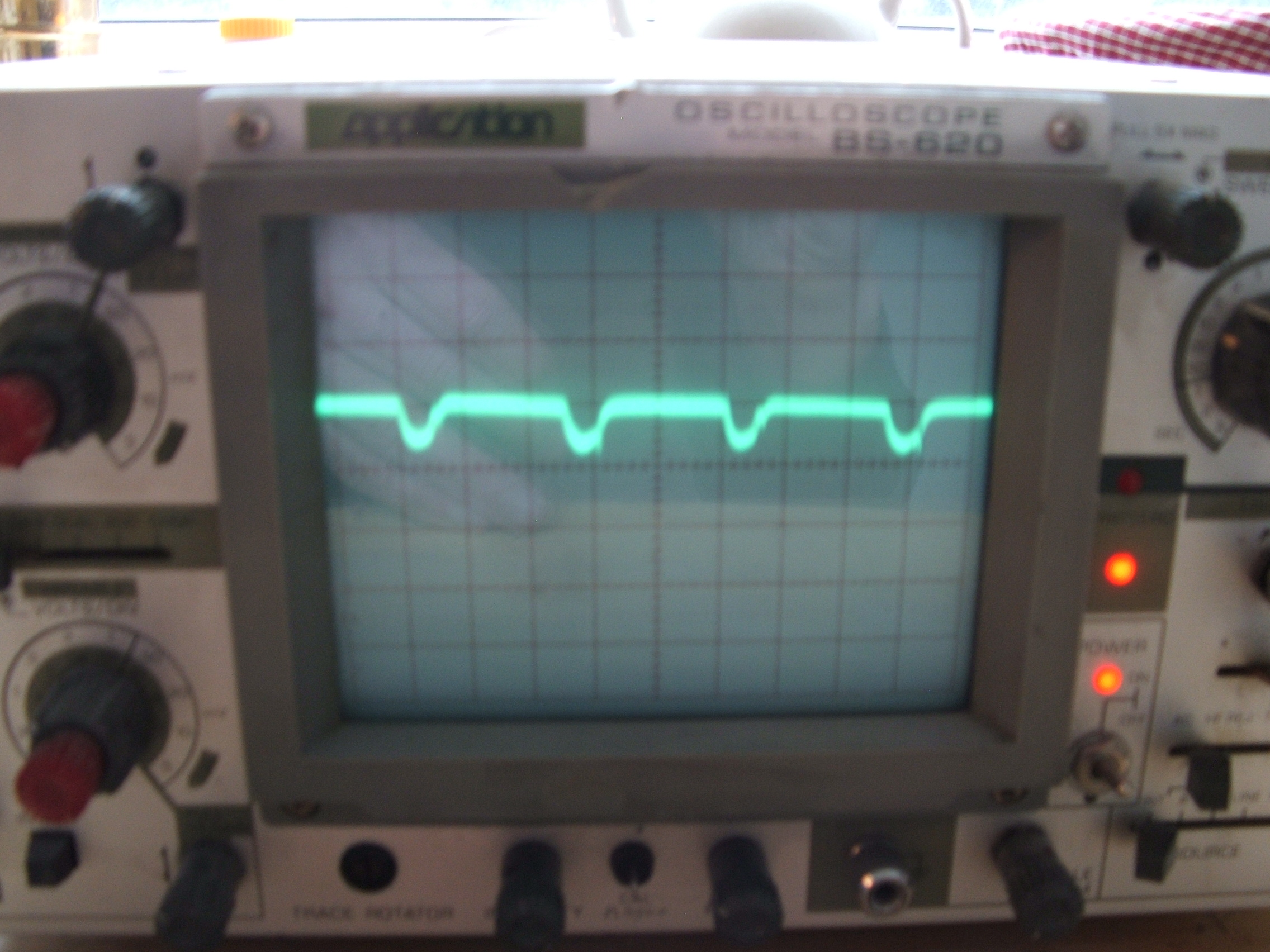

Just to see how this actually applied to my case, I connected the ground wire of my scope to a wire soldered to the 0V trace on the capacitor bank PCB (or area), and I then touched the positive probe on the three different connection points for amplifier 0v (one for each card)
I could measure some noise, relatively simmilar waveform for all measurements but amplitude varying from 0,8-1,5mV
I allso measured between the 0V points them selves and that yielded results along the same lines..
To verify the measurements, I attached ths scope grounding clip and probe to the same point at one of the 0V terminals. That gave a flat line on the scope.
So, 0V potential is not even across the capacitor bank and the connection points, this is now proven and quantified I think.
So from there on, is the magnitude of these measurements significant?
Is it an explanation for the issues I have, or is it an insignificant detail? I have no past experience to judge this by, so please chime in.
I don't mean to be going on here, just wish to make sure I understand what is actually going on in my design. As it is a bit o9f a pain to modify/ rebuild the PSU, I need to be sure that the theory matches the reality.

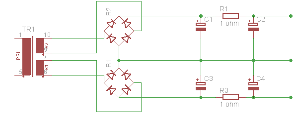

I've started to think about practical solutions for modifying my PSU to a "conventional" design with proper connection and ground points that will elliminate charging pulses etc as a possible problem.
The obvious solution is to connect the two secondaries with a center-tap and use one rectifier.
It should however allso be OK to have each secondary feed a rectifier and then connect 0V downstream of the rectifier. as this solution is described in Bob Cordells amplifier book, I guess it should work.
I have two practical issues. The rectifiers I have used is rated a bit too low.
Allso, I donæt have much room for installing a higher capacity rectifier which is inevitably physically larger.
Going with a conventional single or dual rectifier PSU design, is there anything that should discourage me from using 2 or 3 rectifier bridges in parallel? this would of course mean connecting them together with the capacitor bank at ONE point, not several as I understand that this wouild cause charging currents flying all over the place.
Elbert; Testing your O volt points with a scope is no good, the ground lead on the scope is GROUND and will mess up your meserments unless you isolate your scope.

Perhaps I was not too clear in my explanation of the measurement.. I simply used the scope to measure voltage potentials between different spots in the 0V architecture, not relative to any other ground. The fact that I didn't measure anything when measuring on the same spot as opposed to two different spots should verify that the measurements are OK.
Yes, I can se that bolt acting as an electro-magnet, a good way to put it!
So, I've done a schematic on a possible new power supply..
Here I've only used one pair of rectifier bridges, but for current rating I would like to use perhaps one bridge each in parallel to B1 and B2, yet wired exactly the same way.
I have not placed the supply terminals at the same point as the connection points of the bridge rectifiers.
Rather, the rectifiers are connected to one "bank" of capacitors, and that bank is then connected to another capacitor bank through 1 ohm resisitors. from that second bank, the suplly to all thre amplifiers are then taken.
This solution is possible for me to physically realize and to the best of my understanding, it should be according to "accepted and proven" principles, as described both here and in Bob Cordells book.
Should I go for this???
I am puzzled why you are using two bridges when one will do the job? Connecting bridges in parallel will not achieve anything unless you include balancing resistors.
Regarding your tests, you have now seen how two places connected by a thick piece of wire can still be at different potentials. This is the essential insight needed when designing grounding schemes. Any other grounding route joining those two places together will carry current, because of Ohm's law. It may be mA, instead of the amps of the direct route, but still enough to inject hum.
Note that the 1 ohm resistor in your cap ground connection could, with advantage, be replaced by a piece of wire, but it will help if you still think of it as a resistor.

Two reasons I have 2 rectifiers in the schematic;
1:
The rectifiers I have are only rated for 10-15 amps, so just one is pushing it considering I have a 600 VA toroid and 120000uF worth of reservoir caps.
2:
I read this in Bob Cordells book:
"An alternative arrangement employs two secondary windings and two bridge rectifiers (as shown in figure-same as my schematic). One possible advantage to this design is that it avoids the circulation of direct current through the transformer windings when the positive and negative rail load currents are different. The flow of direct current through the transformer windings should be avoided, as it can degrade transformer performance and sometimes create transformer buzzing.
Toroid transformers are more sensitive to this effect than transformers of conventi0nal construction.
The rectifier current pulses for each half of the supply do not circulate through ground, but rather circulate locally. This may improve management of rectifier noise. Indeed there is no direct connection of the secondary windings to ground."
So, if I can gert sufficient rectifier current rating (using components i have), and get the possible benefits, there seems to be no drawbacks, I figured why not?
Regarding the 1 ohm resistors, this is to acheive a so called "split reservoir capacitor" solution, allso described in Bob's book. It says that it can have a " remarkable effect on reducing ripple and noise content.
If remarkable effects can be had for the price of two resistors, I'll take it

The scope measurement sure gave me a valuable insight, one is not used to the concept of local current and voltage differences inside a "local" conductor envelope like this!

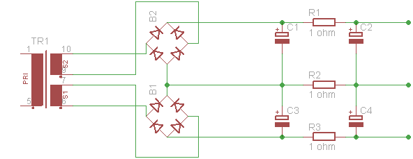

I made one mistake in the previous schematic, the resistor between the first and second capacitor bank 0V was not supposed to be there! Sorry!
