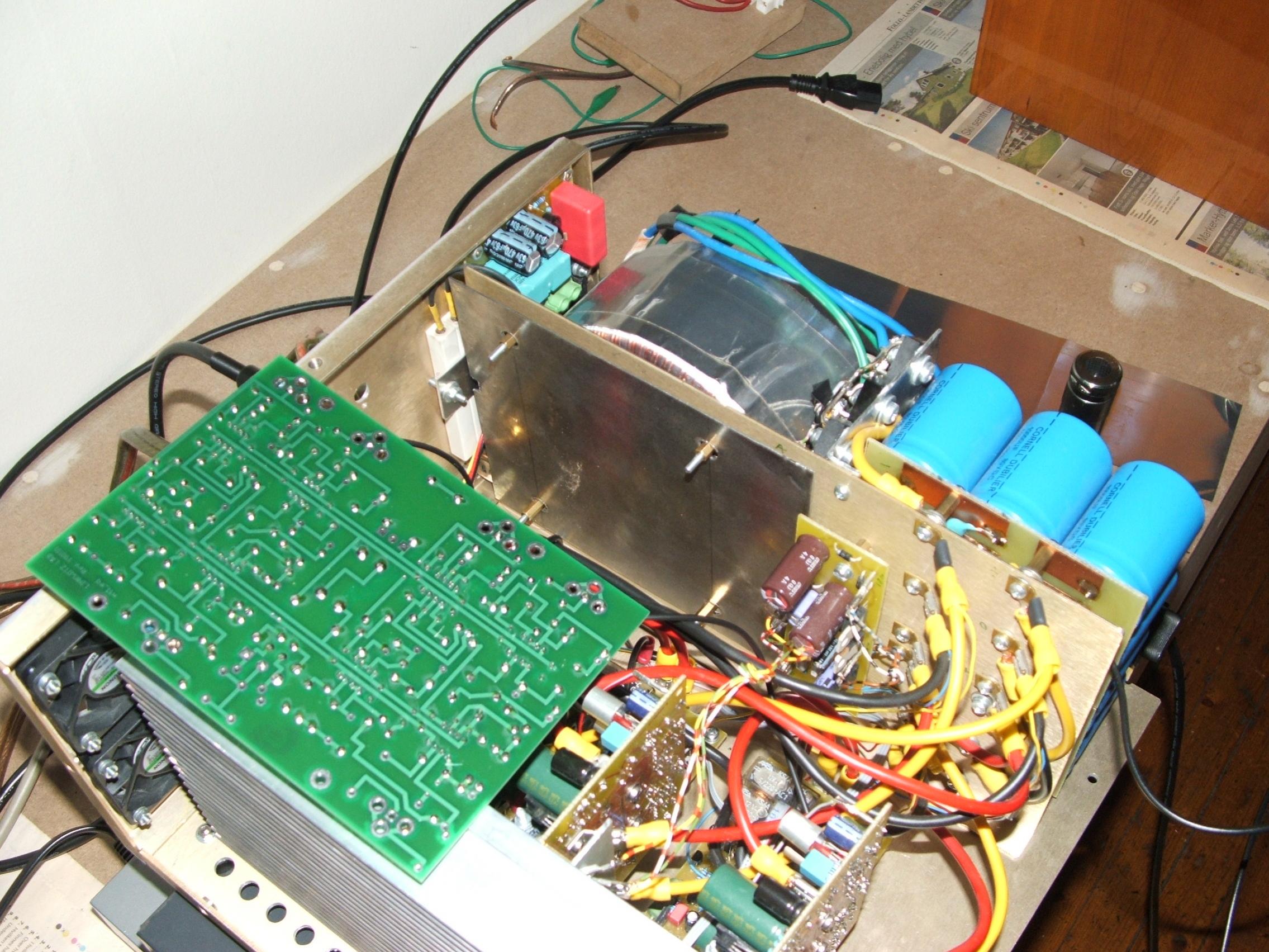

Looks like it is going to be very tricky for me to enclose the Toroid, so I'll go for placing steel sheet between the toroid and the x-over card..
But what would be the better strategy?
One thick plate of steel or several thinner sheets stacked? Or is it only a matter of thickness irrespective of sheets/ layers?

I would try replacing that bulkhead between the PSU and the rest with a 6mm or 8mm thick steel plate. Insulate as necessary.
The plate should be a close fit at all the edges where it meets the chassis.

Got one steel plate ready and in place.
It did reduce the hum with about 2 dB, so not so much as the strip of mu-metal which reduced hum by about 3-4 dB even though it was not as large as the steel plate.
As I have the steel available, I'll try adding a second steel plate as well.
At the end of the day, I'm tempted to order another sheet of mu-metal. If I stick that to one of the steel plates covering the complete area, or perhaps both, I should, based on the experimental results so far, get a fairly good result.
As it is now, with both the steel plate and the strip of mu-metal, the hum in the speakers are not much louder than the physical hum emitted from the actual amplifier.

Just got the second steel plate in place, and that yielded about another 1,5-2 dB reduction of hum, so all in all, with two steel plates and a strip of mu-metal the hum in the speakers is reduced by about 8 dB.
This is not too bad, and I guess with some additional mu-metal (just ordered a sheet), it might yet improve a bit.
Now, it seems that this is getting close to how much I can improve things with this approach.

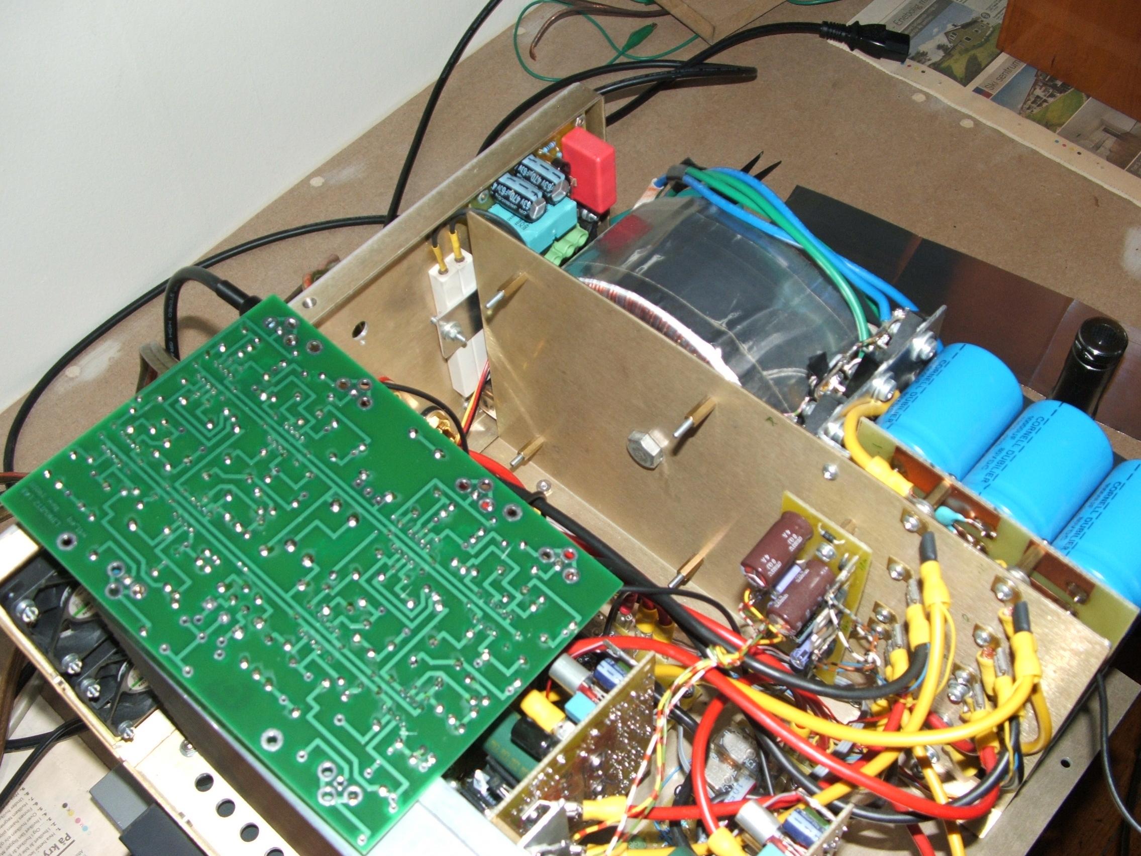

Moving the pre-amp allso removed the hum from the pre-amp, so apparently this was the amplifier transformer inducing some hum there.
That should allso rule out any sort of signal/ ground issue between amp and pre-amp.
I have not rotated the transformers as there is little room to do so because of the wire routing.. But I'll see if I can manage to do it, should it give a noticeable effect, it is well worth to adjust the wiring layout of possible!
Having said that, the transformer primary and secondary wires exit on the side facing away from the rest of the amp, which I understand is favourable.
