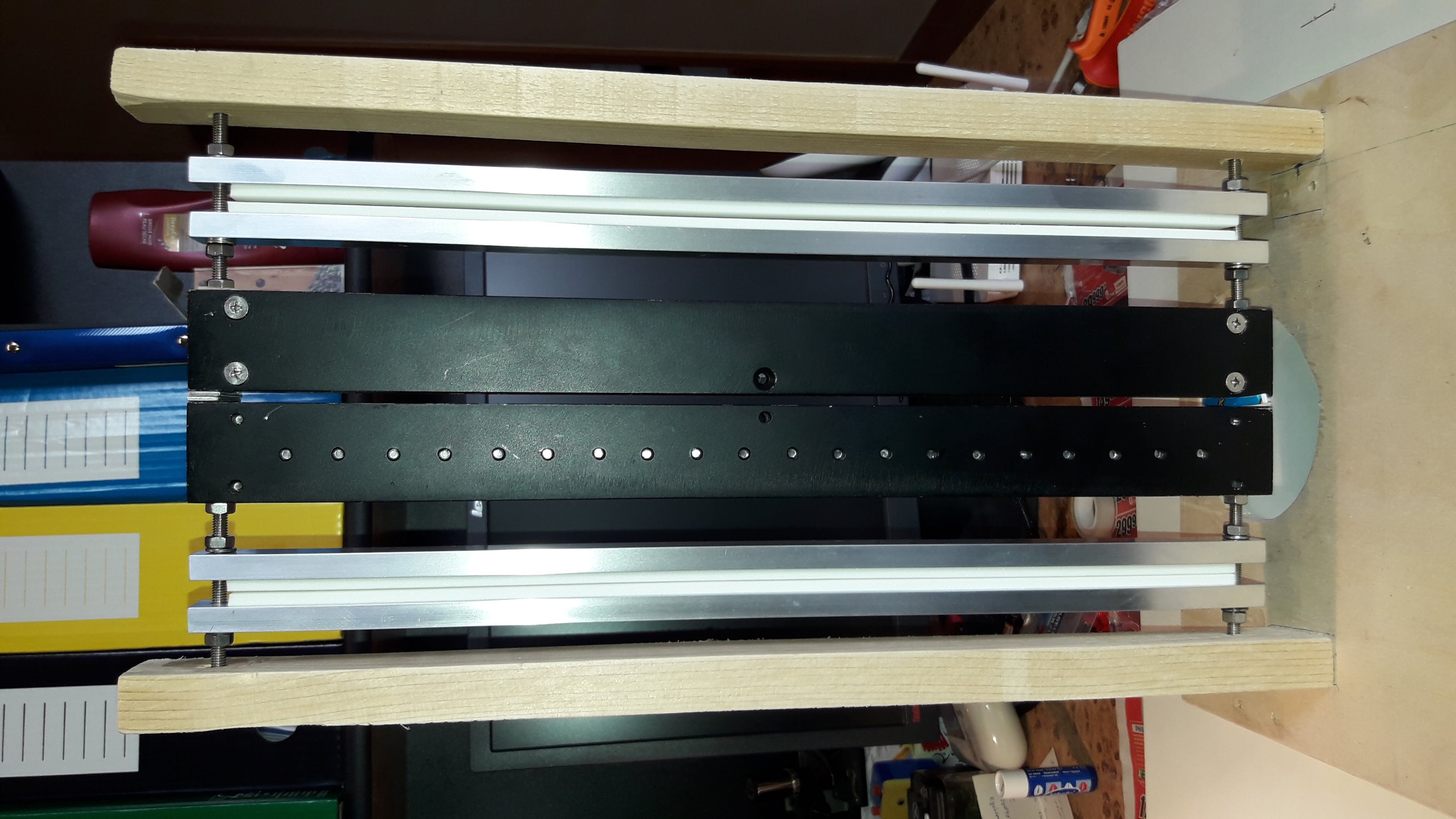

Hello Guys,
I’m following your thread for 2years. I decided to make a ruba. This winter I finally started the project.
- 40 pcs Chinese ali magnets 40x20x10 (39x19x9.6) with holes fixed with screws
- S235 45cmx10mm steel bars
For coil I’d like to use 30um alu tape cutted with vinyl cutter knife on DIY cnc. My friend is playing with his machine try to cut the alu tape (knife from ali too).
I can’t wait longer and I make a coil with 0.28 mm diameter copper wire. 14 turns x 2 coils connected serial. Resistance 7.8 ohm. Glued with epoxy to Canson paper. Weights 48 gramm. (1 empty sheet 125g/m 15.6g calculated, measured 16g). So it became heavy. At least I heard ruba playing today.,

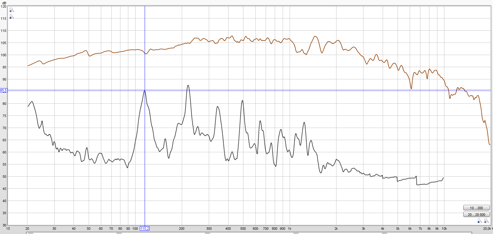

No surprise, there is no highs. Low freq response is quite flat. (it has more bass then my 4” fullrange closed box)
I have big resonances at 115Hz and above. (double, 3rd etc.)It is visible, audible and the distortion chart shows them.
Do you have idea why I have this huge vibration/distortion, how to avoid?

Hi Borzi and congrats for the project. It really does look nice and very promicing.
The huge vibrations may come from the wires comming from outside the coil to the fixing rods (or where you solder the fat wires from the amp) due to the huge magnetic fields generated by the motor. Keep them as far as possible from the plates and magnets.
If you are talking about vibrations and distorsion then check the coil because it may be rubbing on some particles accumulated in the gap or its rubbing by the plates because it may be uncentered well or it has bended because of the humidity. The canson is very absorbant thats why i treated it for antyhumidity. ( it may bend at the center even if you centered it well)... This is another reason for wich i recommend the cuts (other than hight frecvency improvements), because you can very easy detect faults, bends or metal particles...

nice dude ! might be rubbing ? but at the same time paper starts to act weird down low where the thing acts more like a piston (or at least tries to) maybe some dampening? some heavy pieces of foam tape or anything. only the center plays high freq, you can do whatever with the rest of the thing in terms of adding stuff/weight.
greetings from the netherlands !
oh yeah serg forgot about that, the wires can make loads of noise try finding that frequency in REW put it on and start hunting it down.
Good point my friend Wrine, Borzi you cannot go fullrange with this size... The membrane will be blown outside the gap like cannons do (tried this).

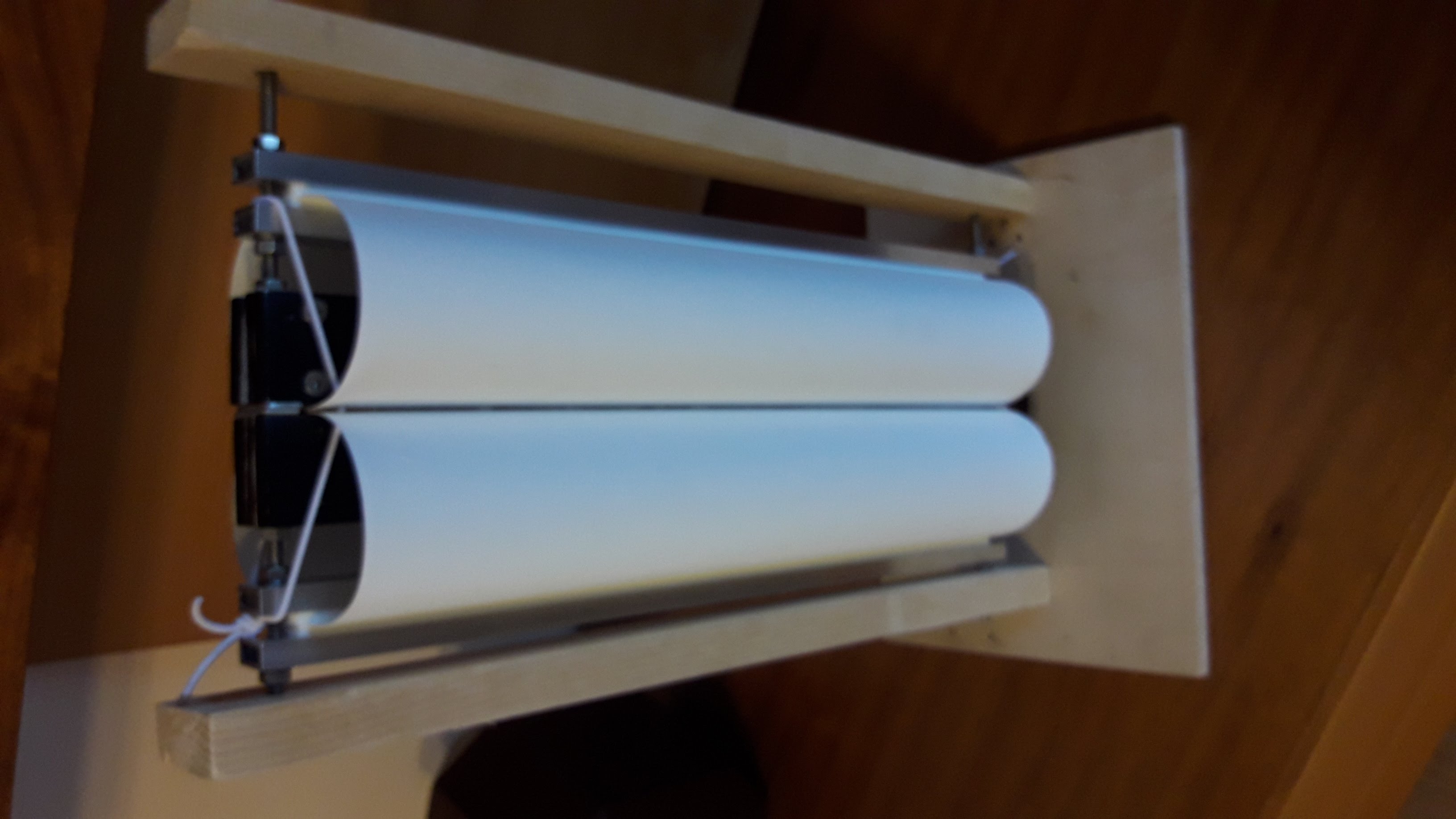

Thanks for the comments.
Yesterday I try to find the root cause of resonance.
Without success.
Modified rubber band, change foam dumping on side to more softer.
Modify the width. (more butterfly or more round)
I think the problem is: I not perfectly glued the coils and the to half to each other.
I have 0.2 mm copper wire maybe I will make a trial before the alu foil coils will be ready.
My friend told me seems he is able to cut them whit his machine with the Chinese vinyl knife. He fixed the alu tape with 2 sided tape, and the cutting works.
He just convert the latest wire design what I draw in Inkscape to his machine.
I have Xeros never tear 95 um 125g/m2 I'd like to try this as well. Not necesarry to impregnate.
This material feels 50% thinner then similar weight Canson paper.

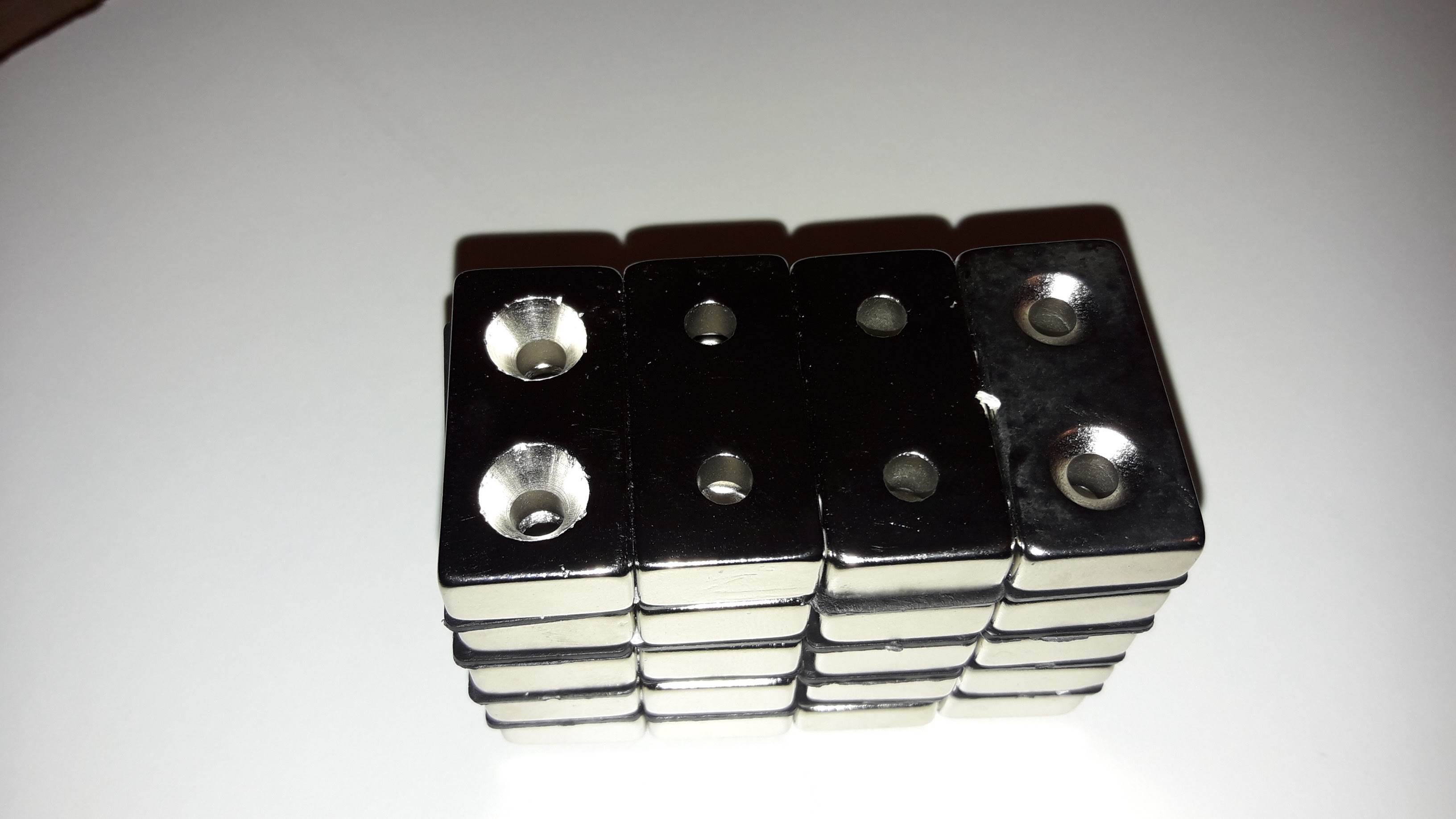

Hello Olegsan,
Of course the screws are non magnetic. (stainless steel)
The motor feels enough powerful with screws.
I get magnets with holes, because I found them cheapest. (40 pcs N50 40x20x10 magnets 87 USD)
The sound pressure with 8 ohm ruba and my 4 ohm closed box with same volume settings sounds approximately same.
So I do not think I loose too much magnetic force due to the screws and holes.
I will make later calibrated sound pressure measurement to see the real sensitivity of rubanoid. I can borrow a calibrated sound pressure meter.
