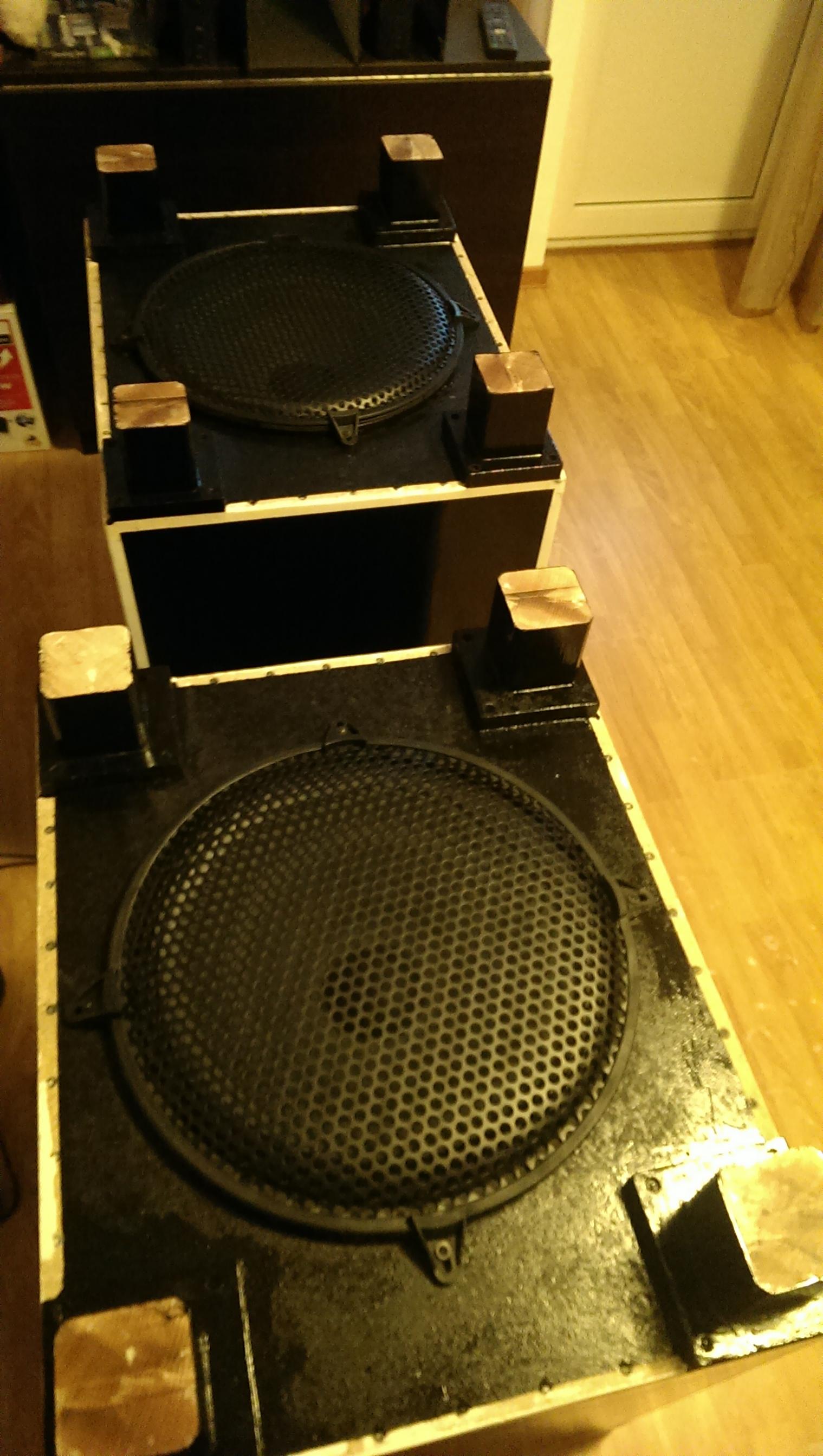

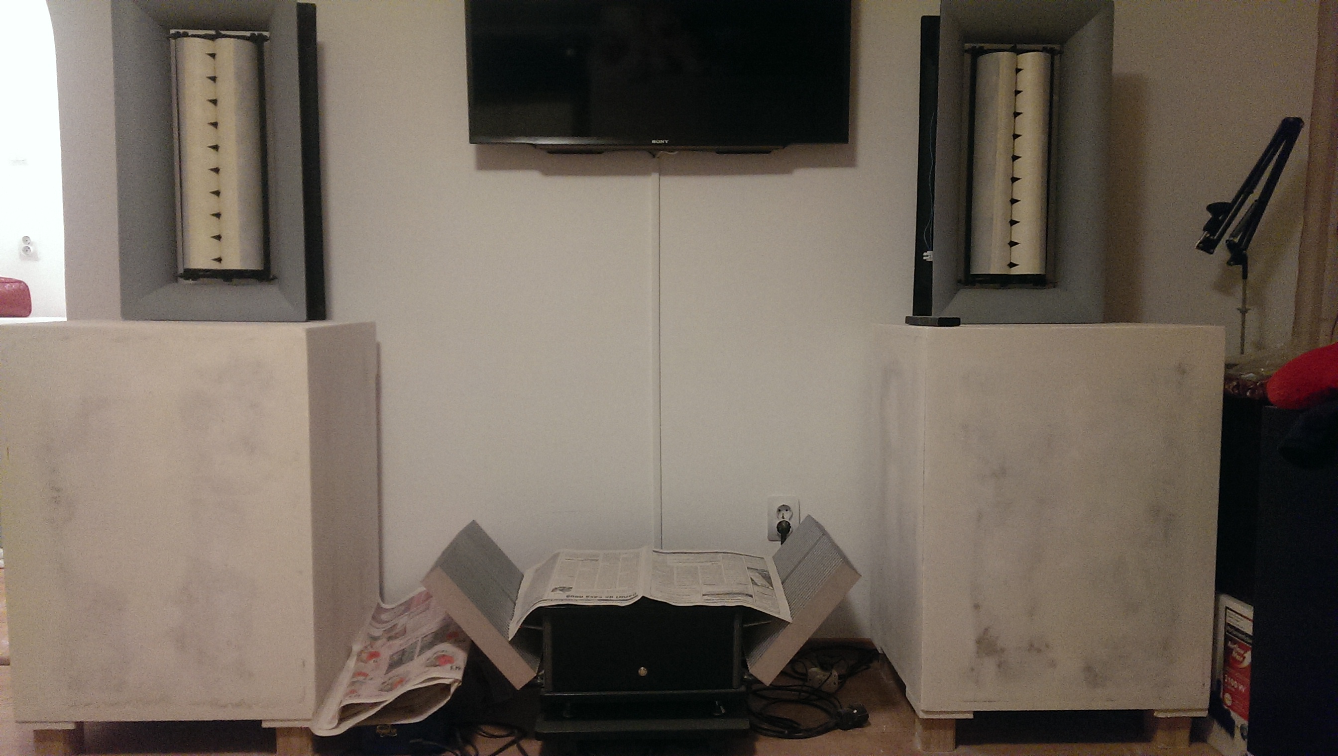

I do not know if it's good with the bass speaker facing the floor. The speakers must be coupled to the floor, but in your case the pressure that is formed will push up the speakers. A mp3 bass test from youtube show you what I say.
Thanks Vlad,
You are perfectly right and i know what you are saying, but that is the case for bellow 6 cm (the bass was insane and making me sick and the woofer membrane was moving hard). I measured it and listened and readjust and then fineadjust.. After a couple of trial days i came to the 10cm sollution. Look at support feets, they are 5 pcs made from 2 cm plywood (i dont know how its named in english) resulting10cm. Now, at 10cm, the woofer membrane its barely moving when its facing the floor (about 1 to 2mm maximum from a total of 5mm xmax) at half volume (19w) on an youtube bass test, it looks like it moves like its upfiring. Now the bass is just perfect for my listening sessions (i love especially live concerts, jaz, vocals, opera, vocal trance and rarely som rap).
Vlad, your observation would have been good if i had posted what i wanted to do from the begining and asking some advice...it would have saved me allot of time (no kidding).

I shure do. I cannot go higher than 10-15w without being in the other room or with some cottone in the ears. :) Normally i listen to 2-4w in the afternoon and night and 4-10w max in the day when its noise outside. I dont like to listen to loud music...
Those speakers of yours Wrine are indeed something. I just love them. They sound gorgeus and that is the music that i like most. Cant whait to see what encloshure you make for them.

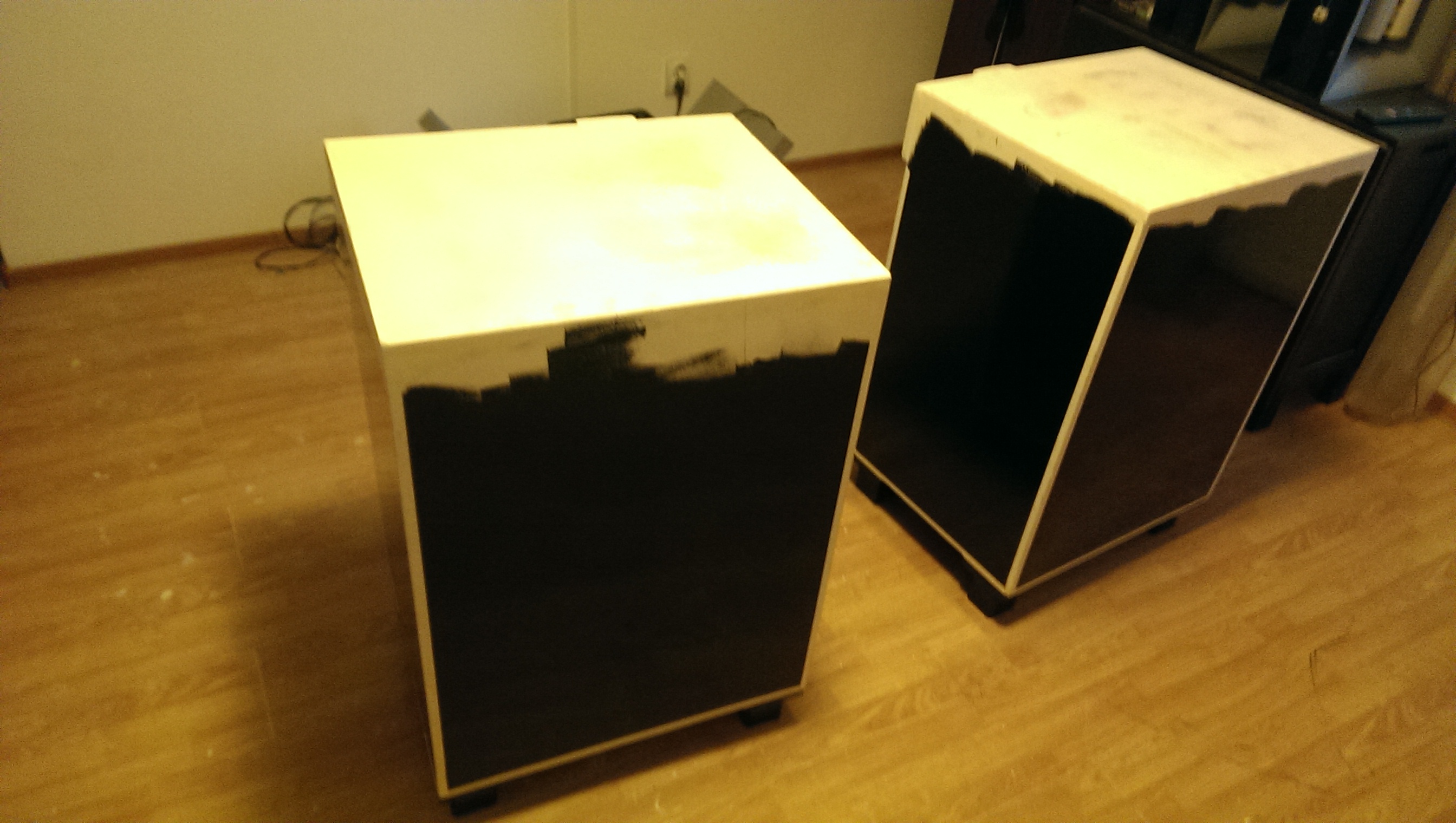

Here they are. The bass speakers are almost ready. Still have to wait to completely dry. I have used enameled black this time. Looks pretty good, better than the pics are showing. Still waiting for the other components to arrive from different suppliers.

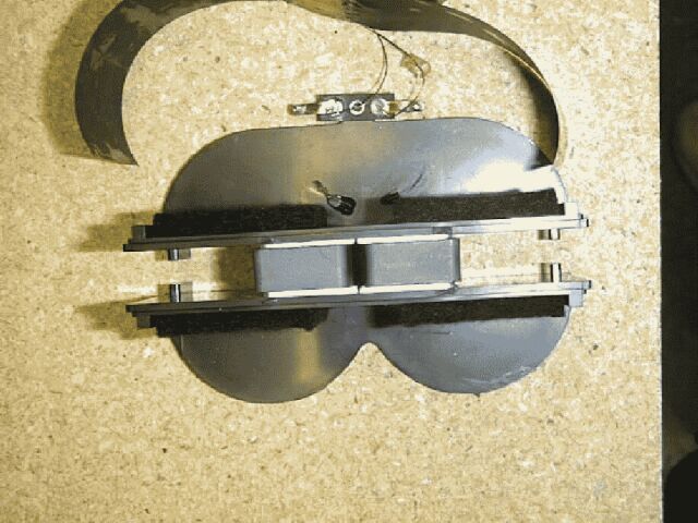

Hi Olegsan,
Yes you can, but then you have to take into account that you have to optimise your metal plates accordingly to get a sufficiently high flux for high efficiency. As an example, please take a look at the pic that i posted bellow from the net with a disassembled Lineaum tweeter (wich is practically a small rubanoid speaker).
Here you can see how thin the plates are to get sufficient efficiency with smaller ( inevitably weaker) magnets.
In the past i have tested with succes smaller ruba membranes on my 52cm gap and my conclusion was: the smaller the ruban membrane the higher it goes with the rolloff point. To be more explicit: with my final 50cm membrane (as i use it now) i can go as low as 150hz (tested) then roll off, but prefered to actually cut it at 220hz (a matter of taste), but with a 25cm long membrane the speaker rolled of in the 600-650hz region.
So if you go smaller you will get actually a very good tweeter (very airy, smooth, opened and detailed) but in this case you will have a real headake with the vertical dispersion. Then you can deal with the verticall dispersion easily with some copper wires and a simple square frame.. ;)
Cheers
Sergiu

Yup. Try 6mm and see if its not bending. If it is, try to reinforce it with a U shape copper on the back.
What reeling the reel? Please be more explicit. :)
