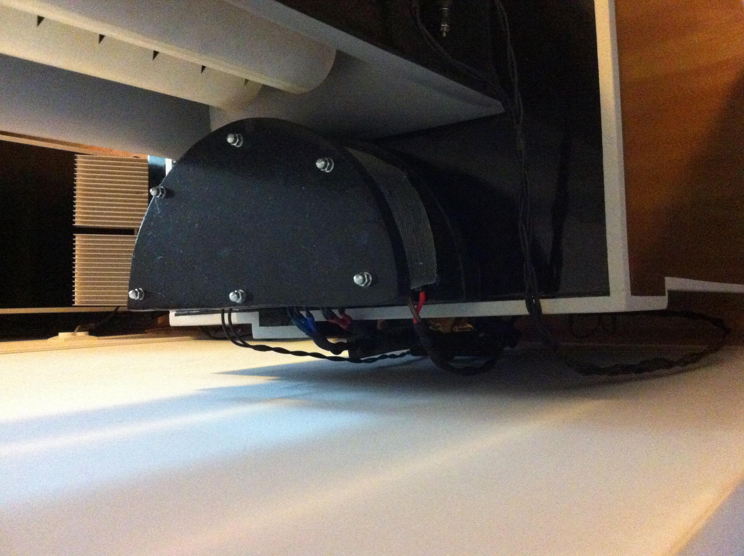

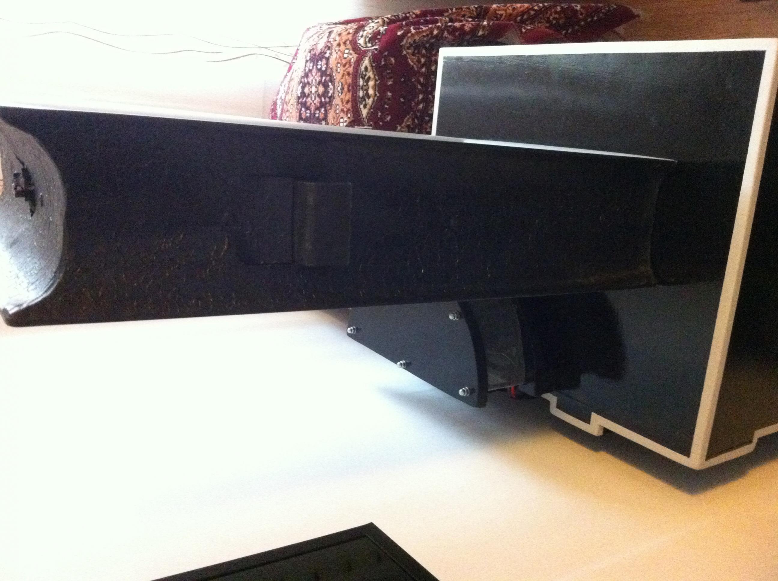

finished project at last!!

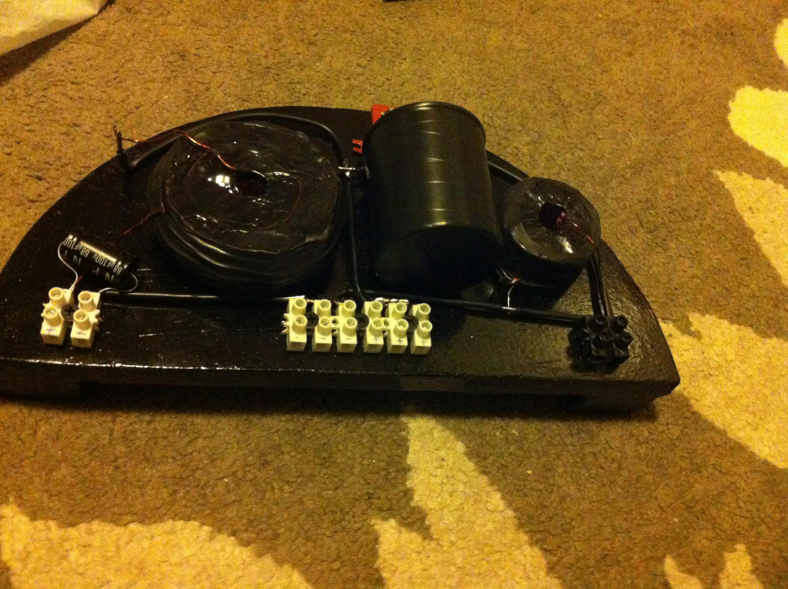

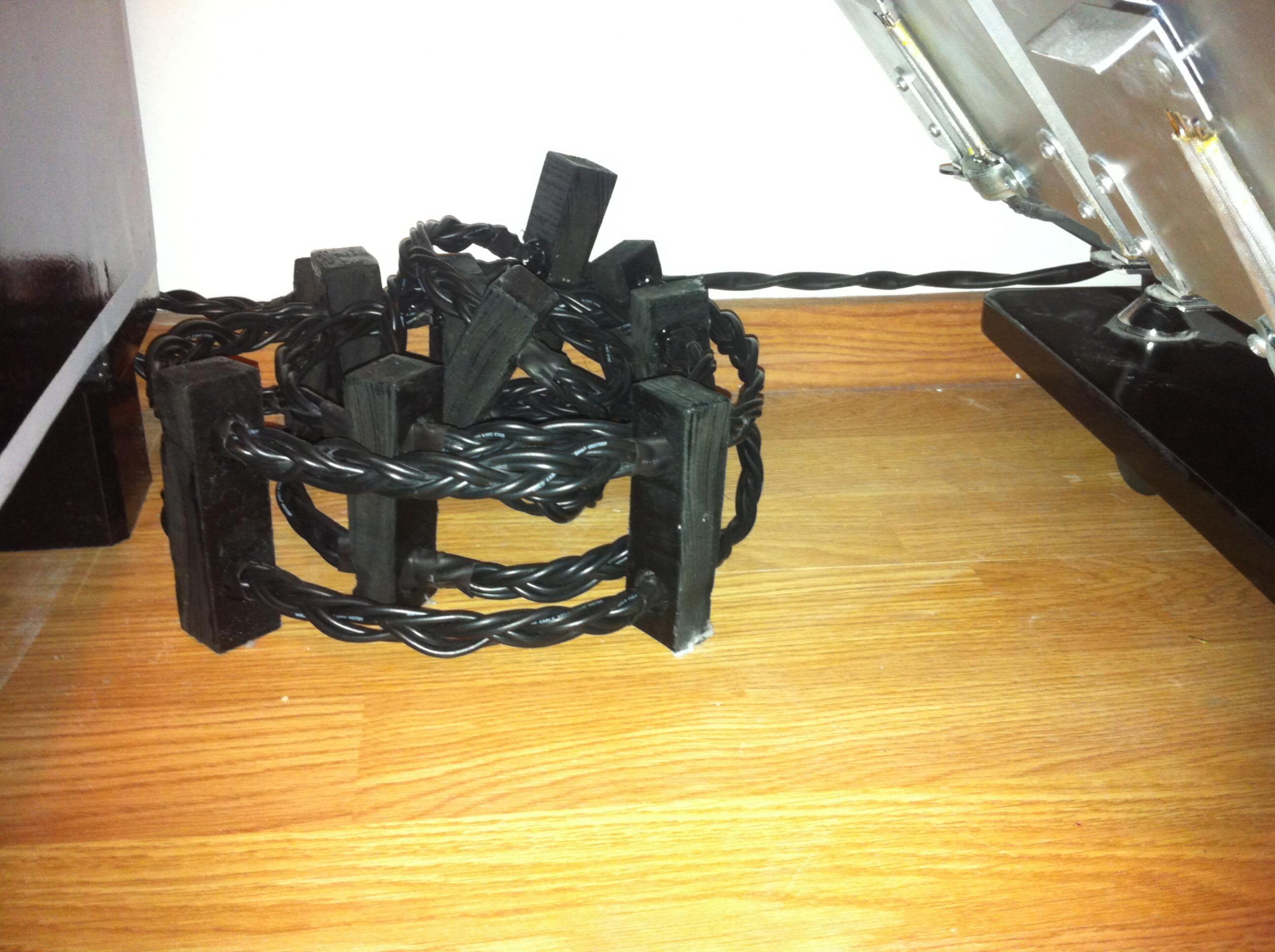

Hello and a happy new year to you all,
In december 2017, in my holidays i just finished my speakers, and forgot to post. Here are some pics with the finished rubas, bass, cables and filters.
You may not see many changes but they are all actually repainted and everything has now the finishing touches. I added a burned wood effect on the sides of each ruban and aded some handles. Those speaker cables are 6*2.5mm wires twisted two by two, then braided and have 3m long, and the + and - are holded together by wooden supports at 10cm distance from each other. This may be overkill but i noticed that cables do affect the sound abit..
The filters are basically butterworth but fine tuned to eliminate the peak at 220hz. The caps used are pp filled with oil motor run (posted a pic where i made a burn in with them at 220v mains for 10mins :) ) bypassed with pio and pp caps for the rubas and litics for the bass.
Cheers
Sergiu

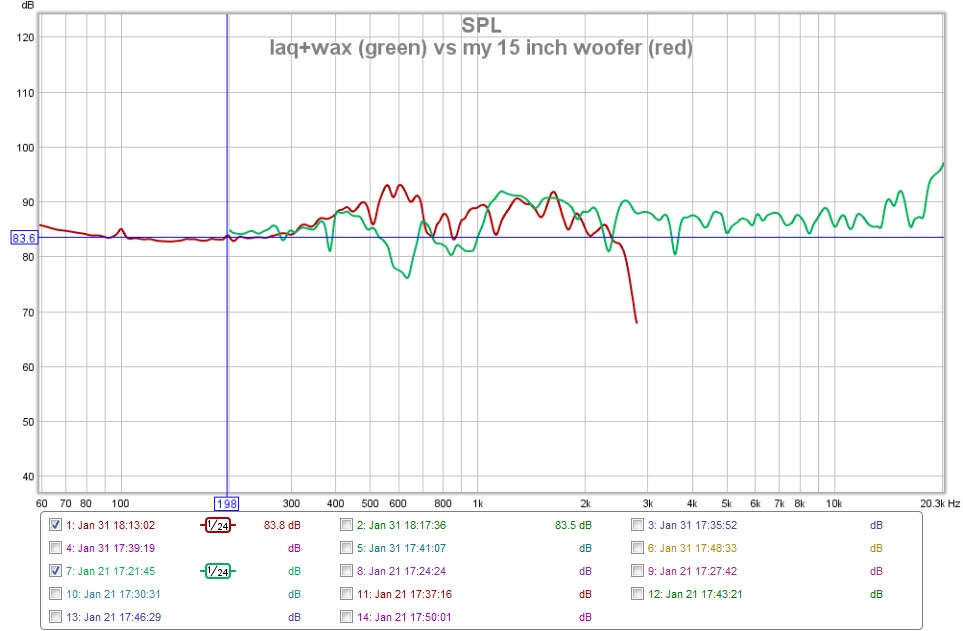

Hello my friend,
I forgot to post a pic with the 15 inch woofer+ ruban. After the listening sessions i dissasembled th ruban to make the final coils and seen that the gap was smaller and rubbing as i sayed earlyier. Here are some measurements. The mic was at the level of the frame of the 15 " bass and after i measured the bass, i positionned the mic perpendicullary, on axis at the level of the round edges of the ruba cils, with the bass disconected, to measure the laq+wax almost finall version prototype ruba..
I listened to this interesting combo and making adjustments for about 2 hours then diassembly everithing. The filtering was second order for bass and first order for ruba(300hz cutting point). The ruba was positionned 10cm in the back (still on axis with the bass) for my bass tastes to be fullfilled :drink: .
The sound was very powerfull (at 10W mono@jlh 69 amp @75% volume from the phone), in a way that i could barelly hear my wife speaking (from almost a meter a way, where she was) :rolleyes: in a listening room of 20sqm at 3 m away from the speakers. The sound quality was even more staggerring now with the adenum of the bass. Its pitty that the ruban cant go lower than 150~200hz. Its interesting how the bass contures and spices everithing up.
Cheers
Sergiu
605347d1489526514-diy-ribbon-speaker-laq-wax-green-vs-15-inch-woofer-red-jpg
Ps: the measurements where made with no filtering. I cutted the frequencies from REW, then joined the graphs togheter.
Here they are..

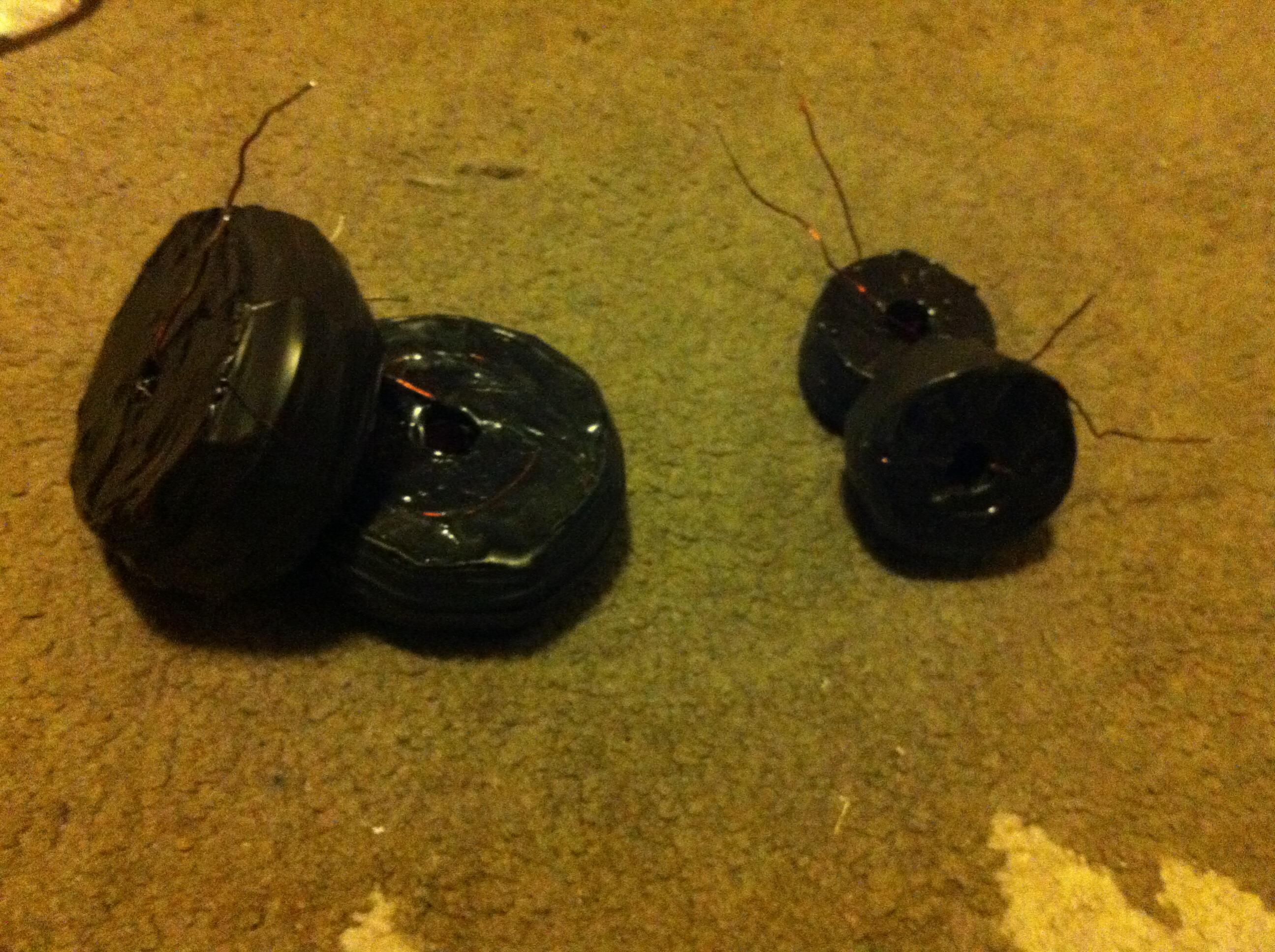

Many thanks to all for the advices, especially Sergiu 209 and Wrinex.
I have made my own(until the test) version.
The chinese magnets ( 49x9x9mm) are declared N50.
Steel magnetic circuit (CT-3) - 15x6x25cm
The gap is 3.3 mm, the copper coil wire 0.14, 8 Ohm.
The coil is made as in # 969 on a mandrel with БФ glue.
The weight of the coil is 1.19gr.
Membrane-paper 200gr \ m (I will redo from 120 gr \ m)
The sound really liked, surpasses everything I heard before.
