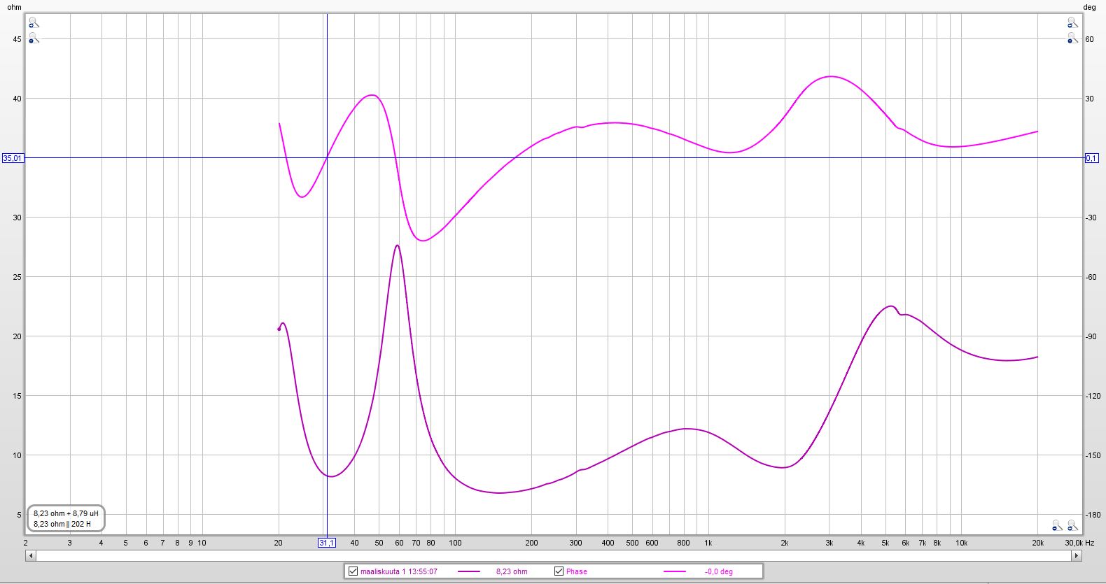

You should be able to check the actual tuning frequency with the impedance measurement. See if it is really 34Hz. The tuning frequency is the mid point between the two impedance peaks (and should also be the point where the phase crosses zero).
Tony.
By phase crossing zero, do you refer to impedance phase? In that case the tuning frequency would currently be 31,3 Hz for the right speaker and 31,1 Hz for the left one. That would make sense, for stuffing can enlarge the effective cabinet volume easily by 10 %, or even more, if I've understood correctly. There probably is a slight difference in the amount and/or placement of stuffing between speakers, causing the difference in tuning frequency.
31 Hz tuning with the current port length of 12,3 cm and port diameter of 43 mm would mean that the effective cabinet volume is 28 liters.
Impedance measurement graphs for the right and left speaker are attached.
Yes the impedance phase. As you can see the zero crossing point does not appear to be exactly in the centre of the dip between the two peaks, so if you were to base it on eyeballing that you would get a slightly different tuning frequency. I suspect however it is the midpoint between the two peaks, it is just that the dip is not 100% symetrical.
edit: for your own info it is probably worth doing the sim with the lower tuning frequency to see how that affects things.
