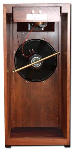

What about this one?
What is people's opinion about this type of driver bracing?
As the retaining screws are coming thru the baffle from front to back and that brace is pushing forwards isn't it just trying to dislodge them and bend the frame? especially as its 1 bar fixed on 2 opposing sides of the circle.
I've always fancied a disc of metal on the front the driver to spread the loading. Then very long purpose made stainless threaded bolts countersunk into the metal disc. These pass thru the front baffle and the back of the cabinet. Then another metal disc to spread the load and nice big nuts to be torqued up. Ah the dreams

That brass bracing rod on the Yamamoto looks somewhat cosmetic to me.
Yeah it confuses the hell out of me too.
They dont even have a brace on the cabinet, which is bad for an open backed cabinet
I believe the Yamamoto is made to vibrate with the music, it's the opposite if what we're trying to do in making a 'dead' cabinet. The designer chose some special wood too. There are people who's philosophy for cabinets is that they are musical instruments.
