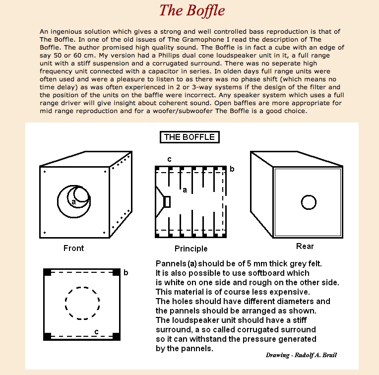

Thinking of a practical box that isn't an OB (which i have never been enamoured of), i was figuring a couple hundred litre, box damped like a boffle with a swiss cheese back (you need a back to make the box structurally strong).

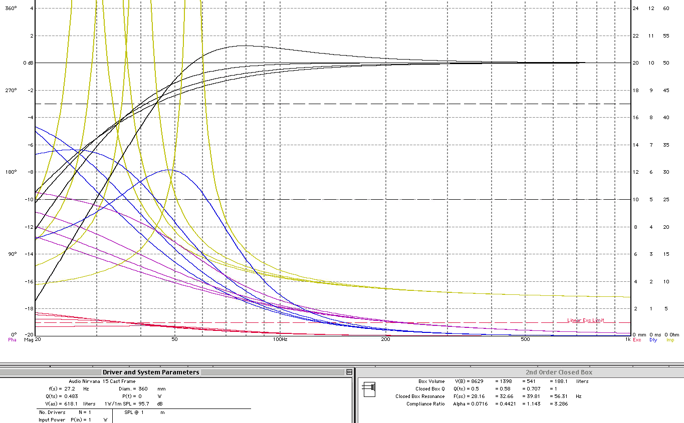

I ran some box simulations a couple of weeks ago and found that a good number was around 250 litres but I figure my box will give me a bit more than this which can only be better.

In terms of experiments - my plan is to build a box with removable back. This gives me a well-braced solid platform to try a) open backed box (a.k.a. Yamamoto YS-500), b) a boffle, c) closed box with aperiodic vent, d) sealed.

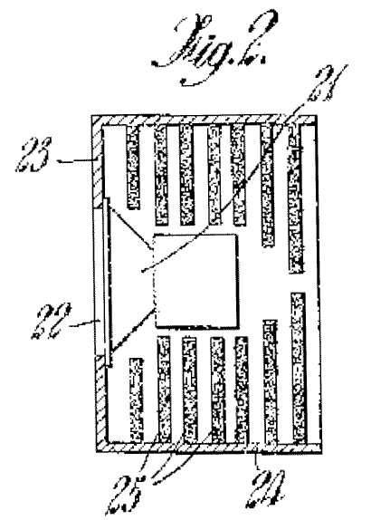

What's a boffle?

Also, to get any sort of bass from them, you'd need a BR.
Why? With room gain it looks pretty easy to get into the 20s pretty solid.
Too small a box pushes the Q up, making it aperiodic pulls it back down.

What's a boffle?

The "boffle" looks intriguing, baffles provide resistance to air flow, like the ports on the onken design?
I think more like an OB but with the back wave absorbed so that there's much less dipole dip-and-bump to worry about. Or perhaps more like IB. Either way it does look worth trying so the bracing has to designed to allow for it. Of course, there won't be any bass reinforcement from the box with this setup.

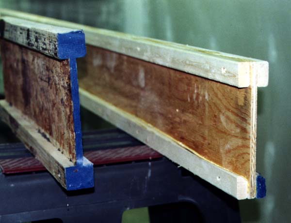

What thickness of plywood to use for the box? I can buy 11.5mm and 17mm thick panels. I can glue panels face-to-face. But I'd rather brace the hell out of it than have panels that are so thick and heavy that I can no longer move it without help from a neighbour.
what if the box was made using only 11.5mm panels and then lattice braced ?
the floors in my house use wooden i-beams, very stiff (much better than my last house that used regular joists) and lightweight (photo) and much more practical than using thicker and thicker floor boards.
The boffle i was thinking of could also be described as a damped U-Frame
Braced with I-beams, you can use 1/4" [6-7 mm], but that would be a lot of work, so the 11.5 mm is doable.
Frankly, minimally braced 1/2" ply was typical for this type of driver in a big cab as any 'breathing' the cab did helped to damp its high Q. You can always go back and add bracing if you don't like how it performs.

that just looks like a labyrinth to me dave, albeit one with a vent area equal to baffle area. Ignoring semantics tho, it would be worth a try.The boffle i was thinking of could also be described as a damped U-Frame
