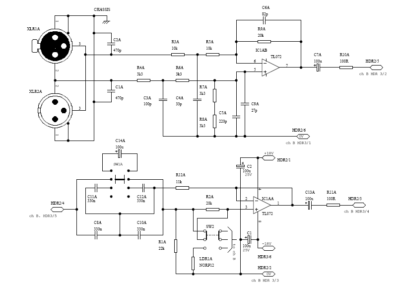

BL-1 Balance Input & Bridge Module
HEY APEX AUDIO......
greetings is this schematic yours?
thanking you
andrew lebon...
This is balanced input with low-cut circuit and limiter switchs from CROWN XLS amps, can be used with B500, H900 and also with older B250, H750 without limiter. LDR in this schematic is integrated resistor in NSL32, and integrited LED can be connected instead CLIP LED.
Regards

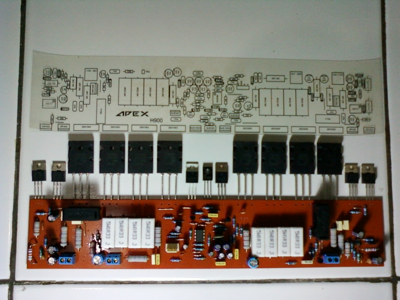

Hii apex, this project my H900?
Good progres, look you are finish it soon.
Regards
