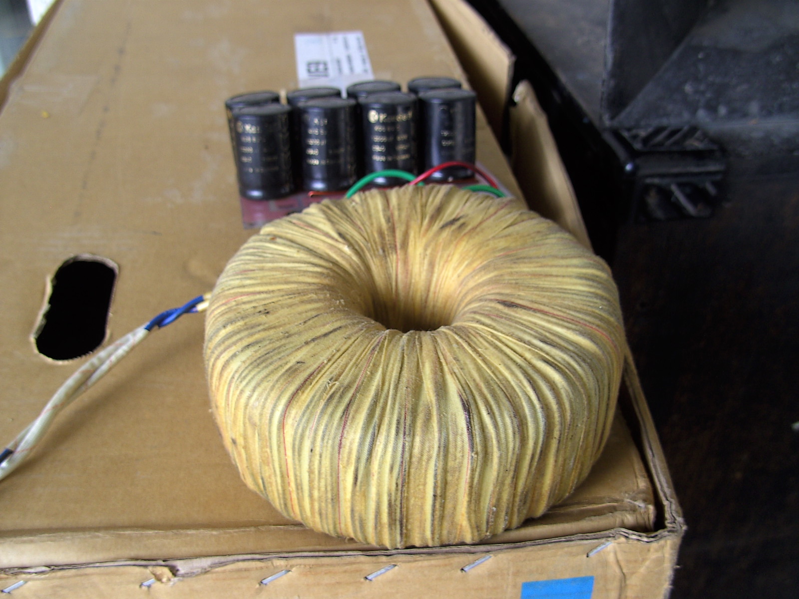

hi Ravaslanka
greetings toroidal details for H900 amplifier core size and winding details are given....
thanking you
Andrew Lebon
hi andrewlebon,
thanks,but 2 turns/v is for secondary but what about the primary.the
core seems to be supporting 2kvand would you mind sharing the equations you used .
thanks again
ravs

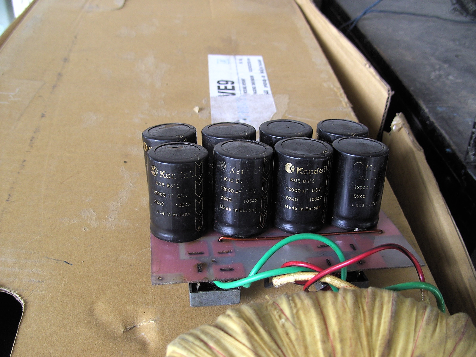

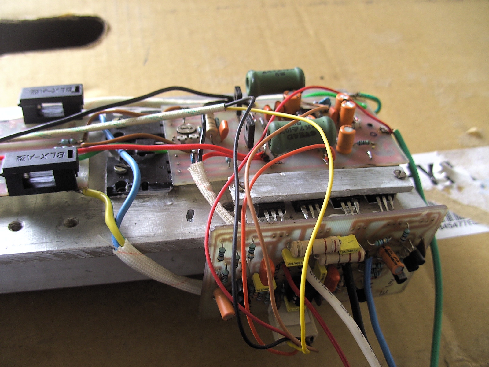

Greetings tlo72 step driver works well power supply and new DIY toroidal transformer for H900
thanking you
Andrew Lebon
Congratulations, looks like real DIY. Do you have lower temperature on heatsink?
Regards
hi apexaudio
greetings thanks for the encouragement yes temprature is low

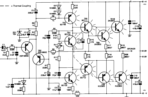

Hello sir APEX,
I'm one follower of your thread.
I just want to show a schematic we back 80's.
This sound ok with 38 0 38 ac.
Wish i could supply it on higher voltage like 70 0 70 ac transf.
Somebody could help me to revise this schematic.
thanks in advance.
regards,
Ronald

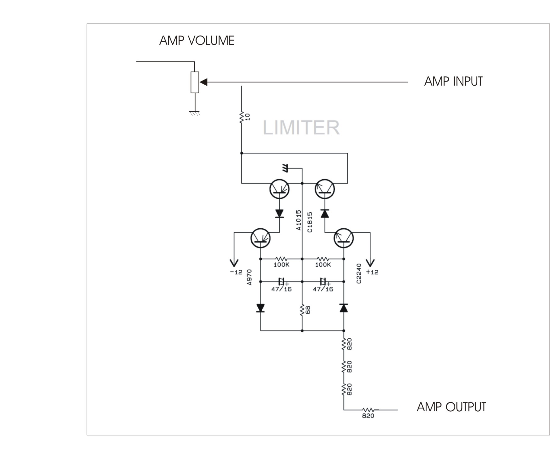

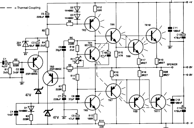

Thank you sir APEX,
I have additional request for this circuit to have a simple zener limiter.
supply rail is about +-90vdc. idle.
Can it be possible with zener ?
Best regards,
Ronald
Use this simple limiter, diodes are 1N4148, and you can use pot 220R instead 68R resistor to set limit level.
Regards
- 900W H-class PA Amp with Limiter
