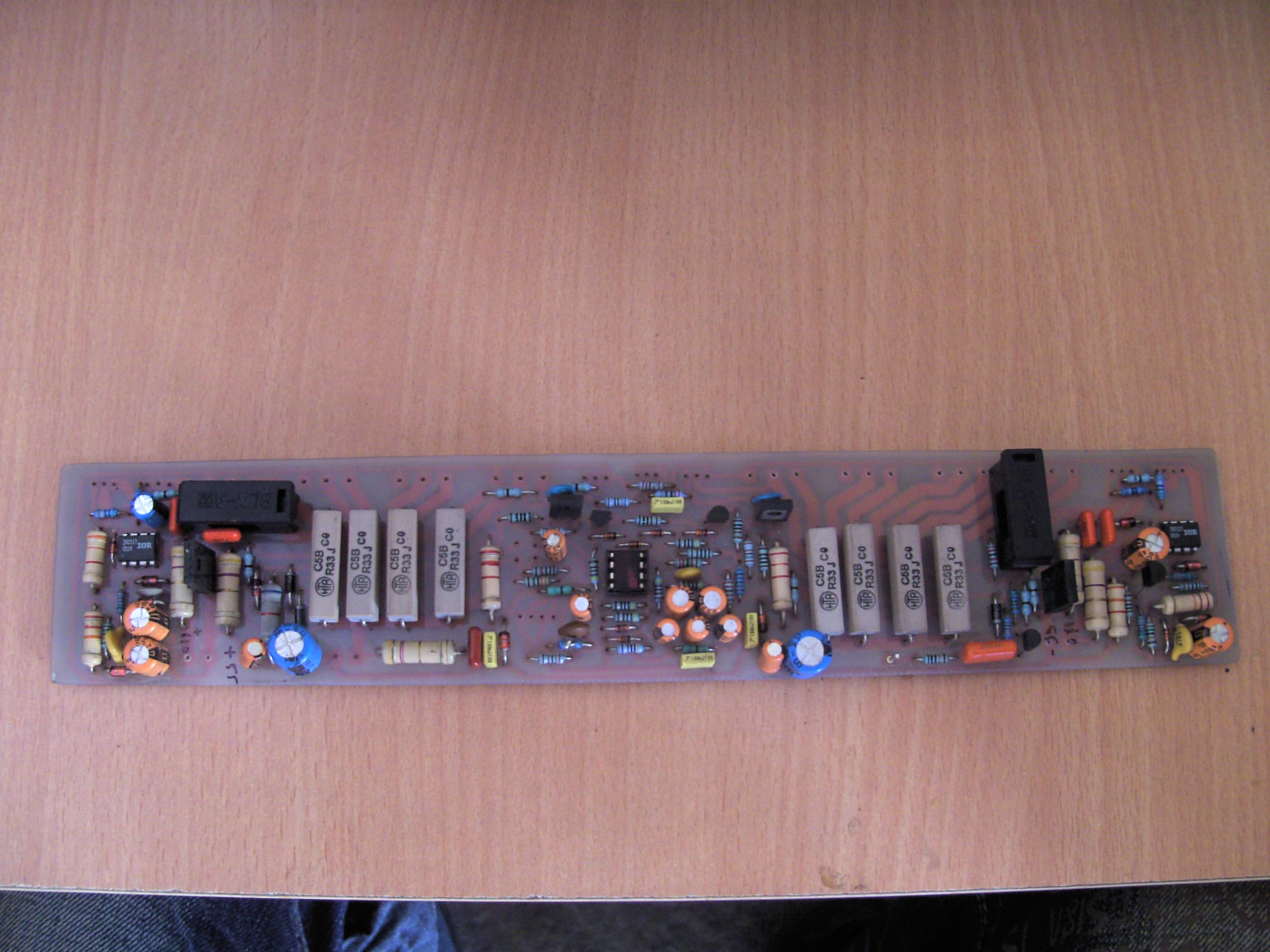

greetings can ab class amplifier be made into h class example
dx turbo by destroyer using apexaudio tlo72 rail switching supply
thanking you
andrew lebon

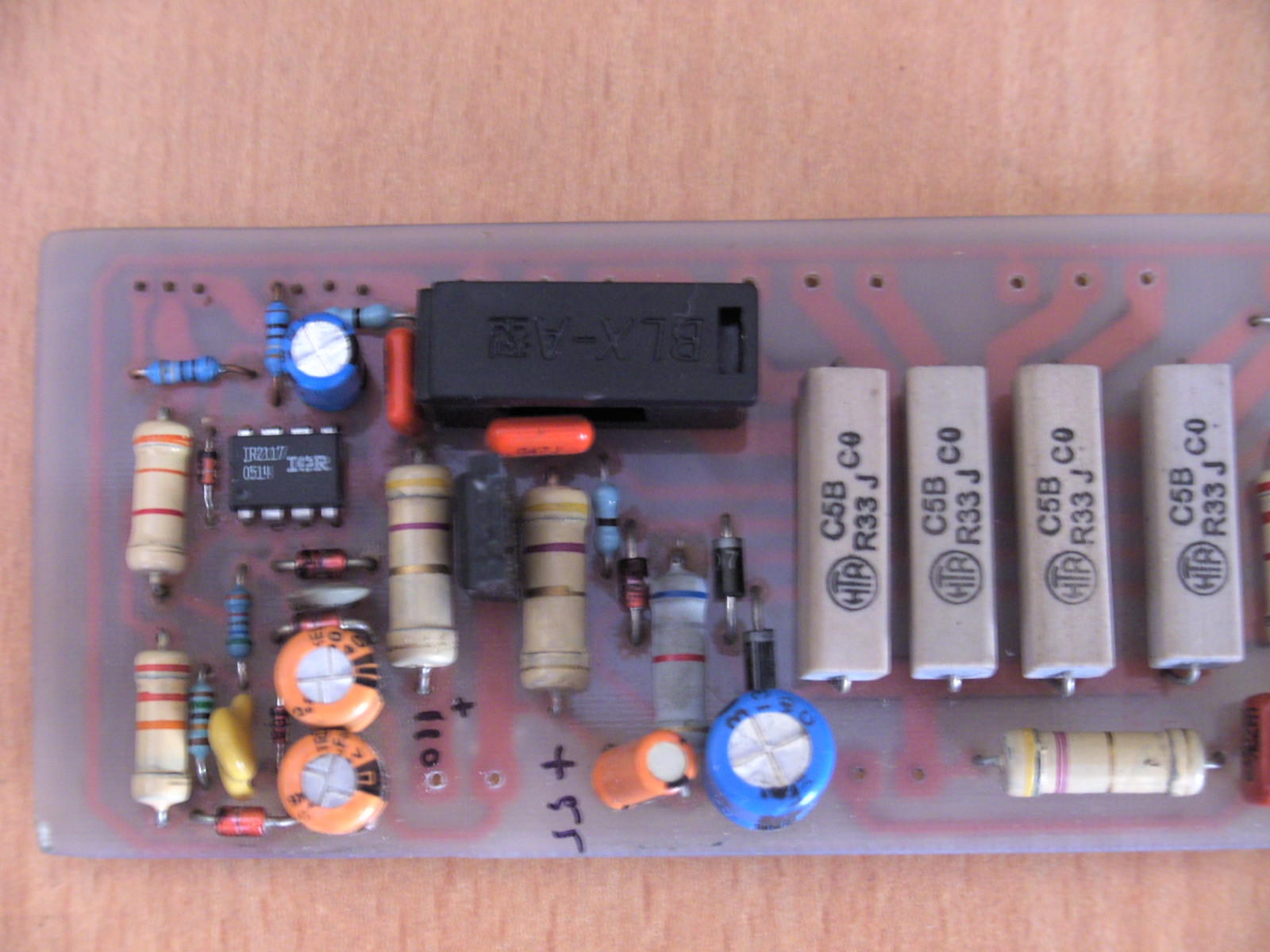

Class-H is nothing except a class-ab amplifier with rail step switching.;)
The TL-072 switching has some serious flaws in driver turn-off, also the slew rate of that opamp configured as comparator is not adequate, instead use IR2117 circuit.
hi apexaudio
greetings almost done
thanking you
andrew lebon
