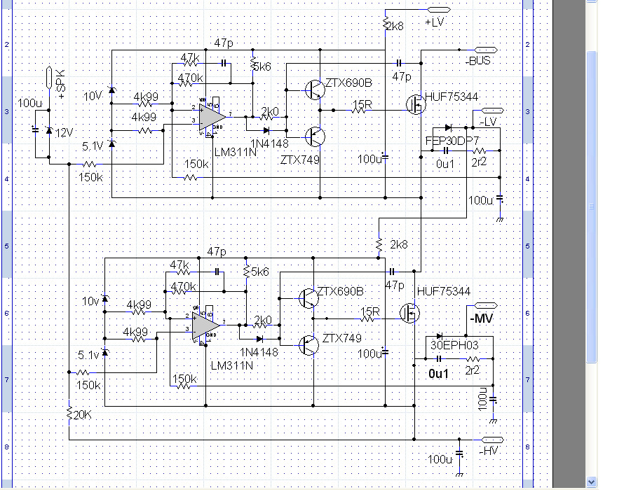

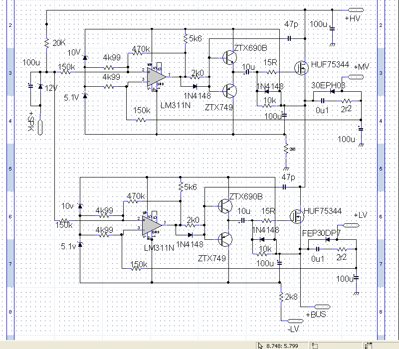

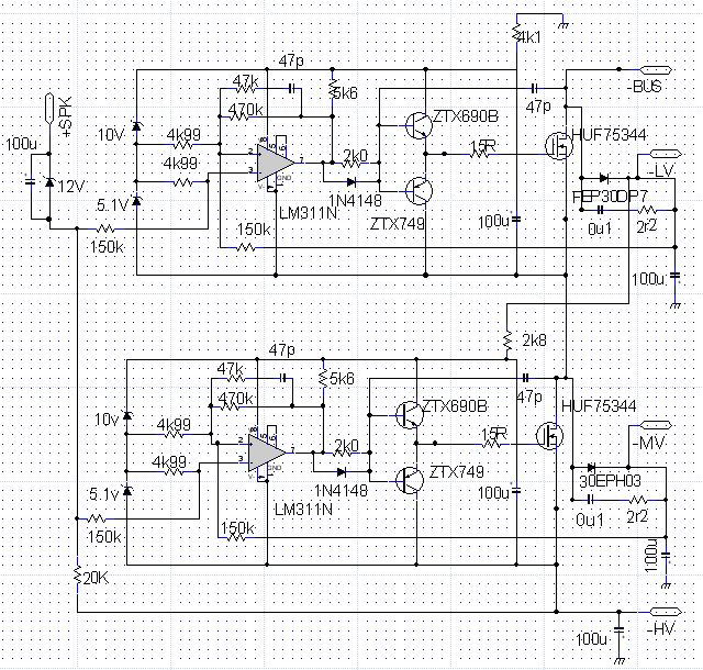

The 47 pF caps on each rail switch keep the slew rate under control. It increases the switching time - but not enough to make it ineffective at audio frequency. Switching losses will be noticeable at 20k, but are you going to put that much into your compression drivers? It helps reduce the commutation noise, as do the .1uF/2.2 ohm snubbers. The other thing that slew limiting does is reduce di/dt - to the point where TO-247 package and typical PCB inductances are practical. Too much inductance combined with too fast switching and you get spikes across the PCB traces that last only a few hundred nanoseconds but are deadly. These commutators are the variation of the QSC switch that I use on some of mine. Uses the 311 - so they're an option in places where the IR drivers are difficult to find. The basic amp schematic that I use is similar to Apex's (with the opamp in the input stage and EF outputs).

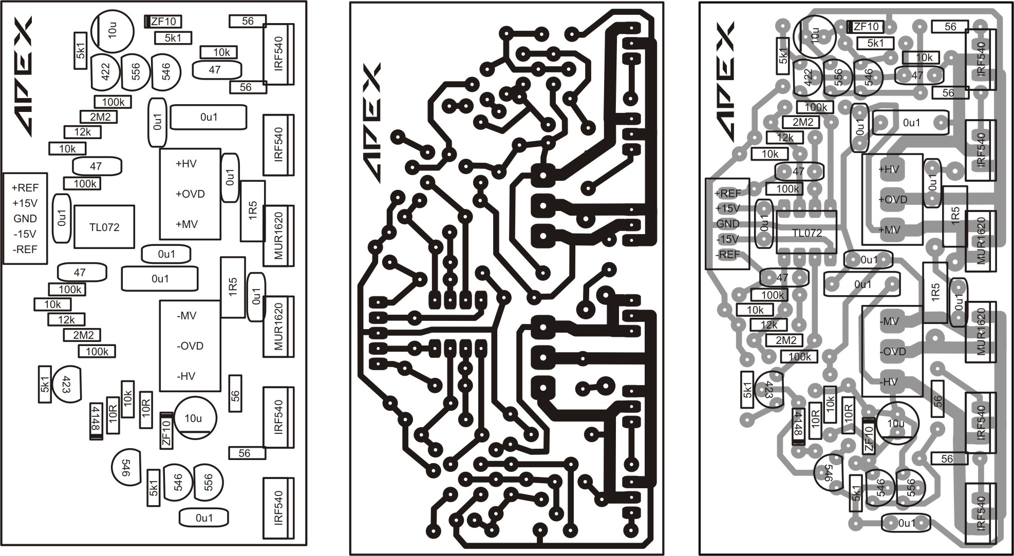

APEX H-class Step Driver with TL072.
PCB size: 91x52,5mm
how to apply the ckt if i did'nt manage to get the ir2117
H900 PCB is only for IR2117.can i still use my h900 v2 board?

Amp will work without NSL32, just not have limiter. U can put LED diode on place of LDR diode and it will be peak indicator. A817 is optotransistor, and NSL32 is optoresistor, can not work.hi apex audio

Transformers and condensers can be use.
PCB size: 91x52,5mm
