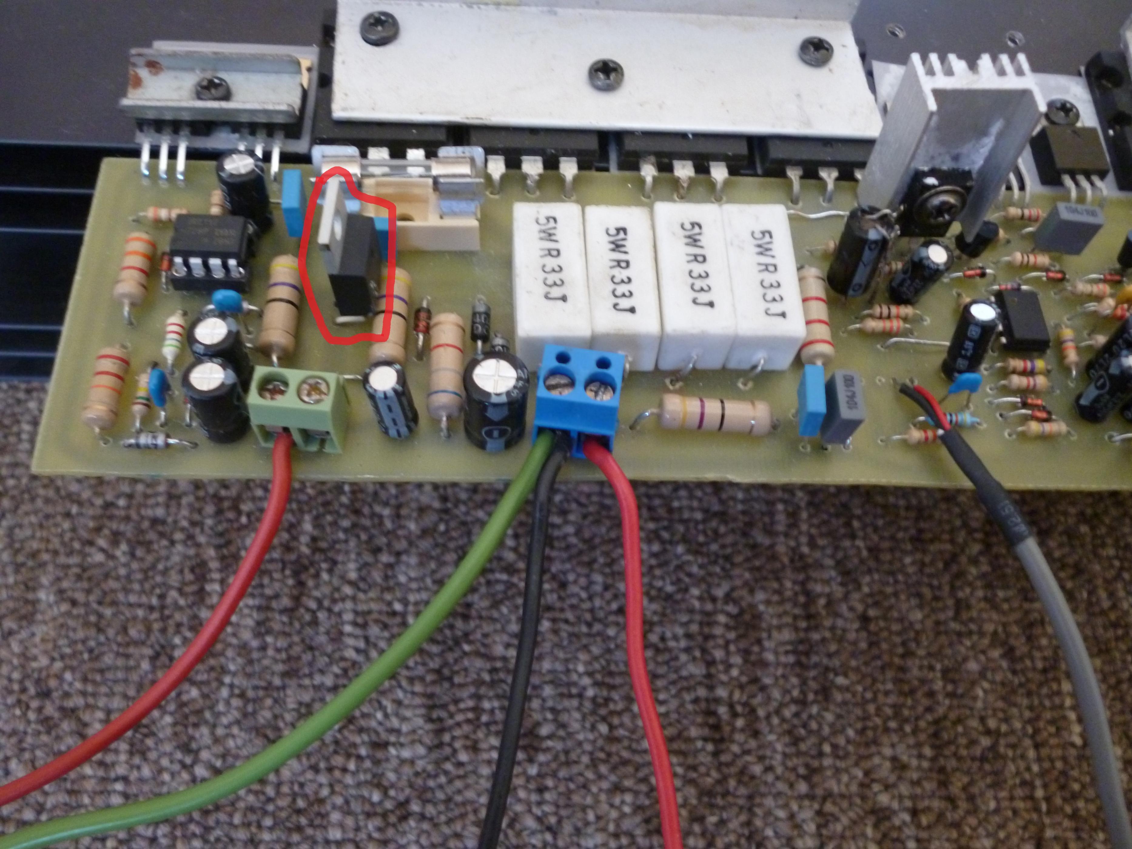

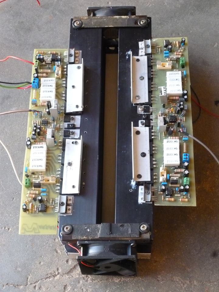

Hi Good day every one here on DIY! I all so build H900 v.2 power amp. I start it up with HV+110dc HV+ 45dc 0v LV-45dc LV-110dc This is only for a test. Nothing heat up, when put in signal, no sound came out of it. Please can any one tell me what I doing wrong here please?
are u sure this correct ?
this would be HV+110dc LV+ 45dc 0v LV-45dc HV-110dc
if this correct. And psu normal, check the input stage.

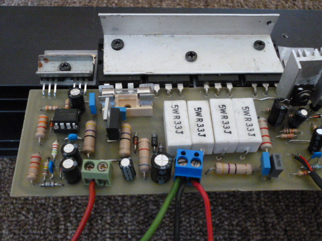

Is that how the transistor must be? Because I see in other h900 project, transistor sit other way rond.
Yes your mur is correct,

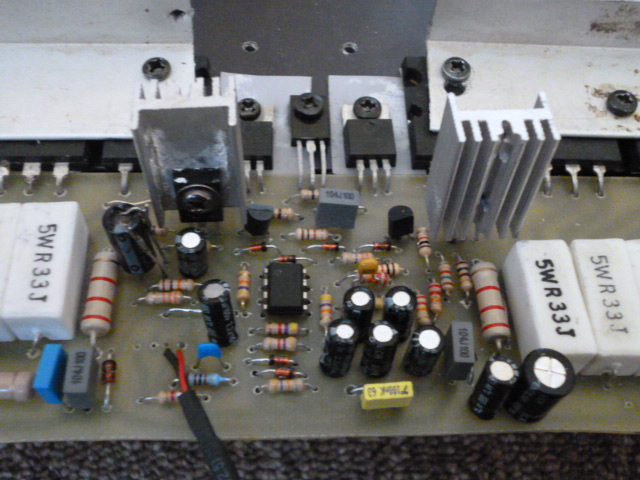

pls check the pin orientation of your ne5532 i cannot see good on your photo. then d0nt forget the jumper and proper groundings. pls check the voltage this diagram can help you
