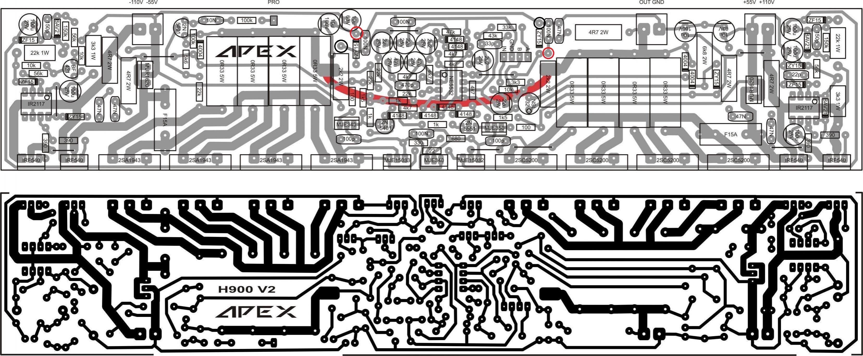

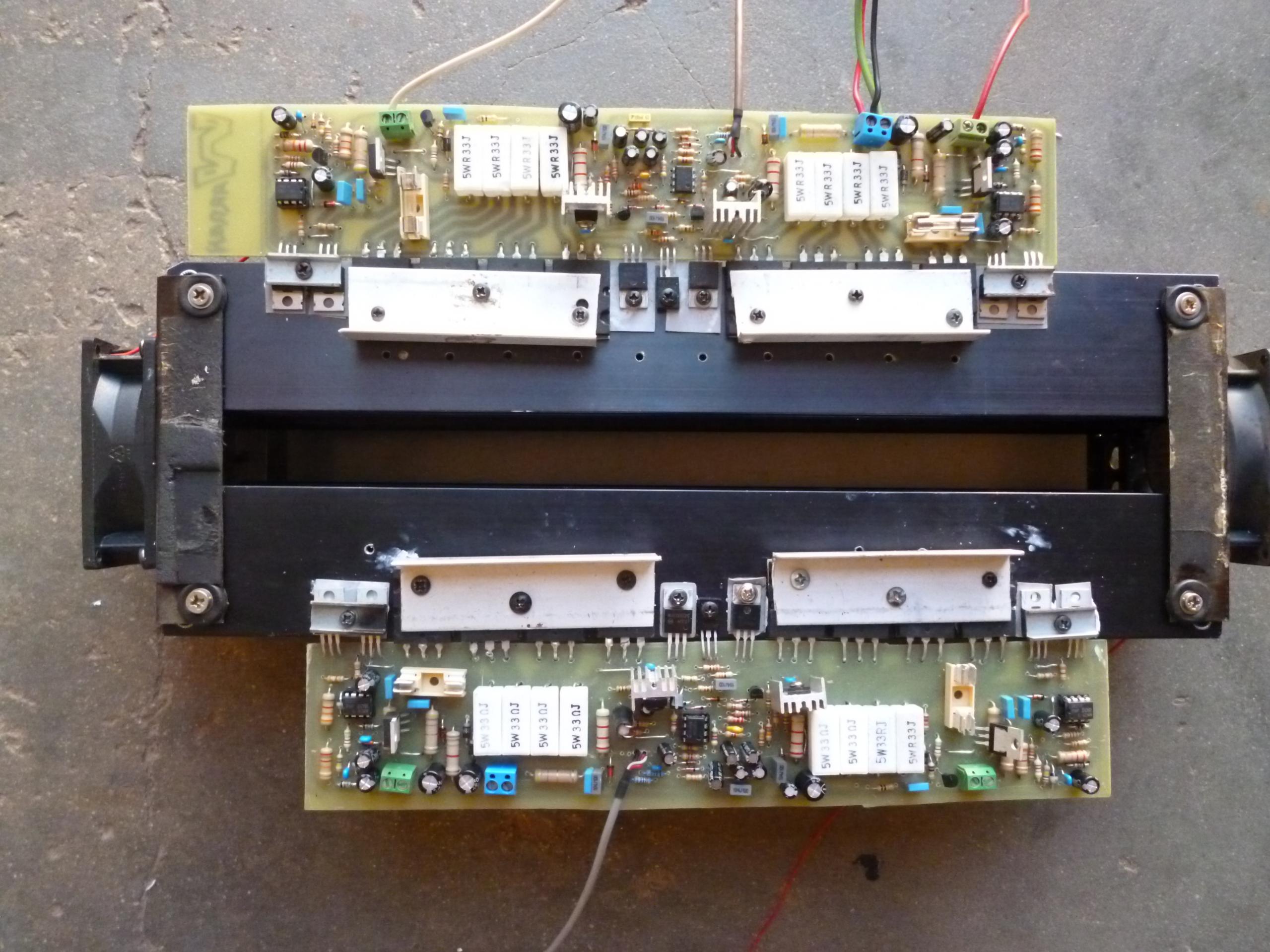

Just want to ask! Is this the same signal connection on H900 as on B500?

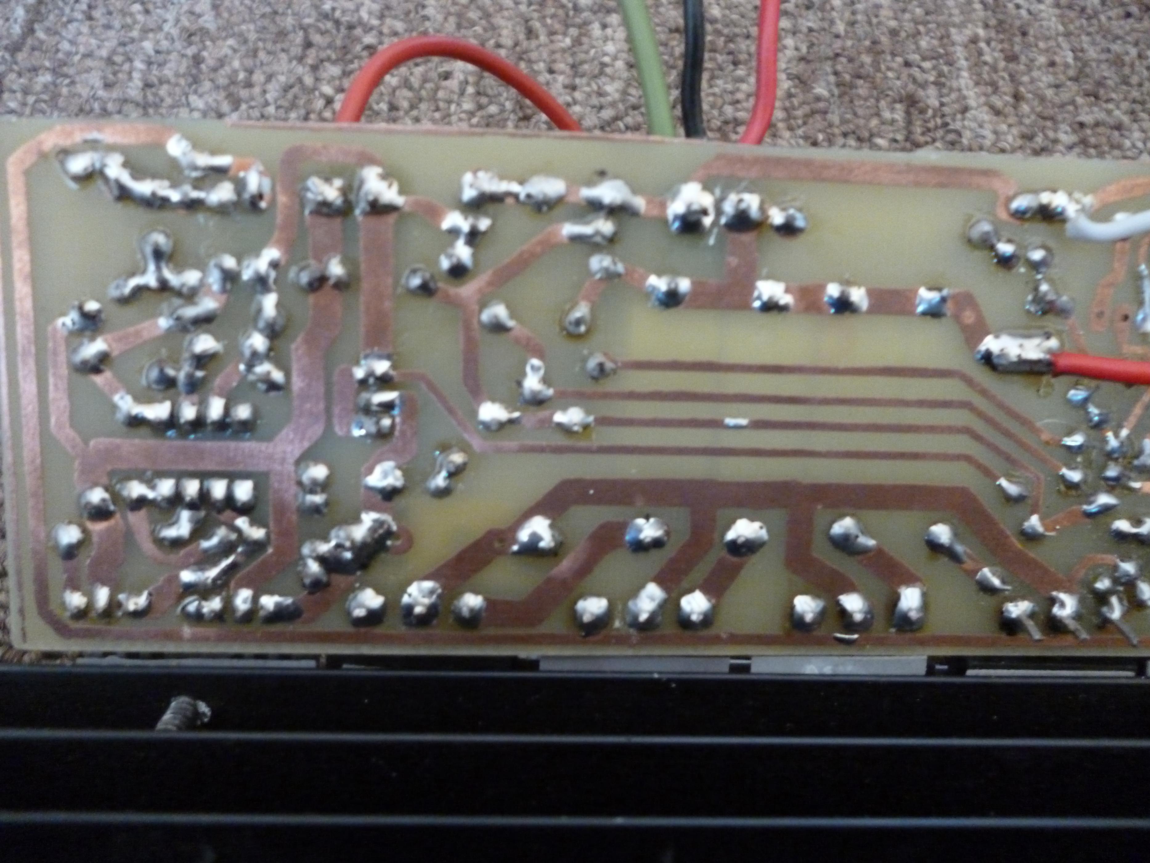

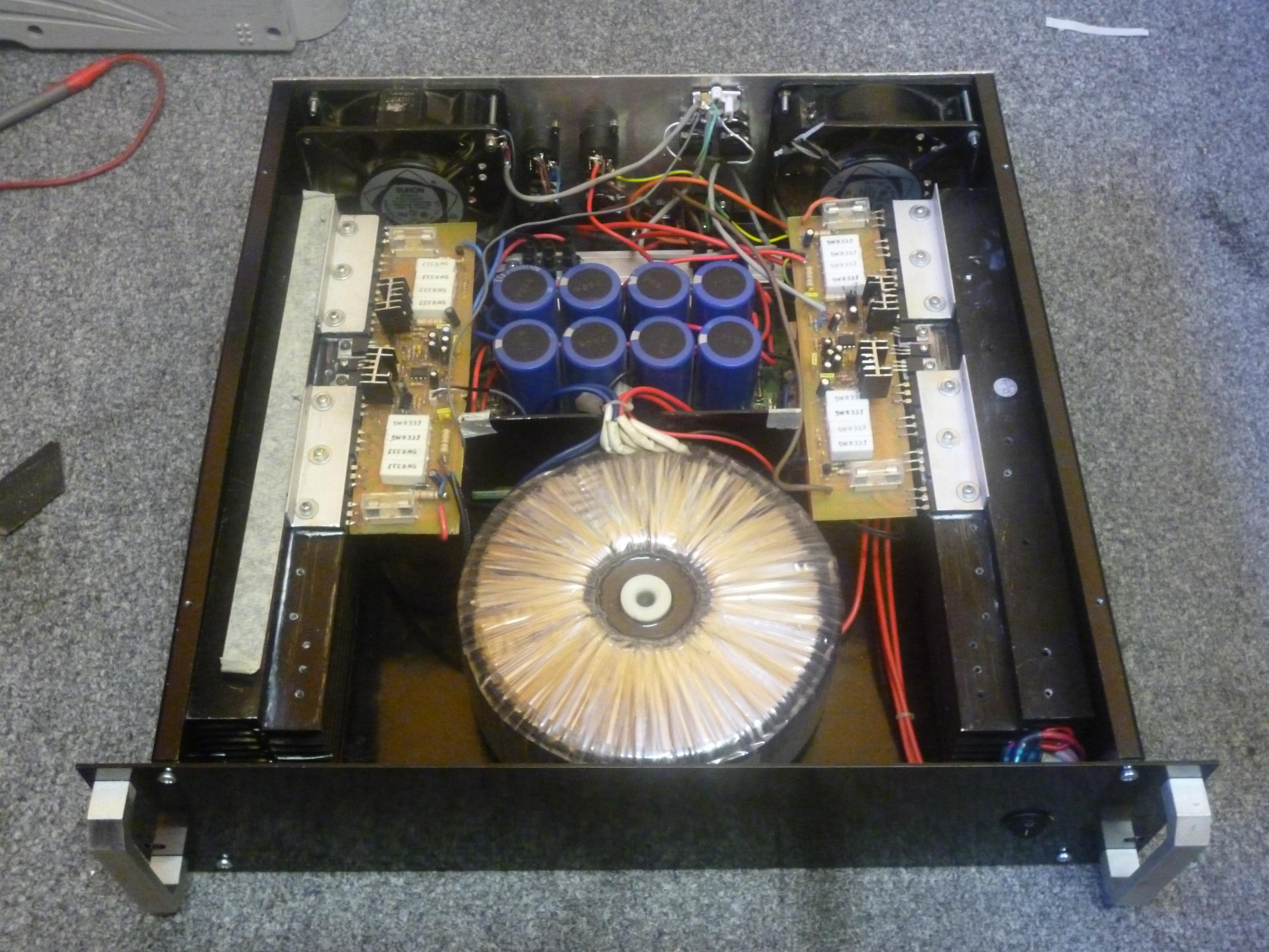

I started amp with rite power supply, but no sound out of amp.
This amp (H900) nothing heat up or blow on amp, but still not got sound out of it. See attachment.

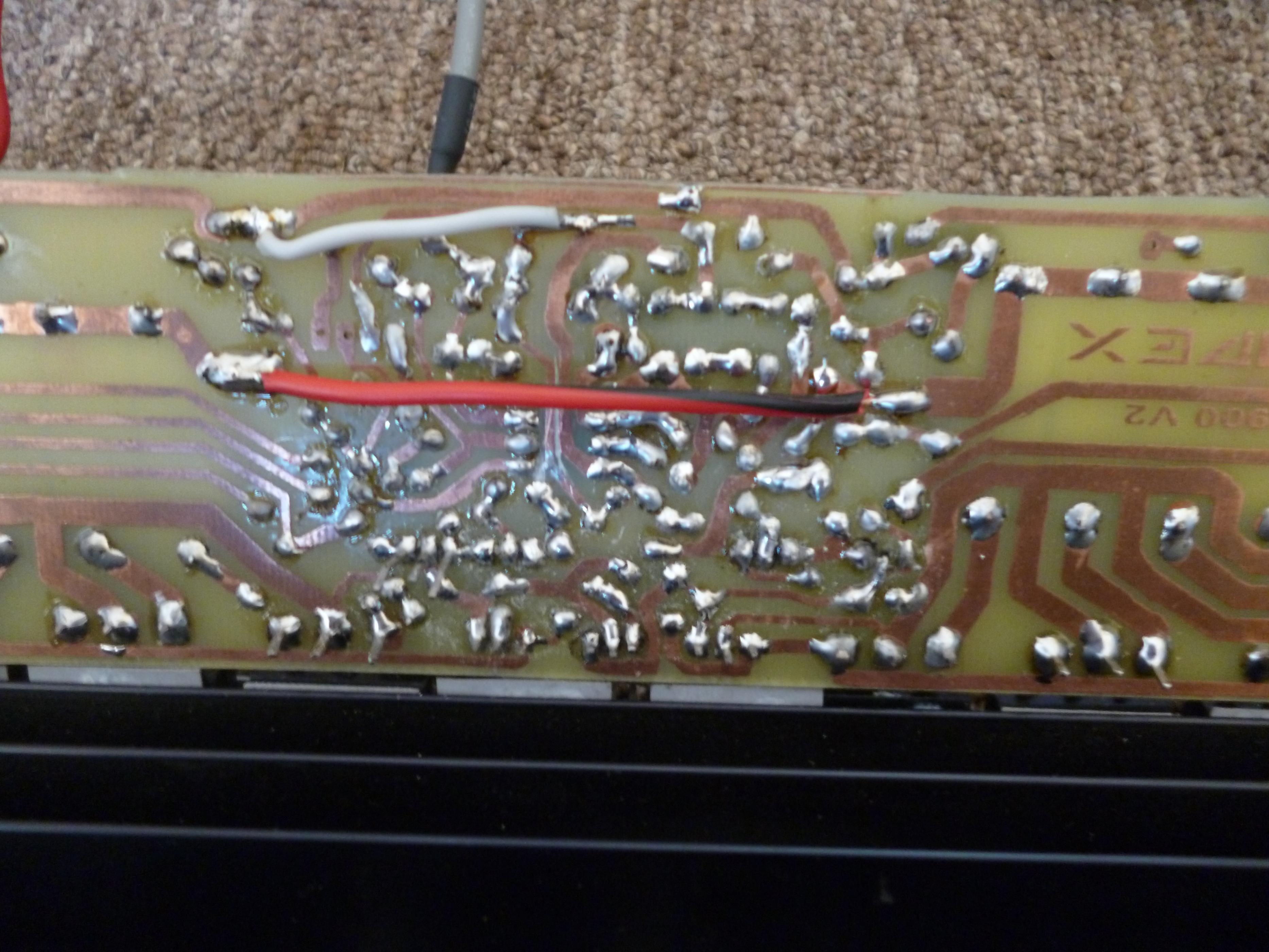

No I don't have protector on amp. Can you show me where must I test on IC sir? Like where must I put multimeter propes on IC.
ok, thats good step for test. U can check this voltage between R 2k2 and zener 15v. Put multitester red to this, and black to ground. This for +, and check - too.

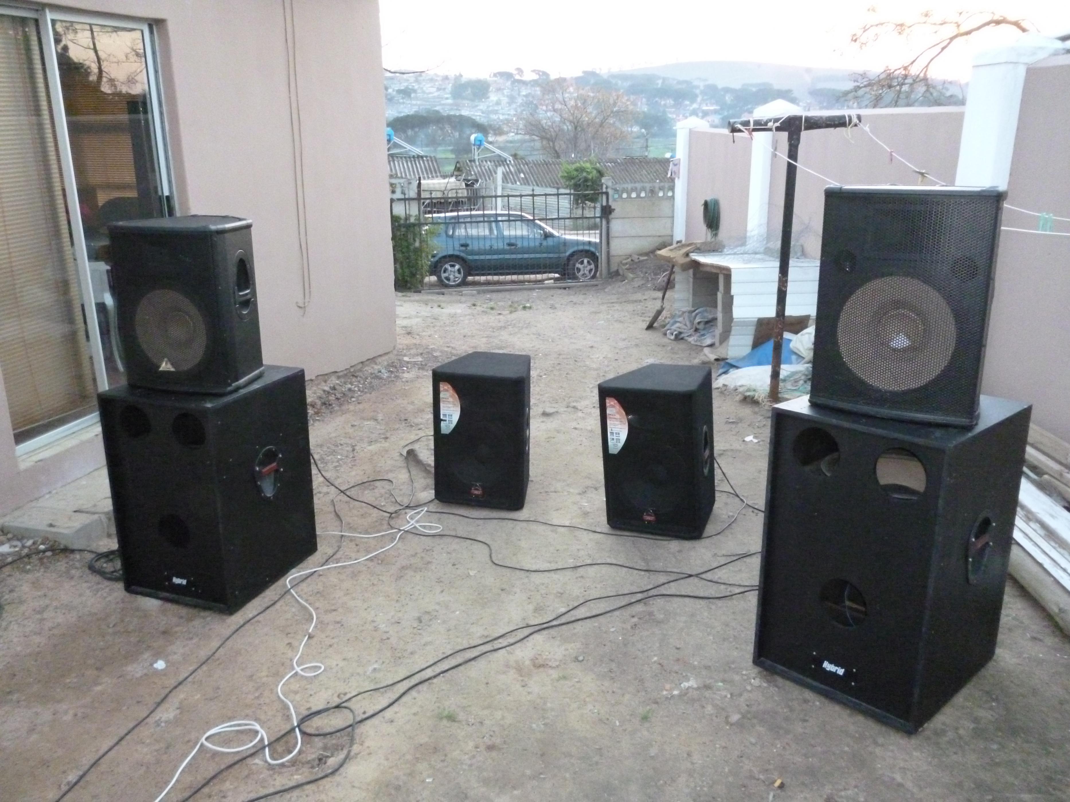

This is the first time I try to build H900, I build B500 and it work very good, with the help of Sir Jay Irvyne. Look at my B500 here.
look verry nice sir..
Can you send me a drawing to explain me much easier Sir? or can you show on the photo I send you, just to make it easier for me to follow. Sorry Sir, I'm just a small learner in building amps.
ok sir, no problem, but i use phone at this time, maybe later id u can wait

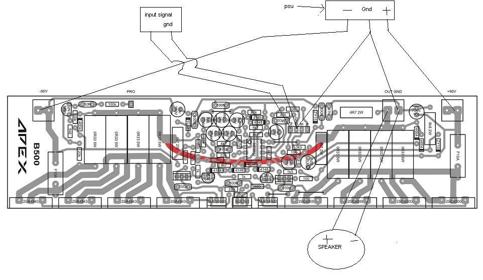

if not, try this, this amp same with b500, just this amp have stepper. U can check any error with b500 u have.
Can you send me a drawing to explain me much easier Sir? or can you show on the photo I send you, just to make it easier for me to follow. Sorry Sir, I'm just a small learner in building amps.[/QUOTE
look at the pic , i make a red and black circle test point. Color i give same like multitester probe u have. I hope this will help u sir.
