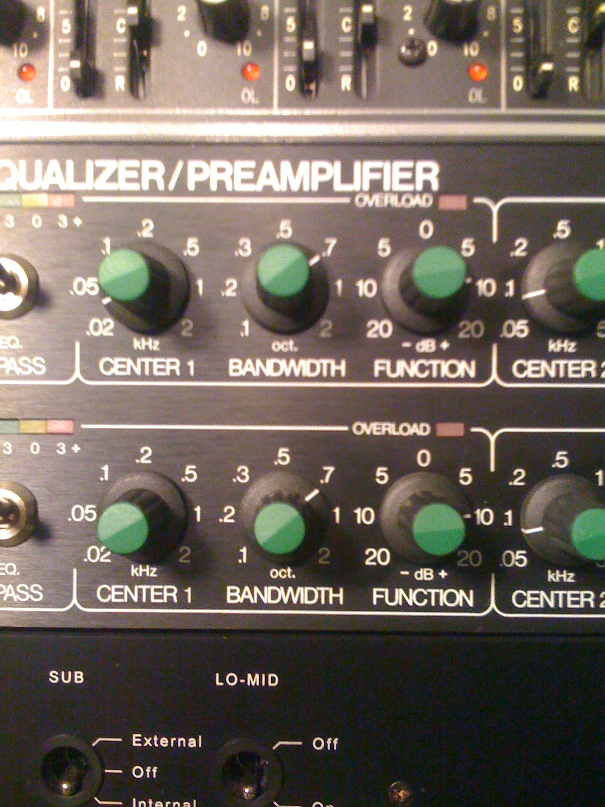

The labs:
The block of 4 labs souds impressive, fat en low… until.. I take the high pass of and set my parametric to 28 Hz / Q .7 and beef it up some 10db.. than… holy cow!!! that is what I want!! But with the labs that reduces the powerhandling to… 50% maby even less.. there is something down there just below 30 that makes it “uber”-low.. with the righ programm material that is…

The labs:
Ok, this clears up a lot, now I understand that you do have material that can benefit from a lower tuning.
