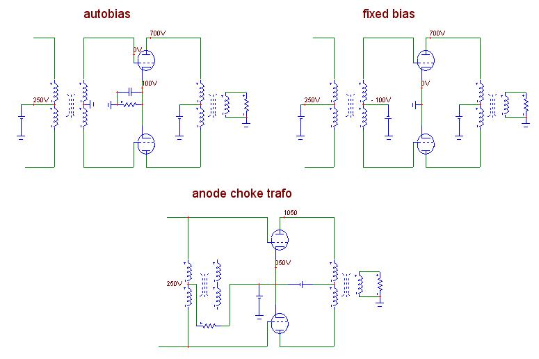

Hi Michael
This thread seems quite appropriate to
describe you some topo I am thinking about.
They are very schematized.
In the first you see the classic autobias
config while in the second we have the fixed bias
one.
As you see in both cases plate is at 700V but
in autobias case the cathode is at 100V leaving
us only 600V between plate and cath.
the third pic shows the trafo used as an anode choke.
The capacitor are avoided by lifting the 845 supply,
as you see. Static balance (individual bias adj) can
be achieved by means of a small pot (50R) at the catode.
Dinamic balance can be done by means of a 50k pot between
845 grids (with 3rd leg at ground by a cap).

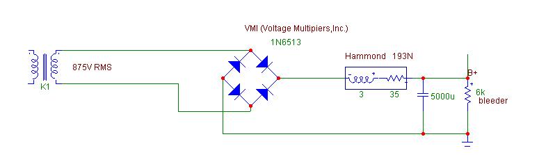

Hi Michael
I don't know the regolation of your your supply
transformer. Hoever with a solid state bridge it
would give you more volts than with tube.
You can try this configuration, where
the 5000u cap has to be made using an
appropriate serie of greater caps paralleled
with resistances.
It will have about 0.05 Vrms of hum at B+, I think it is good.

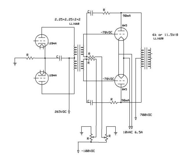

Hi Federico, All,
As I think I have mentioned I am not decided on whether to use fixed or cathode bias. I see some advantages to each method. Since I will be having it on the breadboard I thought I would probably try both ways and give it some listening and testing.
When you are biasing at -100V, is that set for AB operation? What is the idle current? What transformer impedance are you modeling, the 11.5k hookup?
The VMI diodes look good, does anyone know where to source them? I am planning a hybrid bridge with two 866s or 872s and two silicon diodes. Any tips?

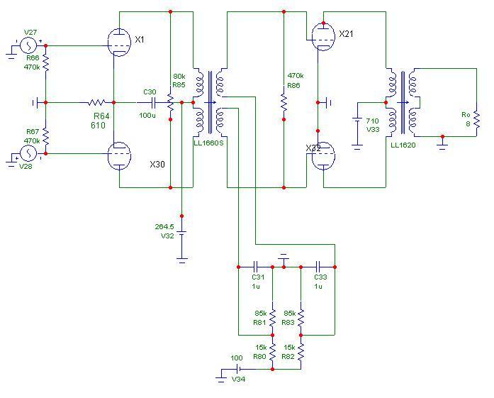

Hello Michael
library is here.
Here is my suggestion to fixed bias and static
balancing of the 845 currents.
As you see it use two 100k pot, thus
requiring about 2mA.
( as is the grids are at -85V)
I have some problem to conceive a dinamic
balancing method. Any suggestions?
Federico

Hi Michael
what's the premium?
in the cir above, for instance, if you increaseb the
mu of one tube of 1% current change from
88.9mA to 85.7mA.
However, similar results can be obtained by varying
the ( I do not remember the name ) constant k in
the Child equation or changing the contact potential between
grid and cathode and so on.
However if the static currents are different then the curves
are different too. It can be only a traslation, or a gain difference
or a resistance difference. I do not know what picture is
usually true. Maybe a mix of all.

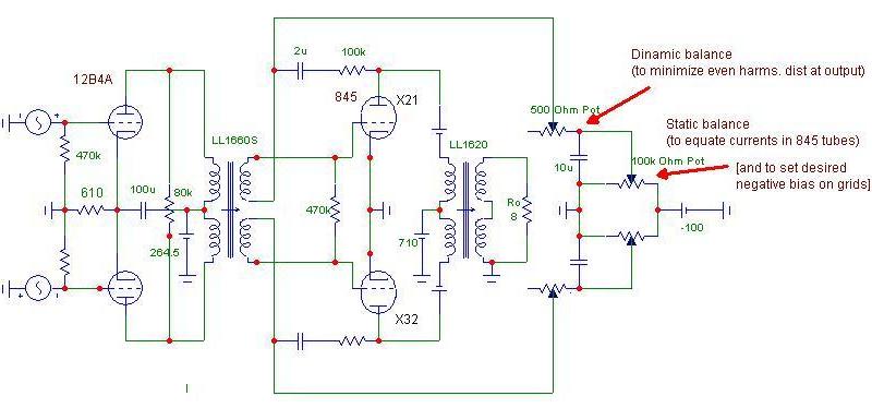

Hi Federico,
What I was wondering about was dynamic balance by variable feedback. From this picture, if redrawn somewhat, the two R from the centertap of the interstage would be the 85k of the bias voltage divider. If one tube conducted less at DC then it's R would be made smaller, correct? Since that R is also the R across which feedback voltage is developed, less feedback would be applied to that tube and net gain would be increased. Any validity to the idea?
Michael
Hi Federico,
Michael
Compliments Michael
Your idea works well!
but I have changed something to separate
static from dinamic balance.
I have redrawn the cir as follows.
Dinamic balance succeded in cancel 2nd Harm
when I introduce some unbalance (for instance in the
output trafo)
the pot has to be limited to 500/1000 Ohm not to
introduce too much NF. This kind of NF decrease
the resistance seen by each tube.and this is not good.
So small pot. But it works well.
However I still looking for a more traditional method
( without NF).
