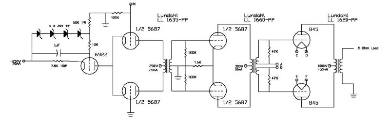

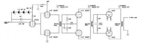

I’ve been fallowing your thread and thought you might like to see my take on a 845 PP amp.

Very nice. If I could ask, first of many questions probably, is it necessary or desirable to have separate filament transformers? I am planning to order these today or tomorrow and I still haven't decided whether one bigger one would do?
Where did you hide all the iron? Looks very good.
Why did you decide on the LTP phase split instead of using one of your transformers? What impedance are you running the LL1620 at? Is it really 50mA/pair of 845?
Many more questions floating around, but I will stop here for now.

Michael,
Well, I used separate windings for the filaments because I wanted to have place to check the tube bias. I found a great transformer from Plitron it was originally designed for a parallel 300B stereo amp. Using one transformer for a mono amp left lots of winding options for the amp.
All the interstage transformers are on a sub chassis supported in the corners.
The 845’s are running at 60ma each tube. I started out more conservative but ended cranking up the bias to 120 ma.
As for the 1620 I have it set for 6K at 8 ohms. This seems to work well with my Quad 63’s.
Chuck

Some questions, doesnt uncoupling the 845 filaments like
you did kill the common mode rejection of the output stage?
i.e. any noise currents on the filament and bias supplies
would be nulled out in the transformer since they are
common to each phase.
I'd also expect that you could use AC with these filaments
too, since its PP. Did you try that? My guess guess is that
a 10V 10A filament tranny would require some research to
buy the right model... For one, something that big would be
prone to mechanical hum.
Thats a hell of an amp though. Loads of power available.
Pretty much drive anything
-- Jim.

Jim,
Thanks,
Using a split supply, the filaments are sitting only 120 ohms apart and besides giving me a nice point to check the bias it also offers a little degenerative feedback that helps the linerize the output stage.
As for noise this amp is dead silent it has a very quiet noise floor.
Chuck

Chuck,
Did you try it with AC filaments? I was hoping they would be OK.
Did you try the 1620 in the 11.5k configuration? When I model the 845 in SEAmpCad, there is a significant increase in 3rd harmonic if a 3k transformer is used as opposed to a 6k. I can see where the added power headroom of the 6k hookup would be nice, but it seems at 1kV that you run out of AC headroom just south of 60W anyway. I am planning to try it both ways on the breadboard, but war stories are a good thing.

Michael,
I didn’t try the filaments on AC, I’m sure I could give it a try one of these days. It sure would cut some of the heat inside the chassis from the rectifiers.
As for the plate load, I did try it at 11.5K I found that the base was very loose and uncontrolled. It was much better with the 6K load. The next thing I’m thinking about doing to the amp later this year is try a shunt reg. across the -250 V supply. I think this could help the base. Then I could try the 11.5k again?
The Plitron is great, all the windings I needed and it still runs only moderately warm at 750 VA. Oh yea it looks cool too.
Chuck

Chuck,
What is your bias voltage, about -145? I wonder if you could use something like a 50 ohm resistor on the CT of the filament transformer with 10 ohm running from the top of that to each 845 to get bias reading points and just a touch of cathode bias if AC heaters were used? I did a search on bias metering and didn't turn up much, so I think I will try to start a thread on the subject.
Back to the phase splitting, what advantages do you see from splitting electronically vs with an interstage? Just wondering, since the iron was there anyway.

Michael,
I did a differential input to give me more gain.
Yep the bias is around -145V.
You could just bypass the rectifier and remove the filter caps in my circuit and still have the bias test point. Or you could use the center tap with a 10ohm resistor to ground for the test points. I’m not sure it would make any sonic differences, but it might help get some heat out of the chassis.
I think the biggest potential sonic improvement is in regulating the neg bias supply. This is something I have wanted to do since I built the amps. I figured I would use a mos-fet shunt and maybe replace the 2K dropping resistor with a current source. I have found that zener regulated mos-fets make great simple regulators in high voltage applications.

Chuck
Nice amp!!!
Just one question, if the amp is built as shown in your schematics your 845 cathodes are not 120 ohms apart. They are tied together by the 4 by pass caps, right? Not that it makes much of a difference, the stage is still very linear at normal output power.
