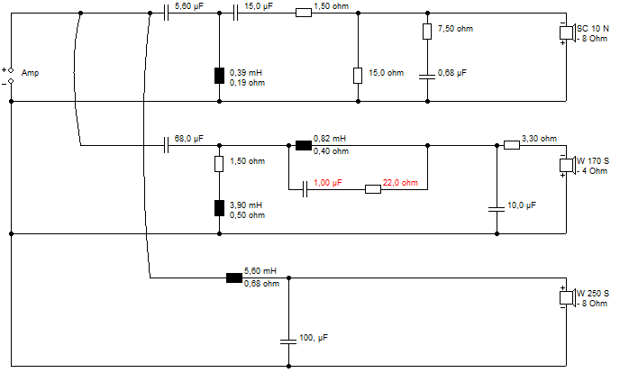

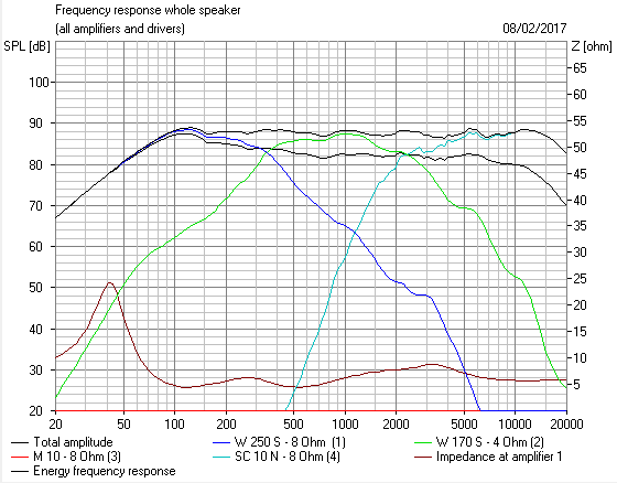

I've tried to explain it. Your worst issue appears to be a gutless tweeter. The woofer breakup isn't too bad, being mostly at 3kHz. I don't know what Madisound came up with for a crossover, but trust me on this, you need a 2.5kHz crossover into a robust tweeter. Otherwise you get 5kHz cone breakup from the 6" paper mid too, and it is best to take that down 6dB with a notch anyway. Which is the 22R + 1uF here across 0.82mH here.
TBH, we are being very exacting here. Most people would be pleased enough with the sound. Have a look at your Madisound schematic. If it is wildly different from this, that is where work is needed. Tweeter? Well, the circuit I did would roughly work with a H1212-06 27TBFC/G.

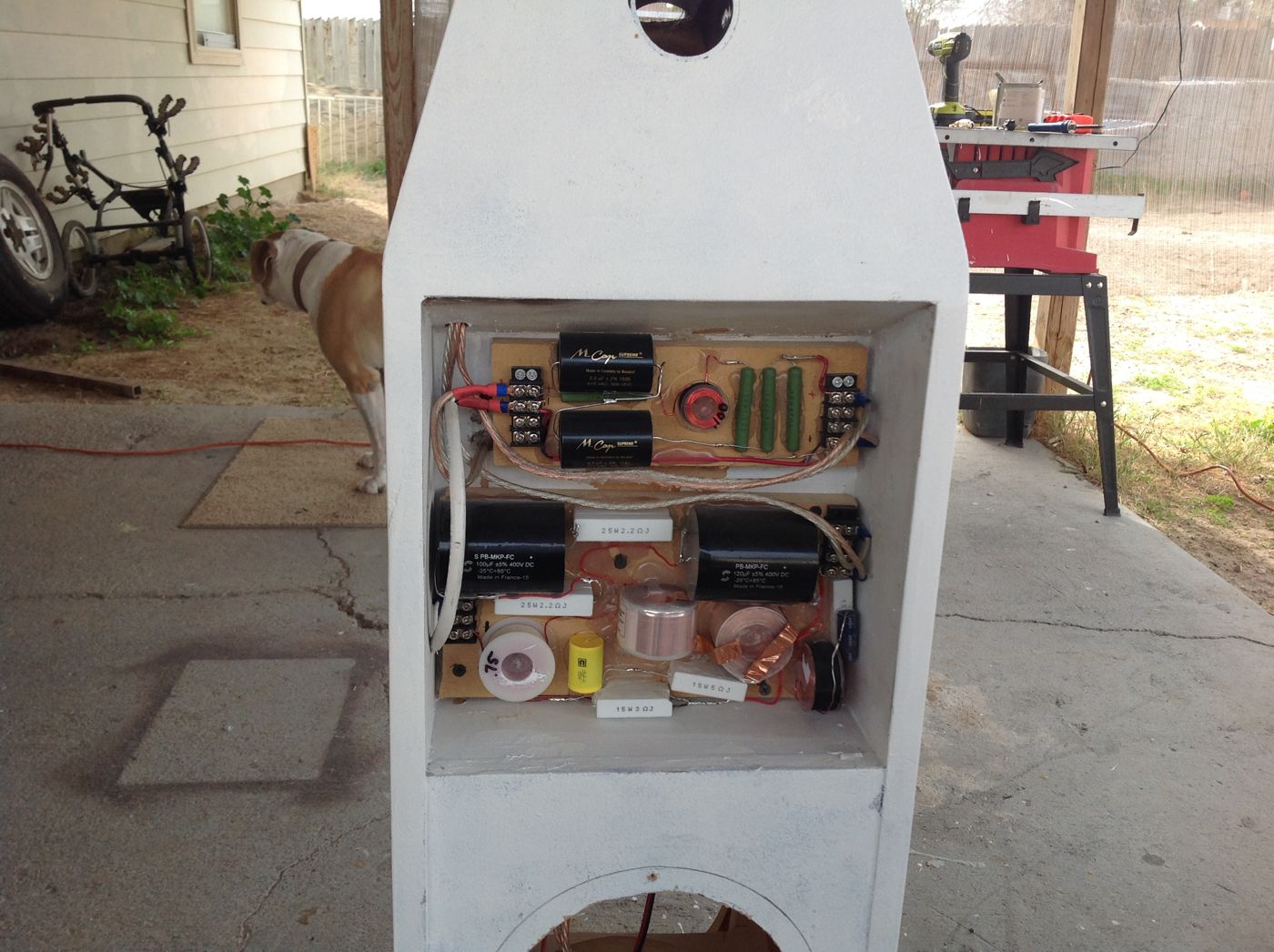

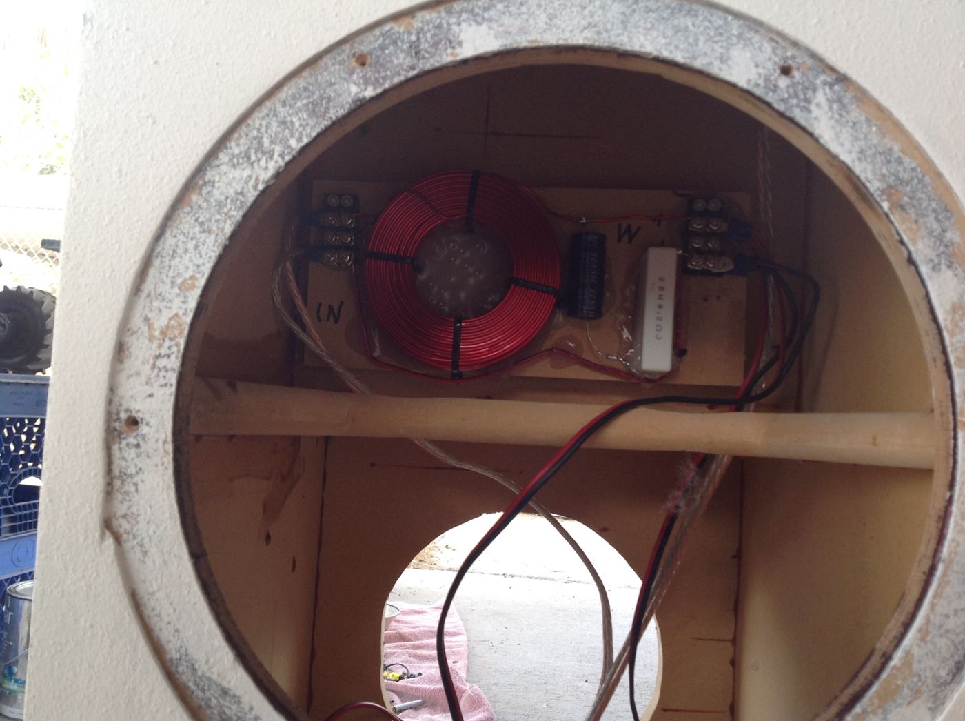

7, is that a simulation using my drivers? I printed it out to save regardless. The pics that were posted show the Madisound crossover, the upper portion is for the tweeter, the lower is the mid, with the 2 big black caps. The darker pic shows the bass circuit. It's a crapload of parts.
When I get back to these, it's going t be a few weeks. I'll start a new thread because I'll have my laptop back and can post pics myself showing details of everything including all the leap stuff. Maybe we can dissect it and it will help me understand.

In case there will be any interest, I can simulate the entire XO filter with your drivers as a separate theoretical solution or as a modification of your leap/madisound,Troels' or a combination of parts you have at disposal. This is the next best thing after real measurements.
Hmm... this isn't easy... :eek:
Now we might be looking for something like this:
The bass filter is simplistic enough, just an added resistor for phase.
The mid filter has a LOT of parts, so might be third order.
The tweeter filter has an 0.1mH coil, so ought to be a 4 ohm filter. The Caps look quite high value, so it might cross quite low, but I really can't conclude much.
