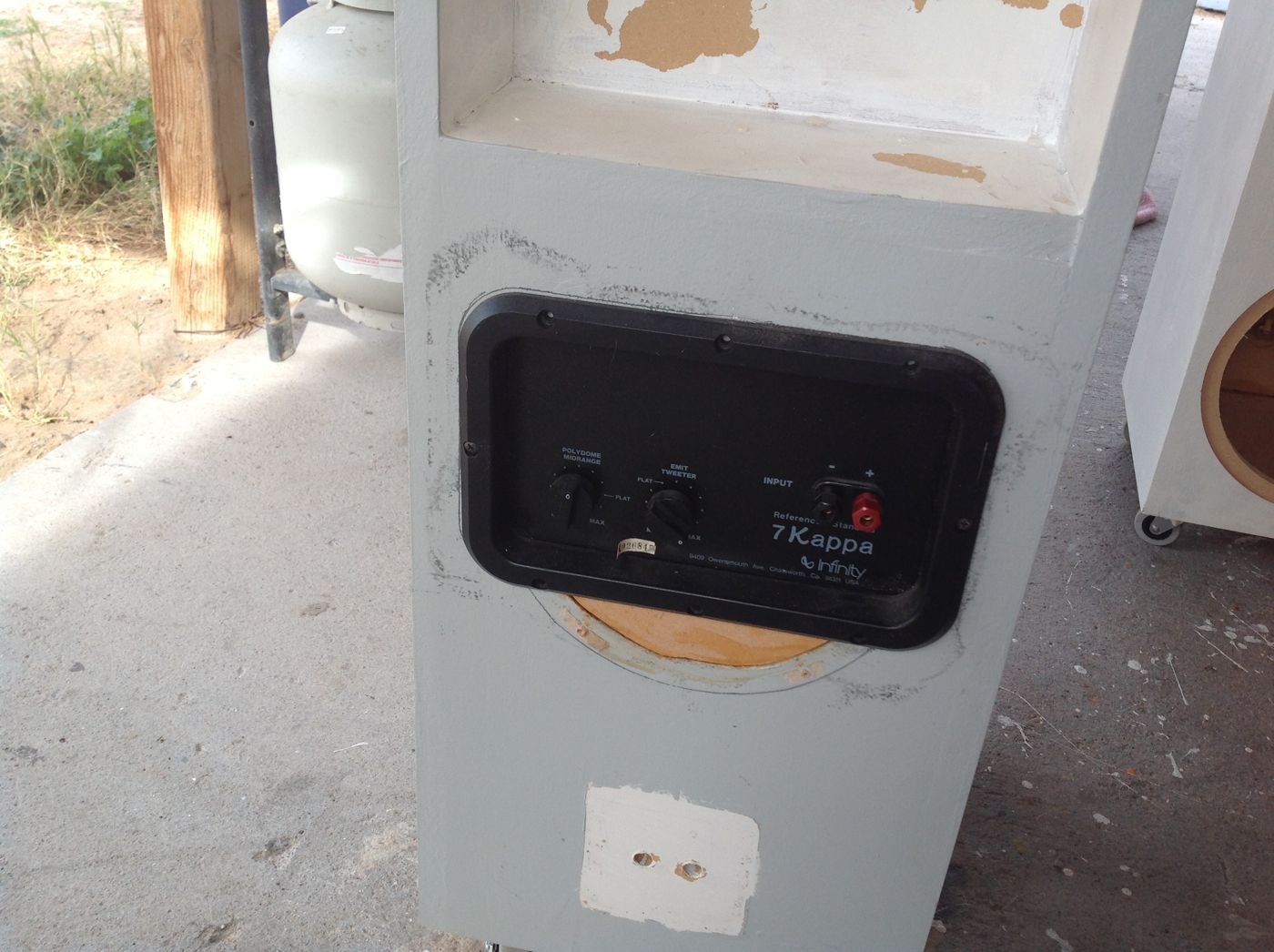

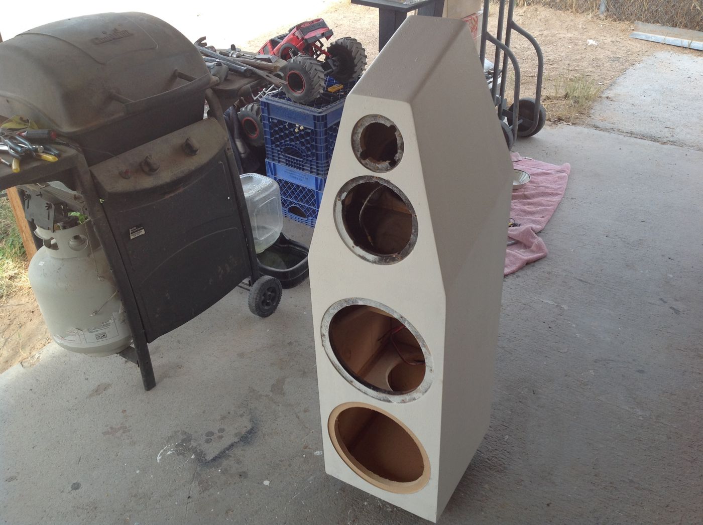

Sorry, I was away for a bit.

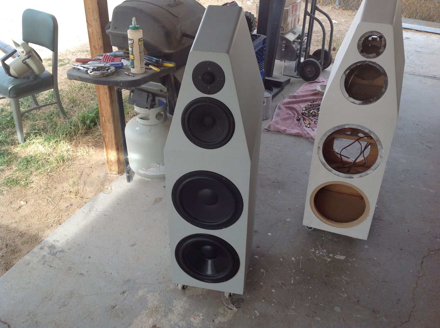

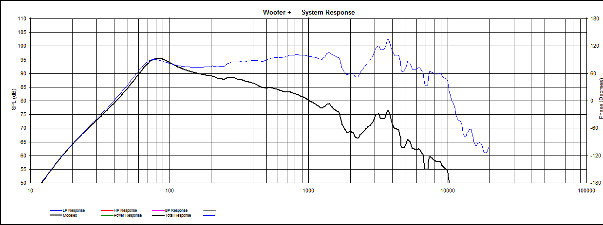

A major mistake is the small cabinet volume of 55 litres for the two woofers. Each has a VAS of 150 lit, so if one is to expect a good LF performance, then there shoud be available about 150-200 or more. That the woofers are 8 ohm is good. Small cabinet volume pushes the Fs of driver in a box rather high and this makes the usual LP woofer filter react in a way that the FR rises and the bass is even more down by looking at the new reference SPL.

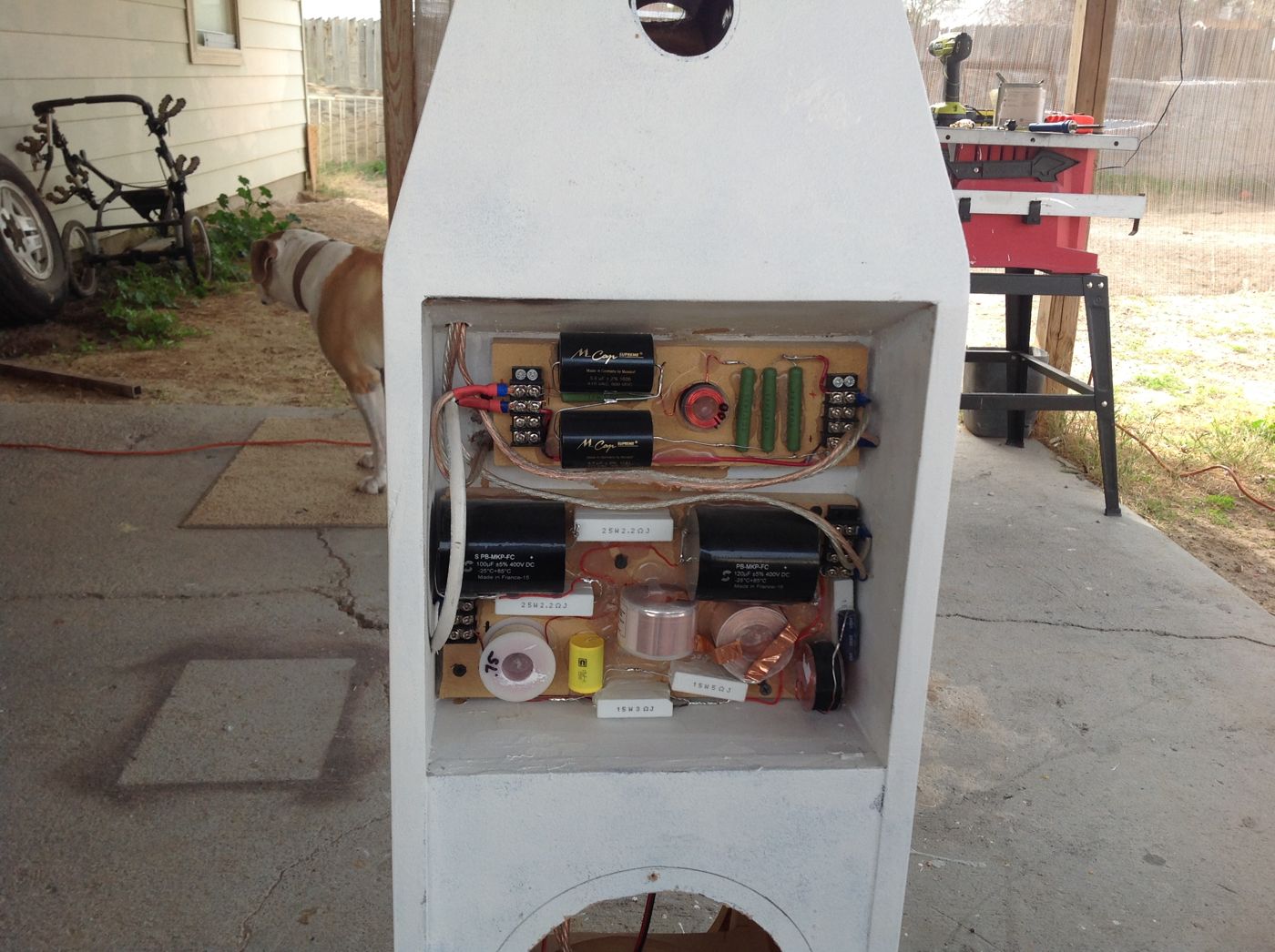

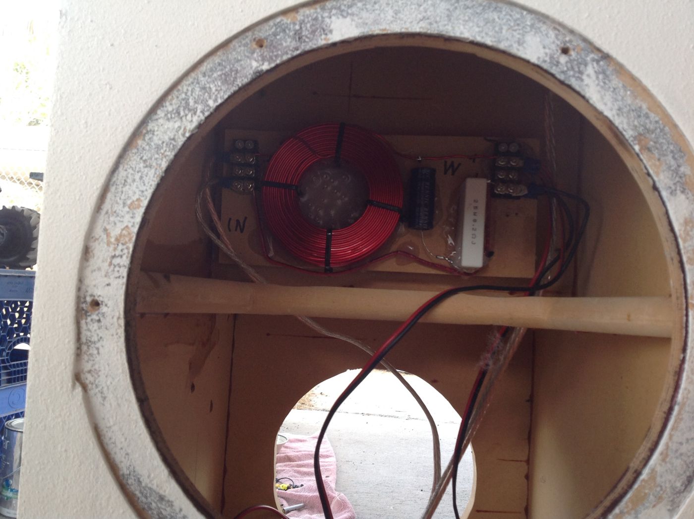

Whenever you make a new design, never ever buy the expensive filter parts, not until it's perfected enough to be worthy of it.
Step One: Learn hos to measure drivers. The only thing active will do for you is make it unnecessary to worry about the driver impedance data. But if you can not get reliable, accurate SPL data it won't matter if the crossover is active or passive.
This!! When I first started in this hobby in the 90's it was really expensive to have measurement equipment, but now it's cheap. I really think it should be the first thing you should do if you take audio seriously.

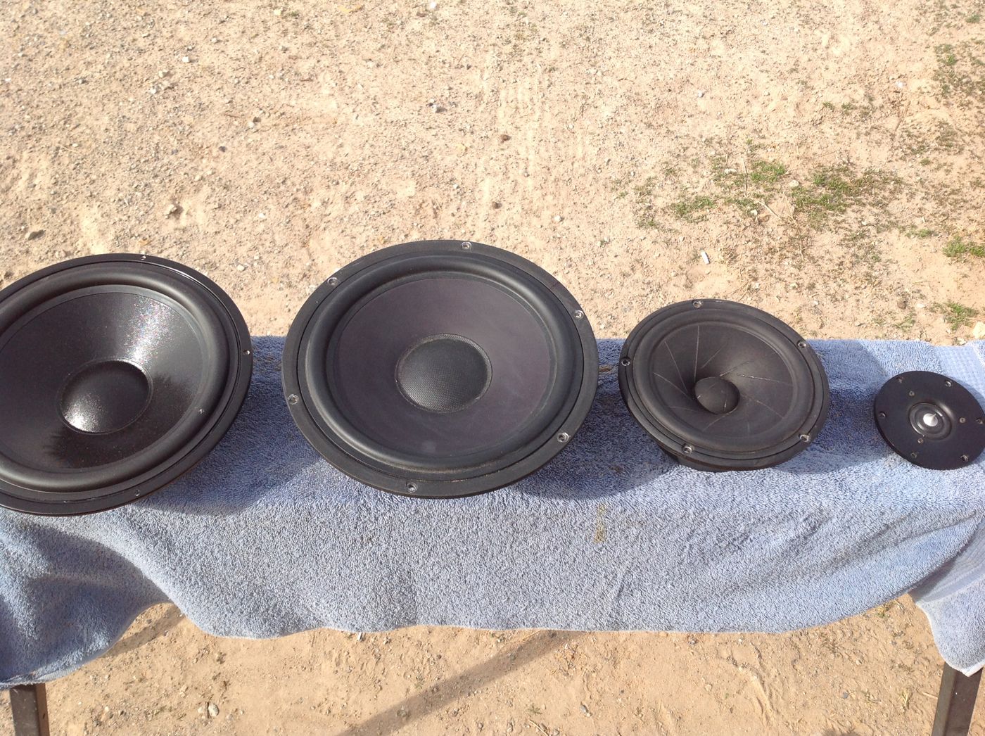

Scanspeak
R2904-700000 tweeter-4
18W/4531G00 midrange-4
26W/8534G00-8
Cabinet
Lower bass 55 liter
Upper tweeter/midbass 21 liter.
All a complete muddle, IMO. But 55L ought to work for a 10" bass. The ABR is a bit desperate, isn't it? 21L seems a lot for a 6" mid too. :D
That doesn't actually look like the R2904-7000 to me. More like a soft dome. But whatever. :confused:

Your first mistake was getting a 6" 4 ohm midrange, which will cause some severe low impedance issues. Your second mistake was getting a ring radiator, which really needs to be crossed at 3.5kHz, IMO.
One of them has gotta go. :cool:

Yeah, the 18W/4531 IS an odd choice in a 3-way, I am listening to a pair of them right now. :D :D
On the other hand, it IS a pretty awesome mid-woofer. It is ideal for 2-ways if you can give it the cabinet volume it needs.
Perhaps it's size will help transparency by controlling the radiation pattern.
A slight negative is it has a little more distortion at the top of it's usable range. A smaller mid would have avoided this altogether.

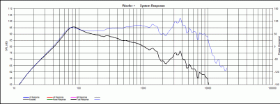

Ok, while awaiting additional data, I took a shot at guessing what has happened to the woofer response and with a little bit of imagination it is probably not very far from the truth. Simulated is 2 SS 26W 8534G00 in parallel, Vb=55 lit vented and a LP filter.

Beautiful cabs!
Individually great drivers, altho a slightly odd combo. I have the 26W and also messed my project up.. not the drivers fault at all. It works best sealed but a PR is a neat idea to reduce cab volume (needs a massive box ported)
I'd have placed the bass driver at the bottom to keep 2pi(for better sensitivity) and PR at the back (which you cd still do perhaps)
